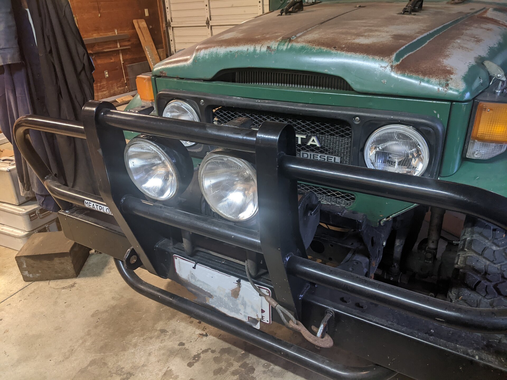

Got this cheap from the guy I bought my mill from.
I wanted a disconnect for the winch, so I grabbed a blue sea switch. 2-5/16 hole. Because I guess **** you that's why 🙄
For when your s***ty old hole saw isn't quite big enough. :hillbilly:
This this is actually for sailboat rigging, but it does a pretty good job crimping battery lugs.
I was a little paranoid about chafe where the cable goes into the battery box, so outside of the plastic split loom , I cut a piece of tin, wrapped it with tape, then wrapped it about the loom. Should take a while to wear through that.
Luggage.
Done aside from vacuuming up all this s***.
Winch sounds a lot perkier now. I'm sure it has to be better, I cut about 5' out of the run and probably doubled the wire size.
One other minor thing...a holder upper for the battery box lid. Because my skull has enough dents in it.
Figured it could double as a leash anchor point if the mutts ever come with.
You will never know how annoying not having this has been for the last 3 years 🤣
