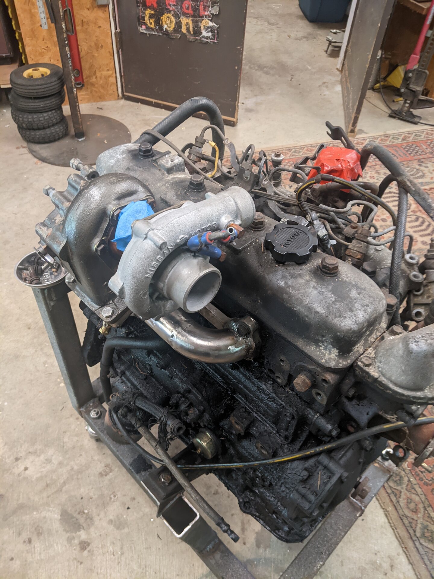

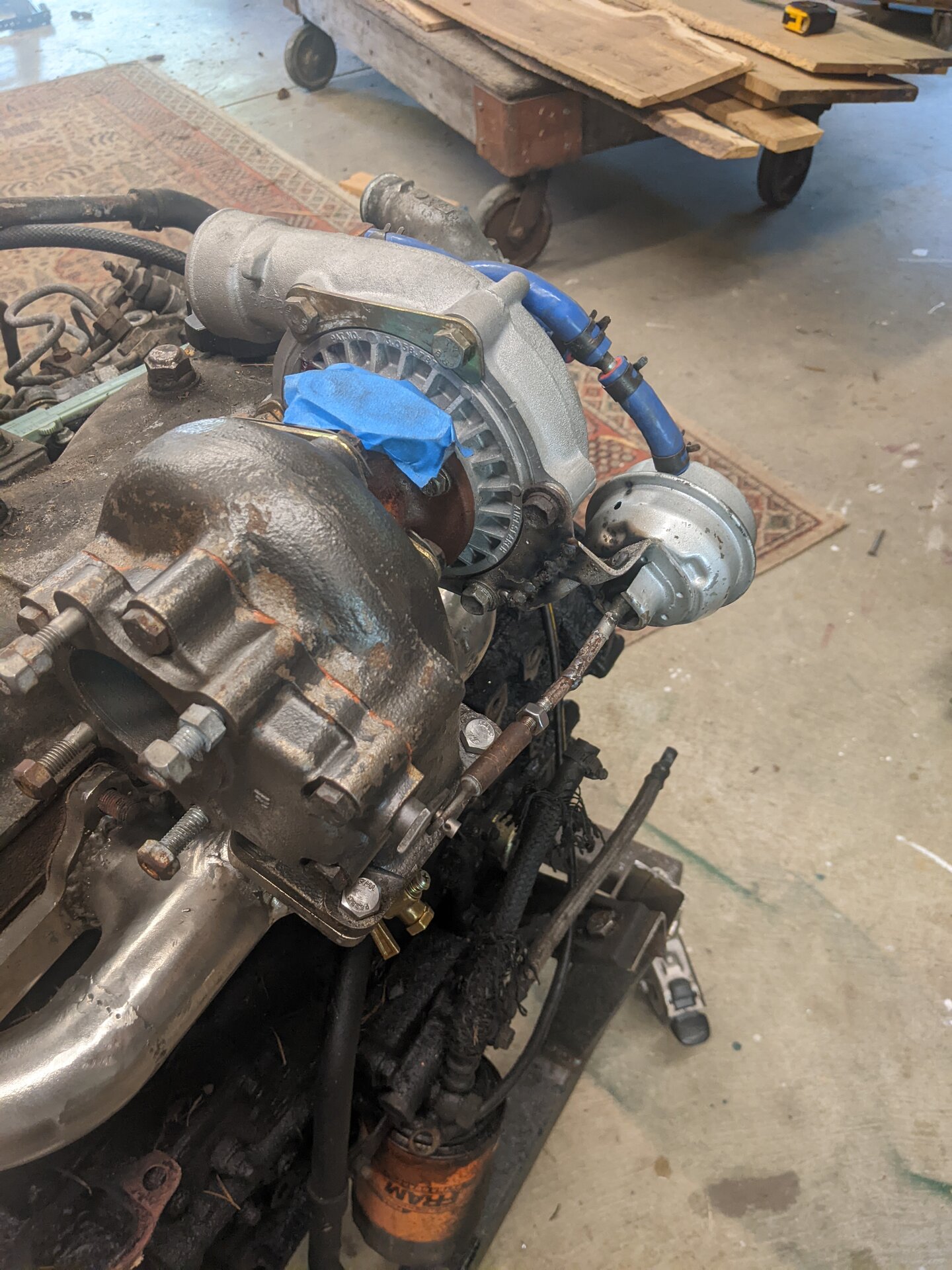

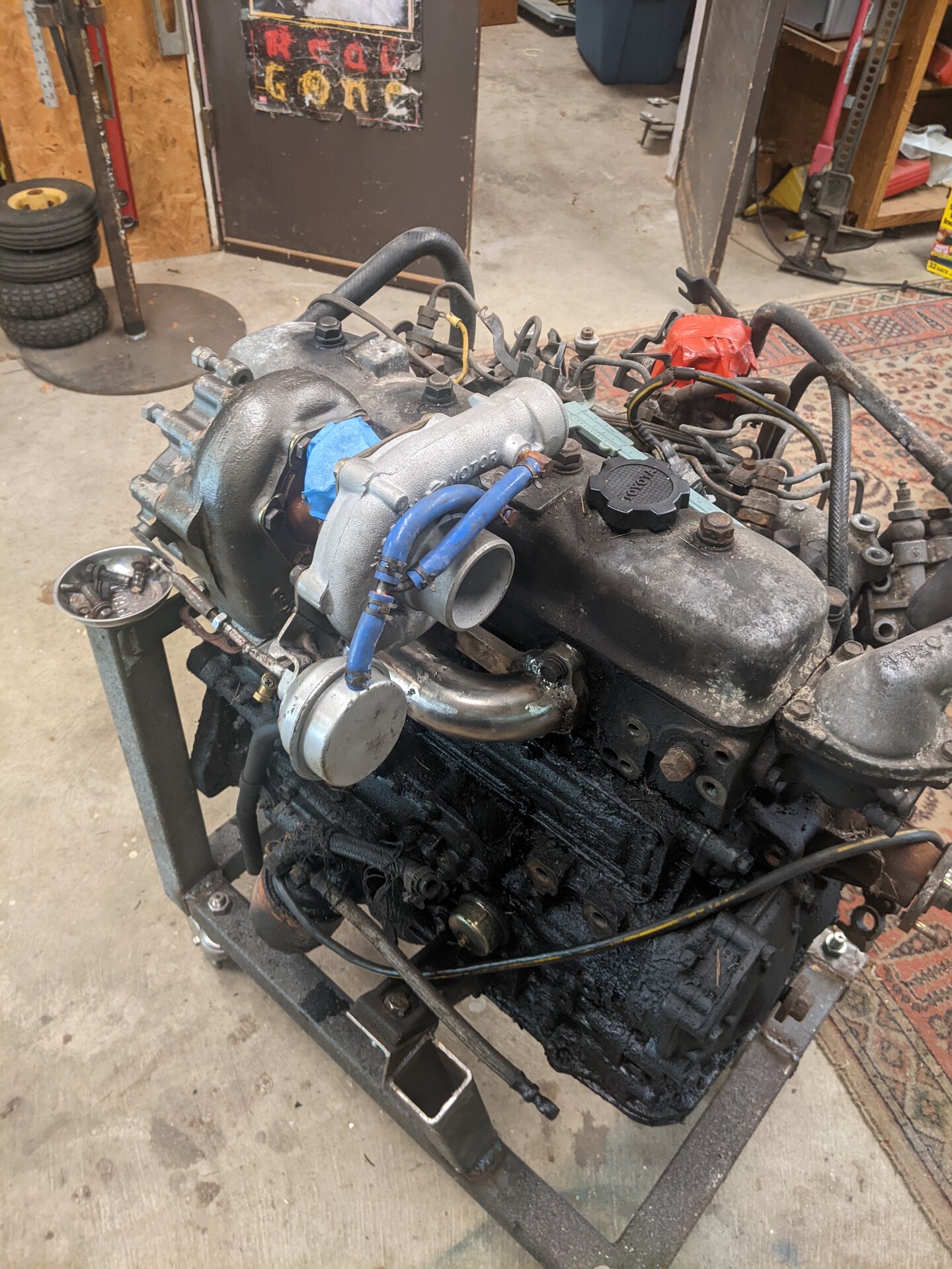

Anyways, got the manifold pretty much done. I still want to give it a squeeze to see if I have any pinholes, but that can wait.
Dug out old stank as a test fit stand.
Wastegate actuator bracket was a marvel of being wrong in every possible direction.
Exhaust flange and that s***ty first elbow are next.
Shiney manifold, douchey blue silicone hose...I just put extra curve in my hat brim to compensate.🤣
Nice work man.
old stank" Haha, love it; so perfect.
I'd just scrap the waste gate actuator altogether if it was a PITA. Mine's disconnected; but maybe at some point exhaust manifold pressure overcomes the spring and it opens anyhow? :meh: Not enough fuel into my motor to get beyond about 18psi; which is a nice maximum anyhow.

18 is a bit more than I want to go, this isn't one of those modern sportscoupe engines :lol:
I'm thinking just 10-12 or so, but we'll see how hard the mibs hits once its in... I only have ONE spare 3b lol
I haywired a tire inflator with a gauge on the line and it starts flapping around 5 ish near as I can tell.
Which is close enough for the initial test runs, I'll turn it up more after I see where it's really at.
Went out and ordered a couple bspt to npt adapters and realized I should really just buy a die. Seems to happen every 5 years or so I need one.
Having a Gregg's nearby is pretty damn nice.
Also bought a couple weld elbows and realized when I got them home they wouldn't work at all, so, I get to make some stock boy happy when I pick up the adapters next week.
Means this is about as far I I'll get today. I was dreading grinding this thing out, but I remembered I have a semi functional plasma cutter :lol:
The hole is offset between the studs, which made it a pain in the girly parts.
Anyways, I'll have more bits and pieces to zap together next week. I'm hoping I can get this so I cut off the old exhaust and connect it to the new one with a coupler, without much fuss but that probably won't work out like I hope. I'm expecting fuss lol.

conditions.
Normal oil temperature is 95+/-5°C (203+/-9°F). It should not exceed 120°C (248°F) under any operating condition.
11. Oil return pipes are permitted to decline at an overall angle of not less than 30 degrees below horizontal.
15. Recommended oil flows for the turbochargers are 2 litre/min at idle and 3 litre/min above maximum torque speed.
Tldr, 2 Lpm at idle. 🤣
Found a couple other sites where 2 Lpm at idle is mentioned, and one where the test is to put oil feed line into a jug and idle engine for 15 seconds.
I'll do that before I bolt on the turbo...once turbo is on it'd be better to pull the drain off but that could get messy.
I guess if I get a s***load more than 2 Lpm out of it, I'll restrict it, but I'm thinking it'll be no restriction, and don't skimp on the drain.
Kinda curious now.
