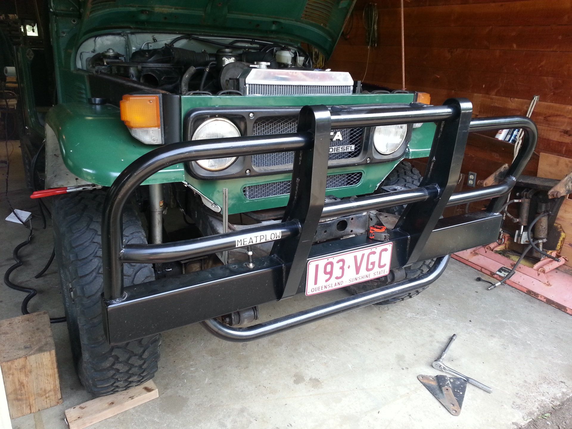

Haha yeah its pretty cool. Some bumpers are made for looks , this one is made for roadkill.
Even had delivery included by the silver fox himself :lol:
Just pegged on there for now. Plan is to cram it as close to the bib as I can with the winch in there.
Should be quite a bit closer than it would be on a 40 frame.
