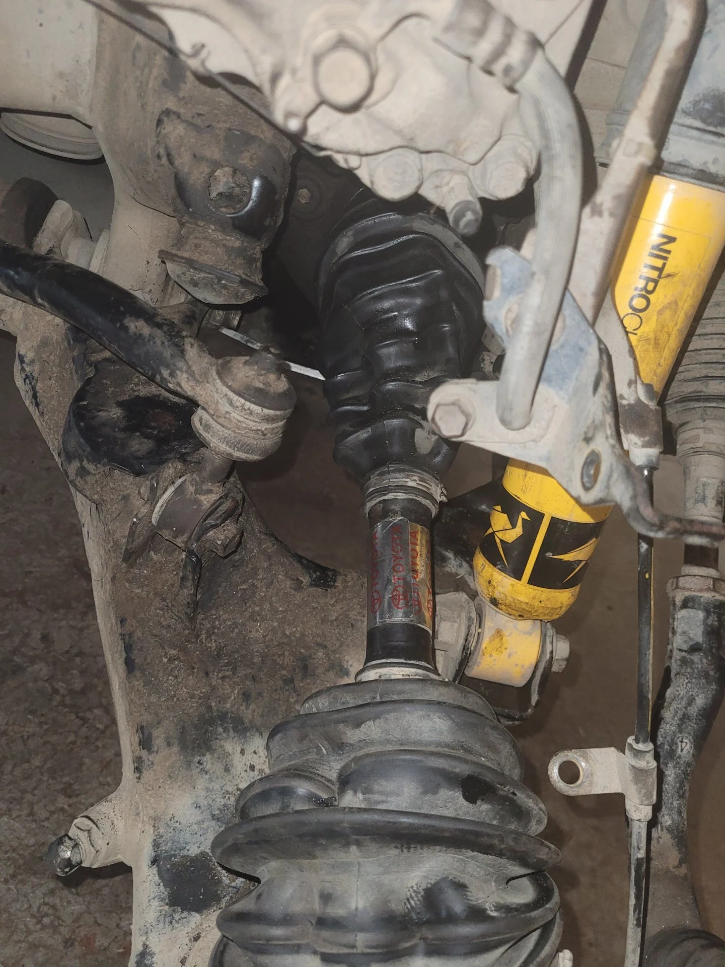

I was leaking gear oil out of the passenger side diff, so I went in to replace the diff seal. I followed the advice of "chowcares" on YouTube in the following video . For a number of reasons, I should not have followed this advice. Yanking it out by the knuckle from what I experienced is a bad way to remove the diff side of the CV. For me, this resulted in the CV axle disconnecting itself by the diff side, with the bearing assembly slipping by the larger ring in the tulip (pic below).

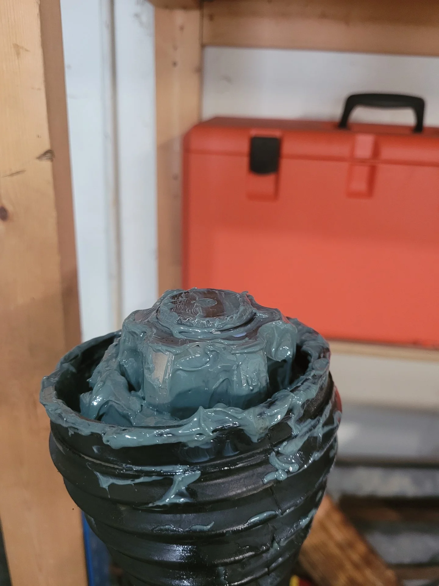

Lesson learned on that one. I then removed the whole axle and being unable to get it to go back. I tried sledging it with wood blocks but ultimately took the diff side boot off, removing bearings, taking out ring, putting the bearing assembly back in, putting the ring back over and securing the boot clamp. Unfortunately, while reinstalling, for whatever reason it disconnected again. Then the boot slipped off and all the bearings fell on the floor. Least to say I was enfuriated lol.
Since that axle was f'd I put in an old one that leaks some grease that I keep around as a trail spare. But this leads me to what is best to replace it with.
The CV axles I used were the "reman" ones from the dealership. I've looked around and realized that it seemed like the "reman" thing was a bit of a lie and they're not "OEM". However, I'm not sure if this has changed since some of those posts? When I put my axles (still have the old OEM ones) side by side, I cannot tell the difference. I suppose the boots could be different and that may be harder to tell. But the "reman" ones still have the six bearings (pic of boot off below) that I belive previous posts said they did not. Does anyone know if Toyota changed this and the remans are actually "OEM" now? I could be missing something.
If something changed, it seems like they might not be as bad of an option considering the cost difference. But I get why people like new OEM. The 3rd option to me it seems is CVJ, but I've seen a few posts on here that the quality is not as good. Has anyone had an experience with them lately? I live in AK, to have things shipped here and send the cores back is expensive. Whatever I get, I'd rather it be the best for wheeling, which still seems like OEM. But I'm not sure if anyone has had any differing experiences as of late.

For sure. There were definitely a few wack things about that video lol. I just did it the way I did it the first time after this, driving a wedge along inside of the CV by the diff, get it out a bit and then tap out with a hammer and pry bar.

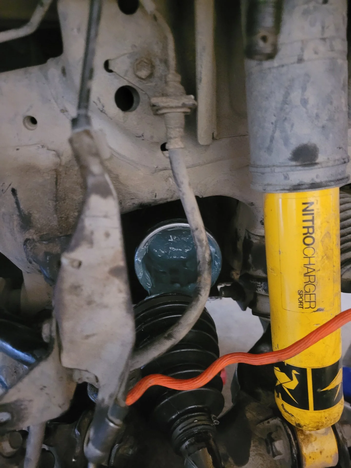

Similar thing happened to me on my third try getting the driver's side axle seal to take and not leak diff gear oil. When this happened to me, the c-shaped inner seal was buggered up when it popped out of the tulip. I replaced that with a new one and some new bands for the cv boots and it's been fine every since. I would inspect the tulip and see if the c-shaped inner seal is still there or not, and replace it with a new one.
That's my best guess of what happened. I put the inner seal back in the correct spot after disconnecting it, but maybe I ruined the seal. I'll try ordering a new one and some bands. I can't really imagine what else could've gotten ruined that it would just disconnect a second time like that? I think the only thing holding the bearings in place is that c shaped ring?

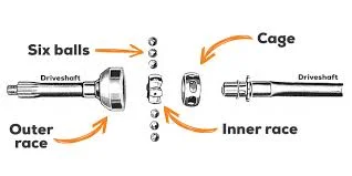

Do you know if the remans changed at all though? Looking at my remans, I thought they should've had the 3 bearing set up and not the six if they were the rebranded Cardone's?

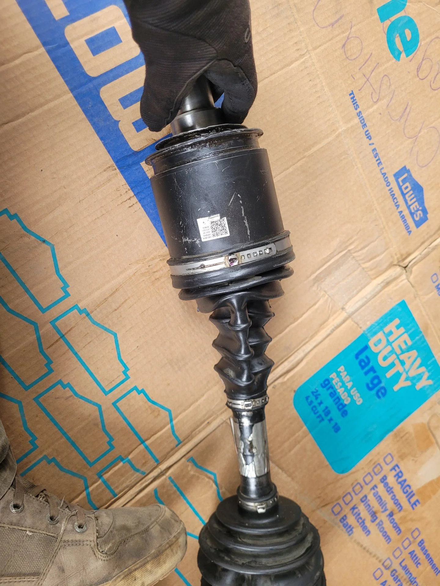

3.) You opened your cv axle and saw a Rzeppa type CV axle - its design isnt specific or proprietary to Toyota- (not all components contained in a Rzeppa joint are the same quality however)

My understanding was that the Cardone axles don't have the rzeppa joint? I'll have to take a closer look at mine. Dealer also offered a core charge for mine but I decided not to return the old axles.
I think the "value" line mentioned in that thread are not the same thing as "reman". The reman ones I bought were $275 a piece. Those "value" ones a few years ago were about half that. Inflation is bad but I don't think it's doubled the price of cv axles since 2020. Probably something they tried then and have moved on now.
