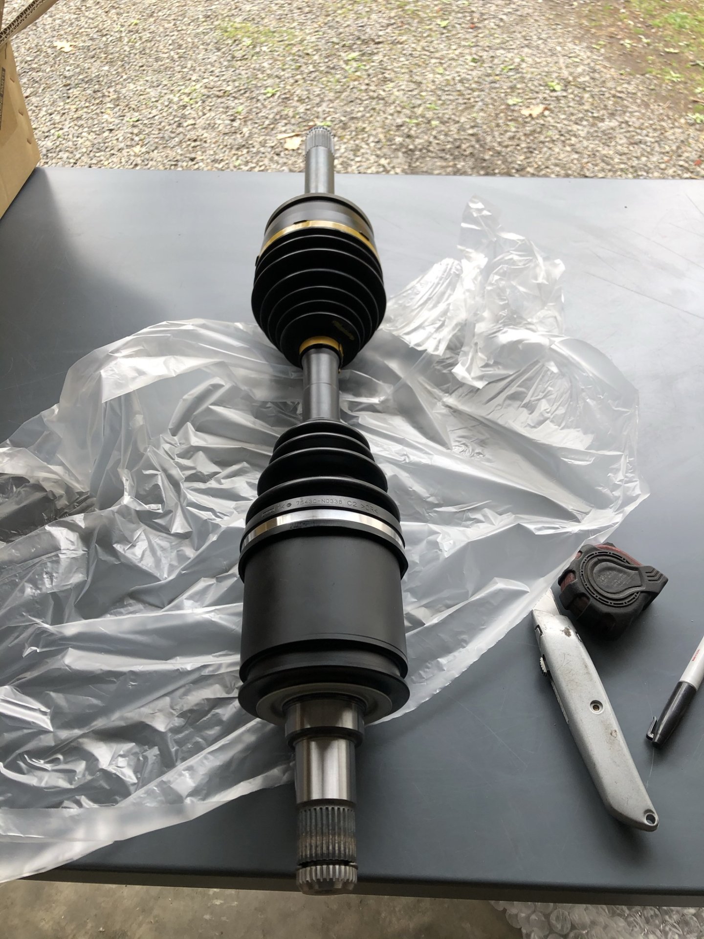

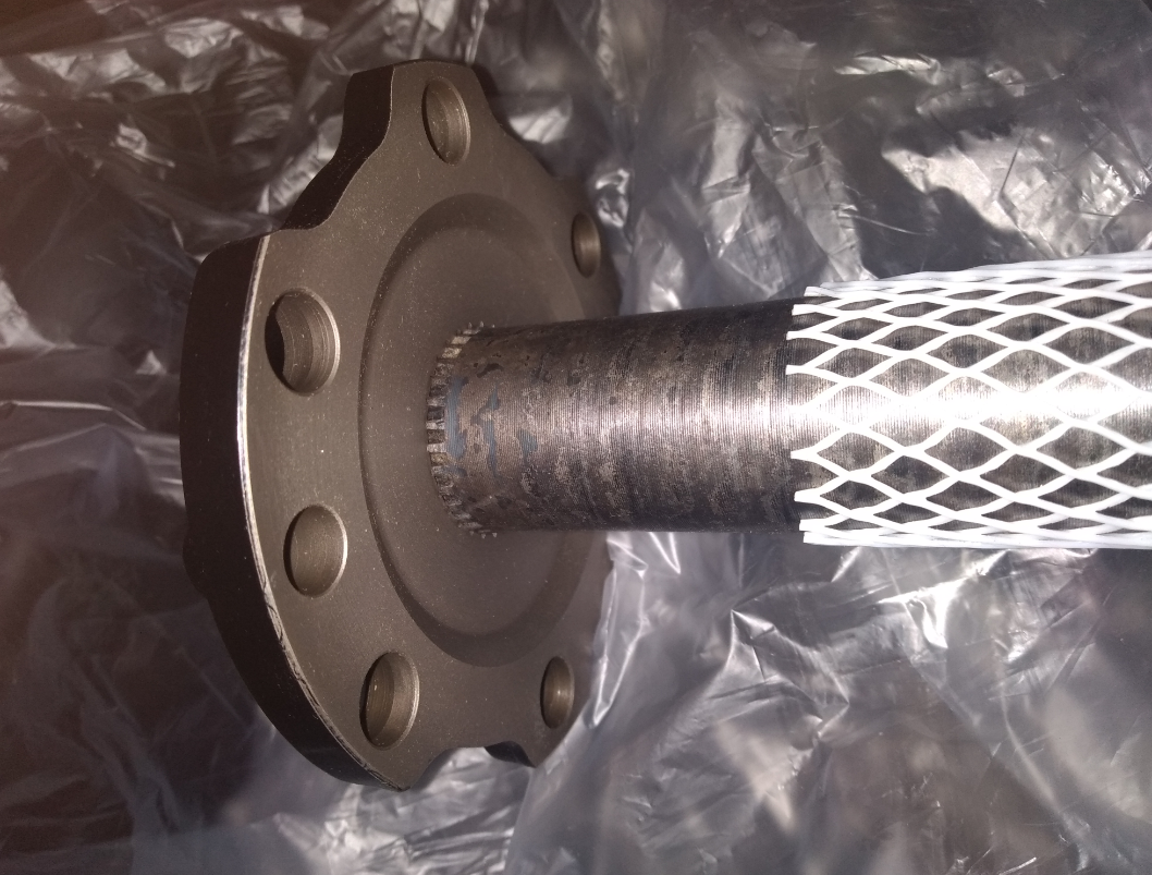

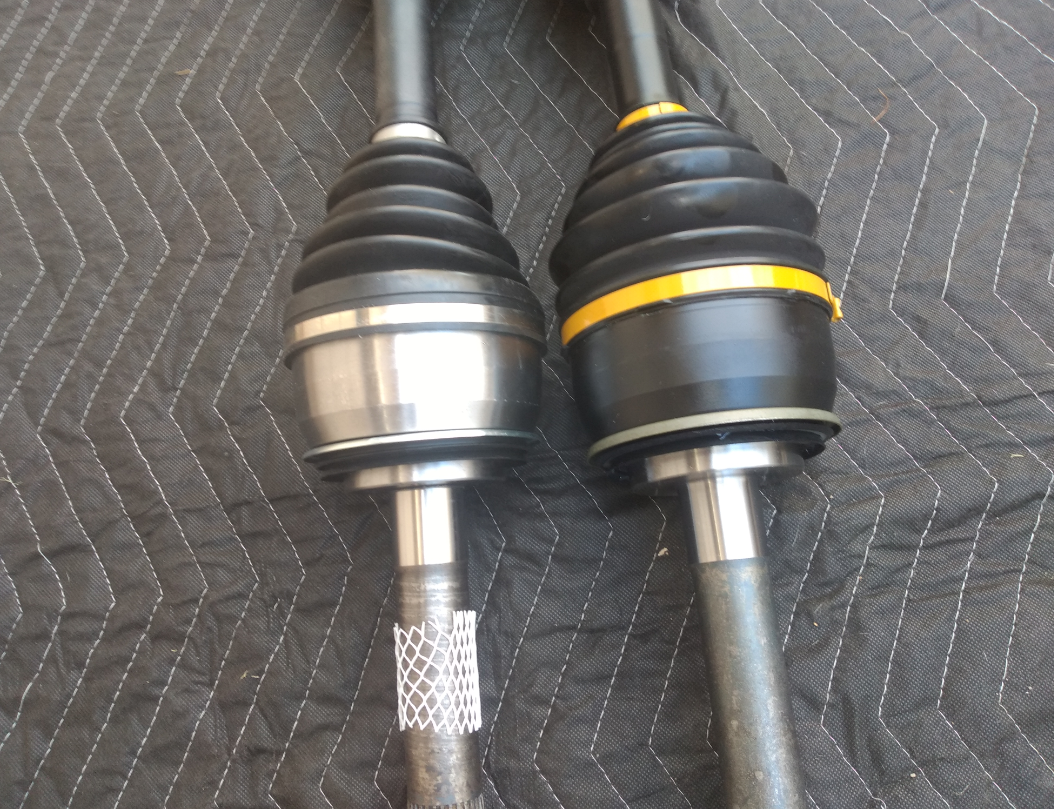

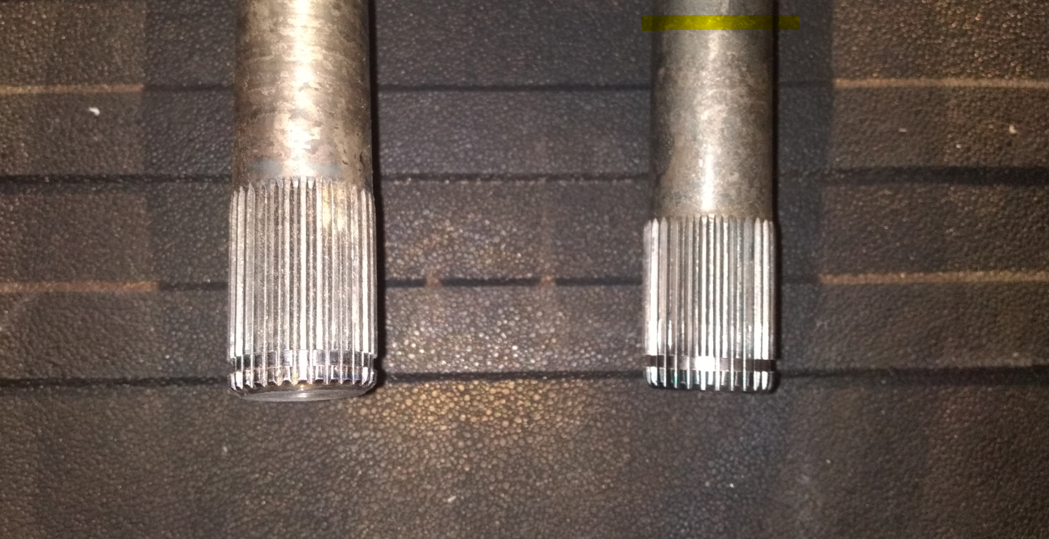

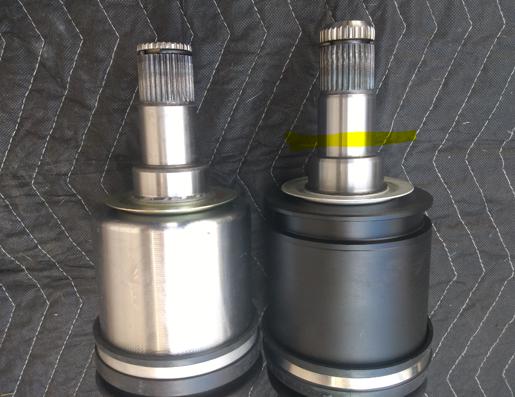

I did a side-by-side comparison between OEM and an axle made by W0hn industries in China. W0hn supplies many of the aftermarket brands. There are subtle differences.
In the 2nd picture the splines on an OEM have a slightly different cut.
An observation that I've had with both OEM axles is the groove cut for the snap ring is a precision fit for the "D" size snap ring. I verified the snap ring width with the new axles before installation.
OEM on the right in this picture.
OEM on the right.
OEM on the right.
With a new OEM flange, CV axle, and D size snap ring everything came out as a perfect fit.
The spline cut on this aftermarket doesn't have the same precision feel as OEM. It feels like it needs to be forced on.

I noticed the same when comparing a Cardone and OEM outboard shaft. I think Toyota truly cuts the splines in their axle shafts whereas the manufacturers of aftermarket axles use cold-form rolling to make the splines. Cutting actually removes material whereas rolling just displaces the material.
CAVEAT: I’m not a mech engineer, so my above conclusions may be wrong.
I concur. There is something different about the way these OEM parts all fit together. It's like putting together a fine instrument.
Clearly they ARE different. Horrible idea to try and force splines. That’s so much worse than boots ripping prematurely.
