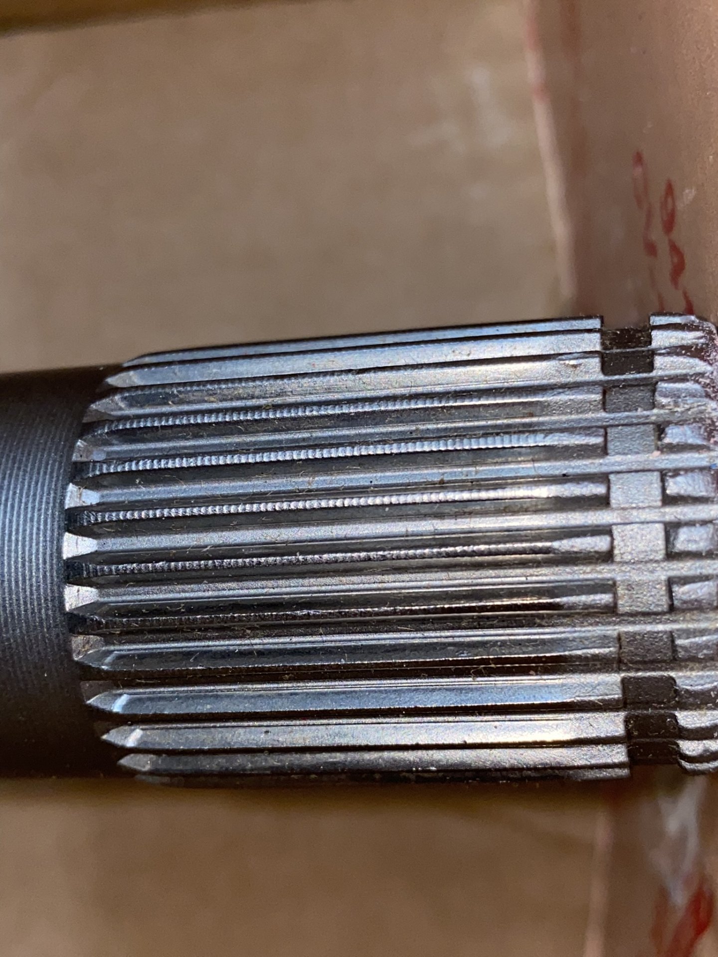

I looked at a set of Toyota FDS ***-*** -84 (-84 on any Toy parts = re-manufactured), at Dealership last week. I was very disappointing. They did not use OEM boots, area/axle race knuckle seal rides on was painted, snap ring groove slightly rounded. Worst of all, outer CV axle splines were ~30% or more worn away.
WOW - Those splines look terrible.
I was hopeful. So disappointing Toyota's not doing these with stick controls. . :frown:
