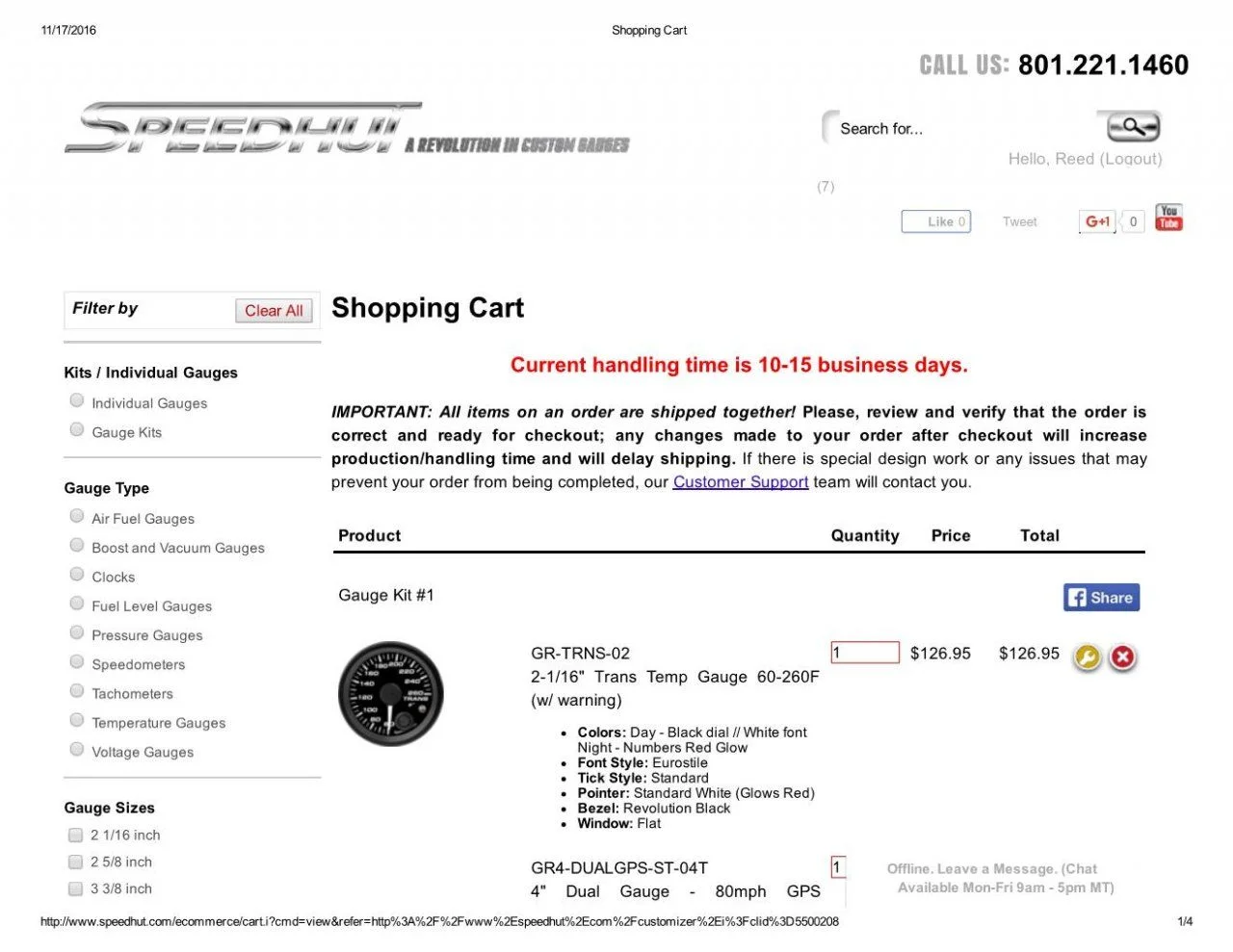

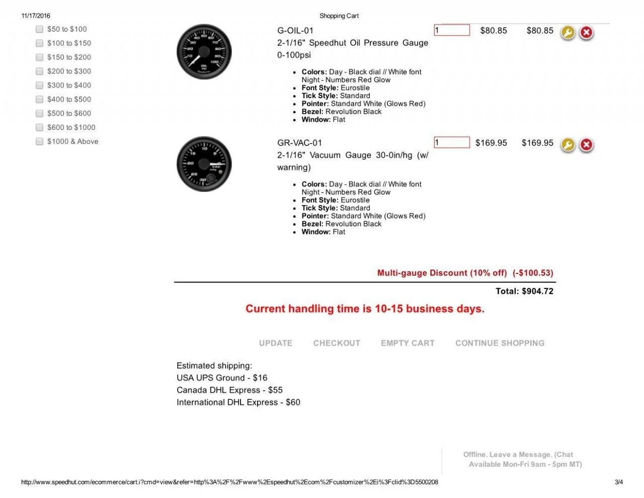

This is what I plan on ordering:
Vacuum, Water Temp, Trans Temp - Speedo/Tach dual - Fuel Level, Volts, Oil Pressure
All from speedhut, I did look at glowshift but I figured I didn't want to have to do this twice so its worth spending the extra money on high quality gauges.

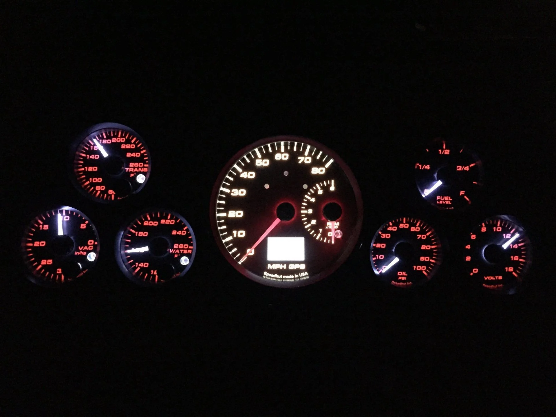

So I built the wiring harness today using OEM connectors. Then I test fired everything.
I'm really happy with the small gauges however I am not thrilled about the colors on the dual gauge in the dark. I was expecting the white in the dial to match the pointers on the small gauges better, and also expected to see the pointer's more red (although it looks pretty red in the photo). Oh well I will call them tomorrow.
Have to agree, the smaller gauges look real good, the dual looks a little 'washed out'. Is there an option to put a 'warmer' bulb or LED in there? I would guess you could get pointers with a deeper red and swap them, unsure how they are constructed, can the bezel be unscrewed?
I know exactly where you are with this, my Discovery had additional gauges from VDO, the needles were a deep orange and the OE dash needles were yellow, my OCD will not tolerate that. I sat there for hours masking the OE dials and spraying the needles different shades of orange to get a match, I managed it eventually but if you are going to look at it day after day it must be right.
