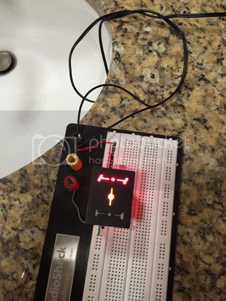

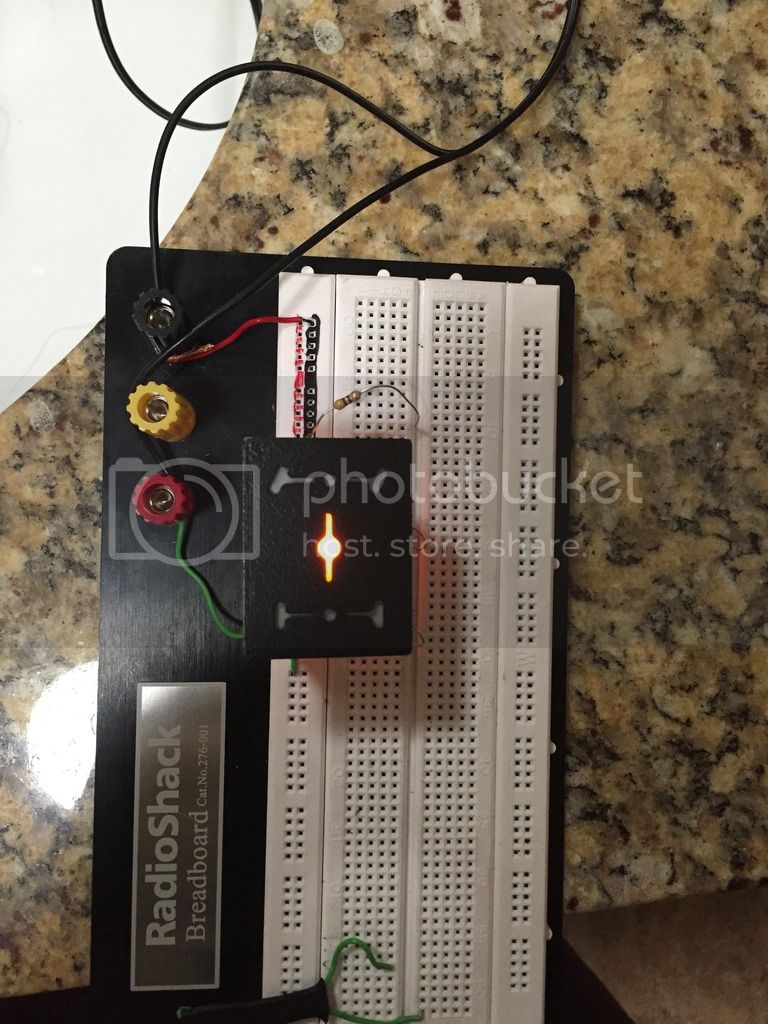

Ok here is my progress.
Took some 3mm LED's and shaved the dome off of them to diffuse them more.
Painted the reflector silver
Testing some LED's (the one at the top is a standard LED, I sanded the top down on the bottom red one, you can see the difference between the two in regards to their dispersion patterns. (Also stuck a white in for testing, it was a 5mm so it won't work, waiting for the 3mm whites). Also the camera really picks up the hot spots but in real life you can't see any hot spots on the bottom pane.

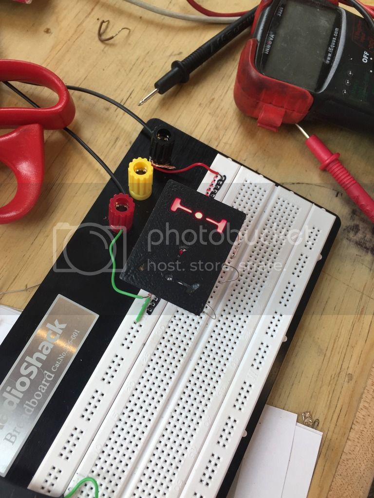

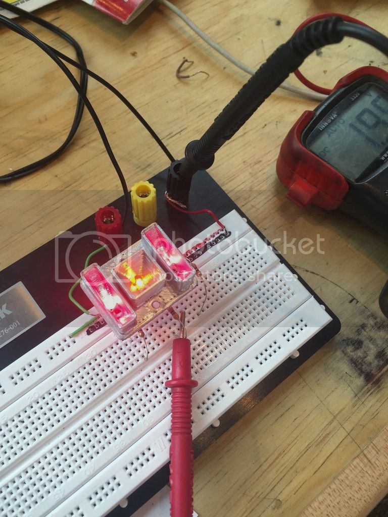

More testing
I got some clear vellum paper from a crafts store to make the translucent windows. I layered two sheets into each box.
