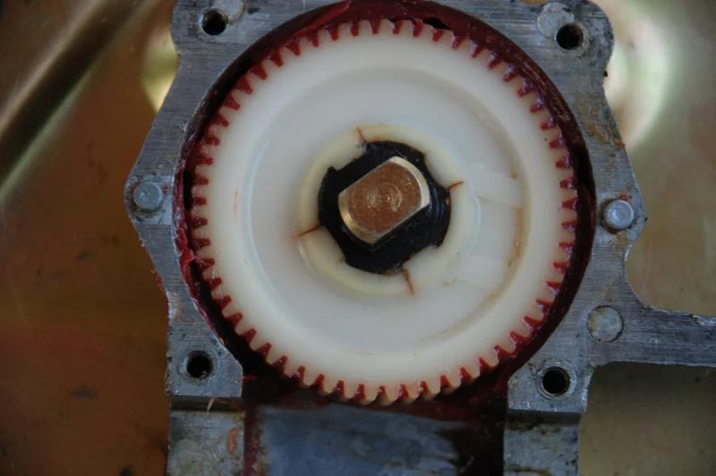

I don't have proof it's a 71, but I have a brass gear from another 71 and it's the same. I'm guessing it's an early style.
You can put me down for one. This is a pic of the one in my 69, which has been updated to a later model according to an earlier post in this thread.
Just a suggestion, but it may be best to have everyone post a photo of the gear they need since there is no guarantee you can match up the gear just by the year of the LC you have.

The badly worn one I removed today looks like the one in the photo in #290 and like the one that scrap daddy sent me. The machinist is going to compare the worn gear with the scrap daddy one, and make sure they are the same diameter, width, tooth count and arbor. If they are, then we are going forward with it. If they are different then we will scratch our heads. I will have to b certain about which gear is needed and which one will work in my regulator!
