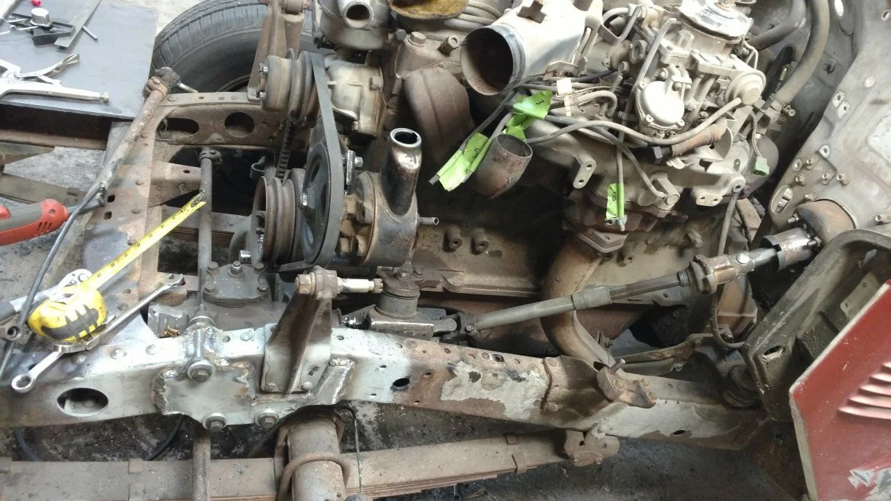

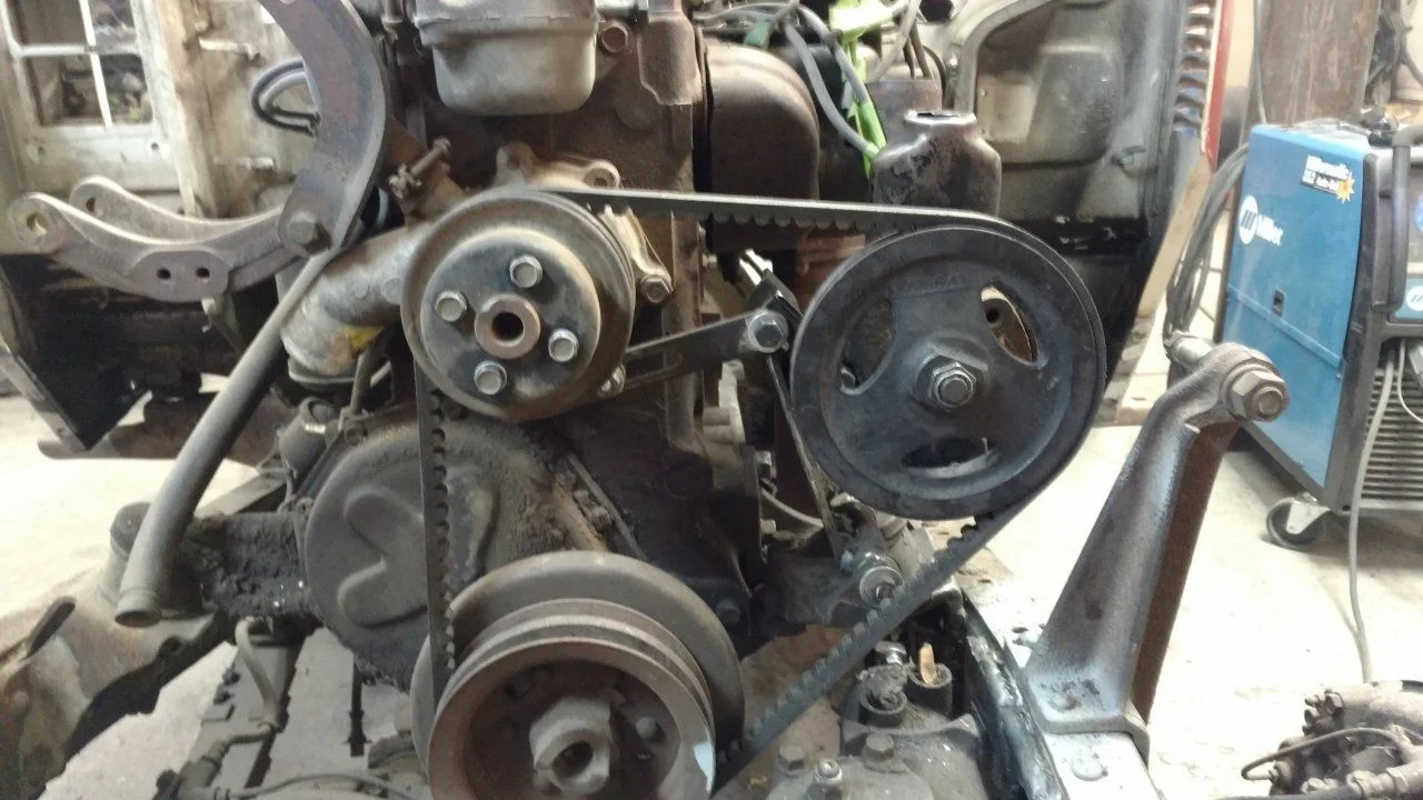

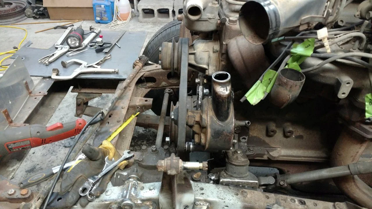

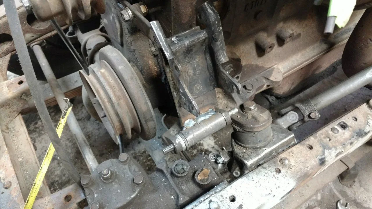

Got the pump brackets made and mounted. The pulley on the pump is a bit narrower than the Toyota but the correct belt for it does not bottom out in the Toyota groove.

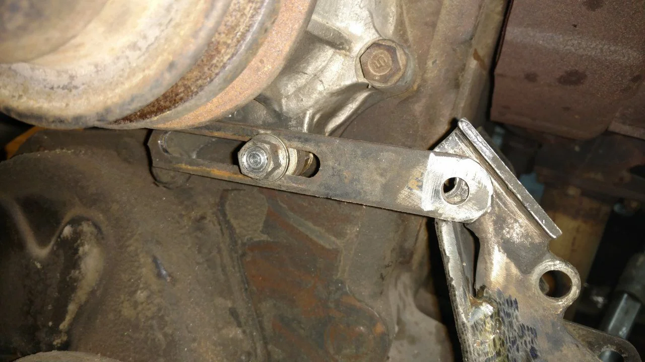

Pretty straight forward brackets. Used a heavy 2 1/2" spacer and a few washers to fill the space where the air pump mounted than welded a 6" long 2 1/2" wide piece of 1/4" to the main pump bracket and the spacer then cannibalized an old alt adjustment bracket to make one for the pump.

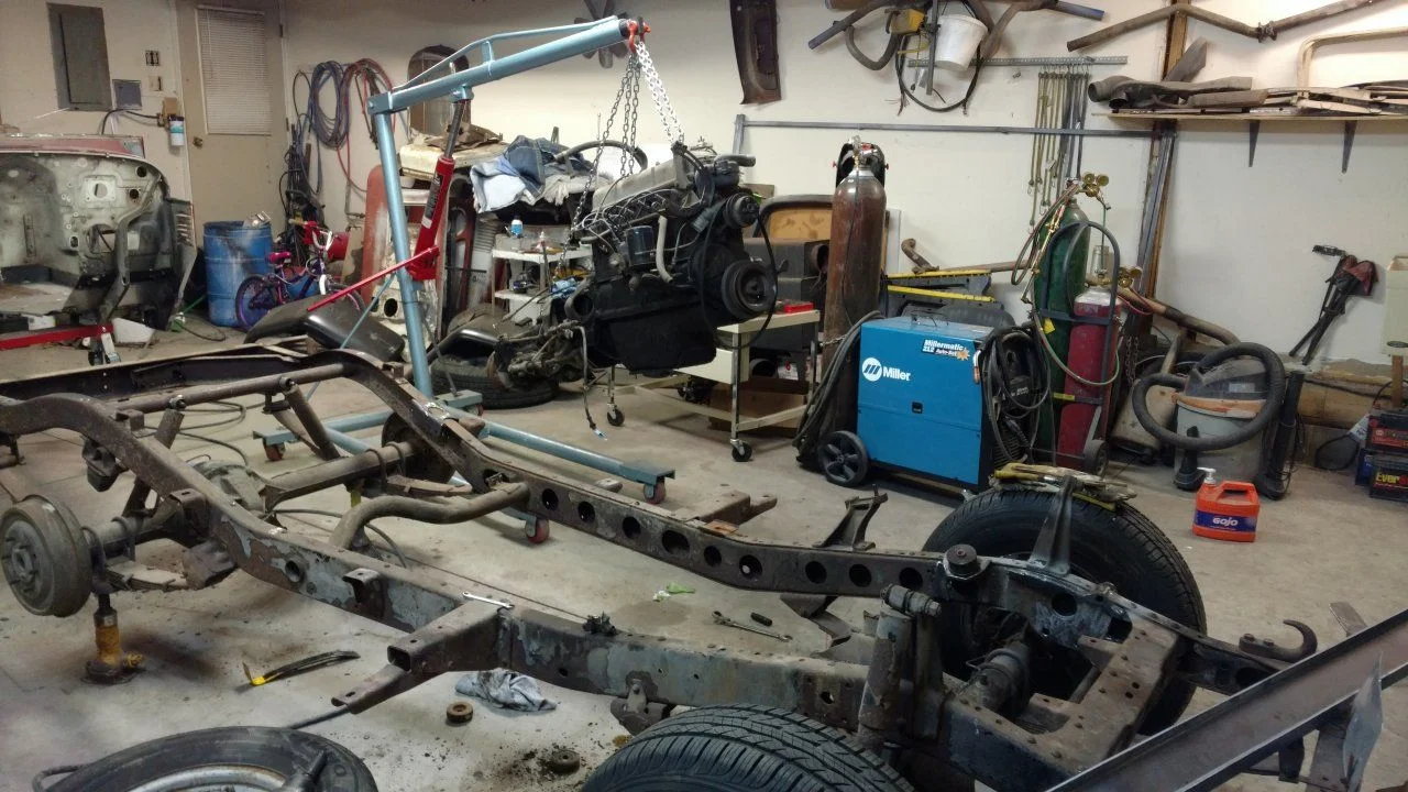

Finally! Made a bit of progress towards frame repairs tonight. I decided to take the engine and transmission off and it sure makes maneuvering around the frame easier. Had a metal shop bend some 1/4" into channels for me so I can repair the rear corners. Hopefully my 5 year old's wrestling meet doesn't completely burn the entire day tomorrow.

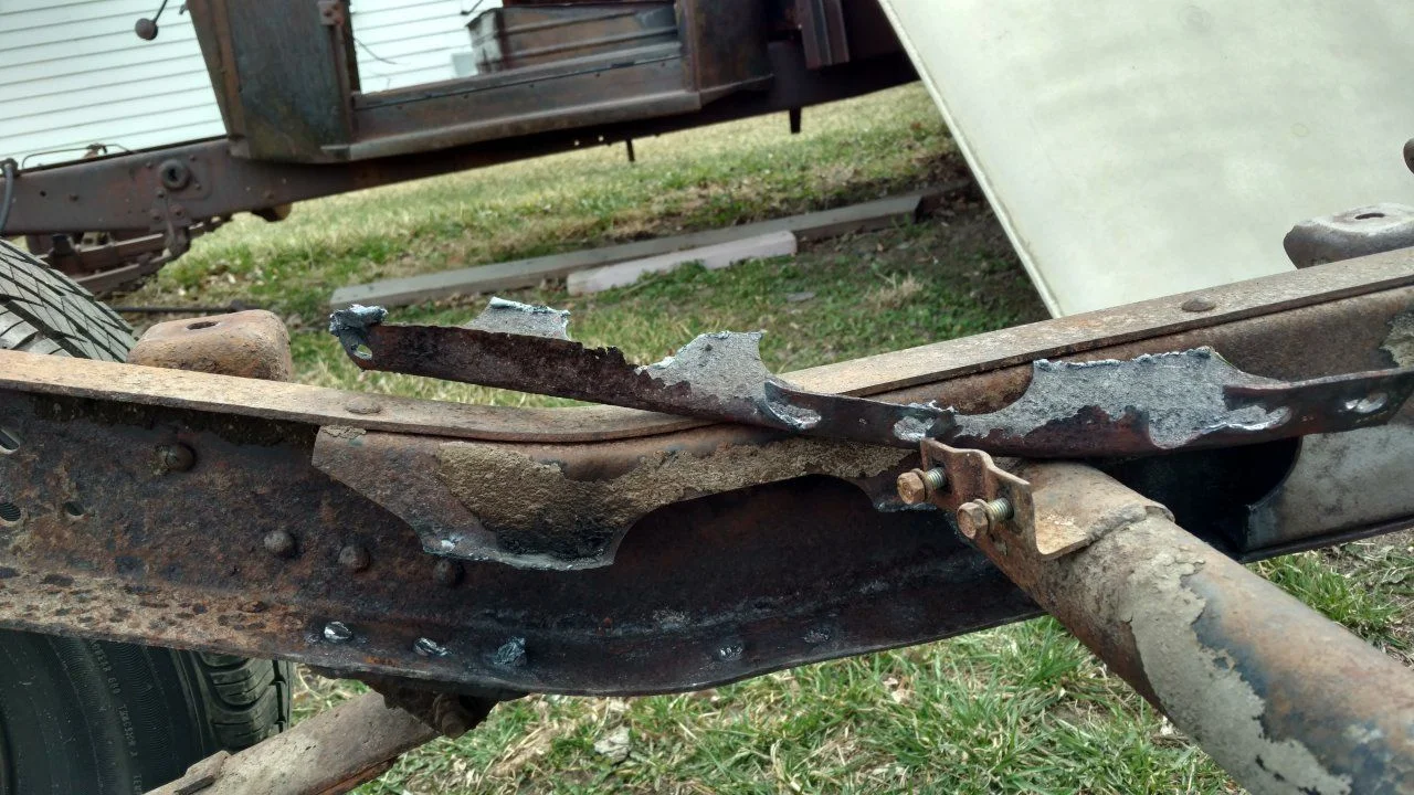

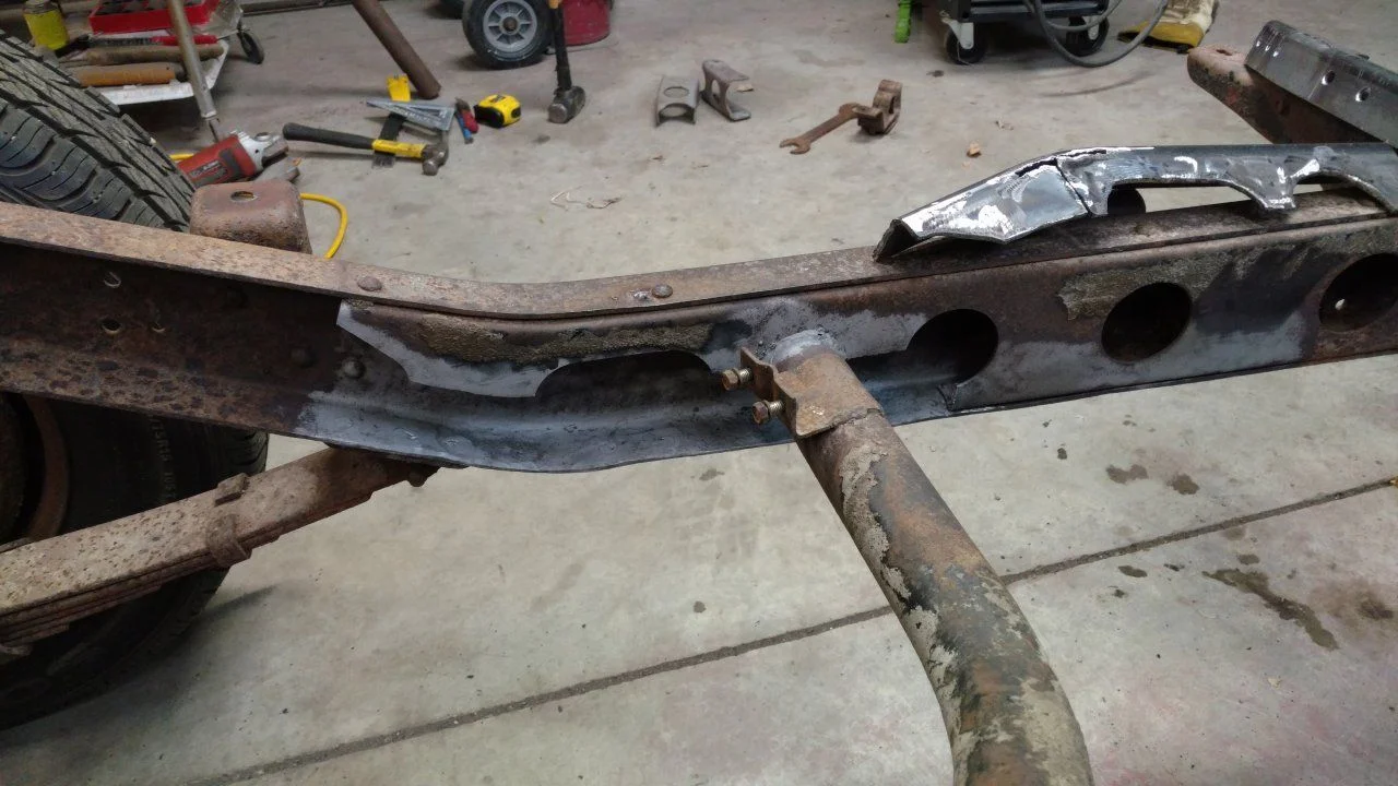

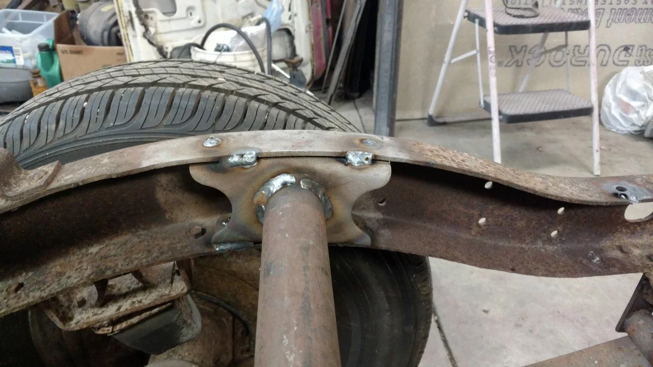

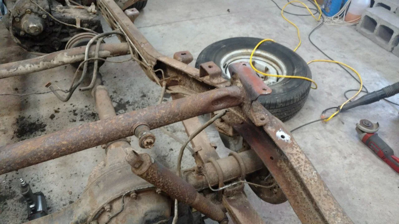

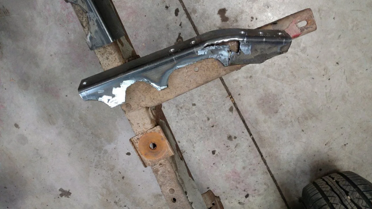

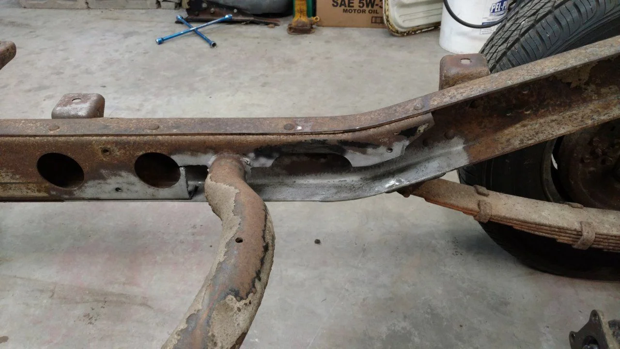

Got my rotten inner frame sections removed and cleaned. Then I made the replacement pieces out of 1/4" which wad bent to fit. Now I can just weld them into place. I got a little carried away with the torch when cutting the one patch so I could put a bend in it. Also, the last picture is what I removed.

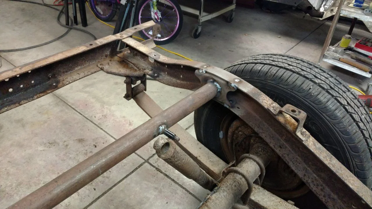

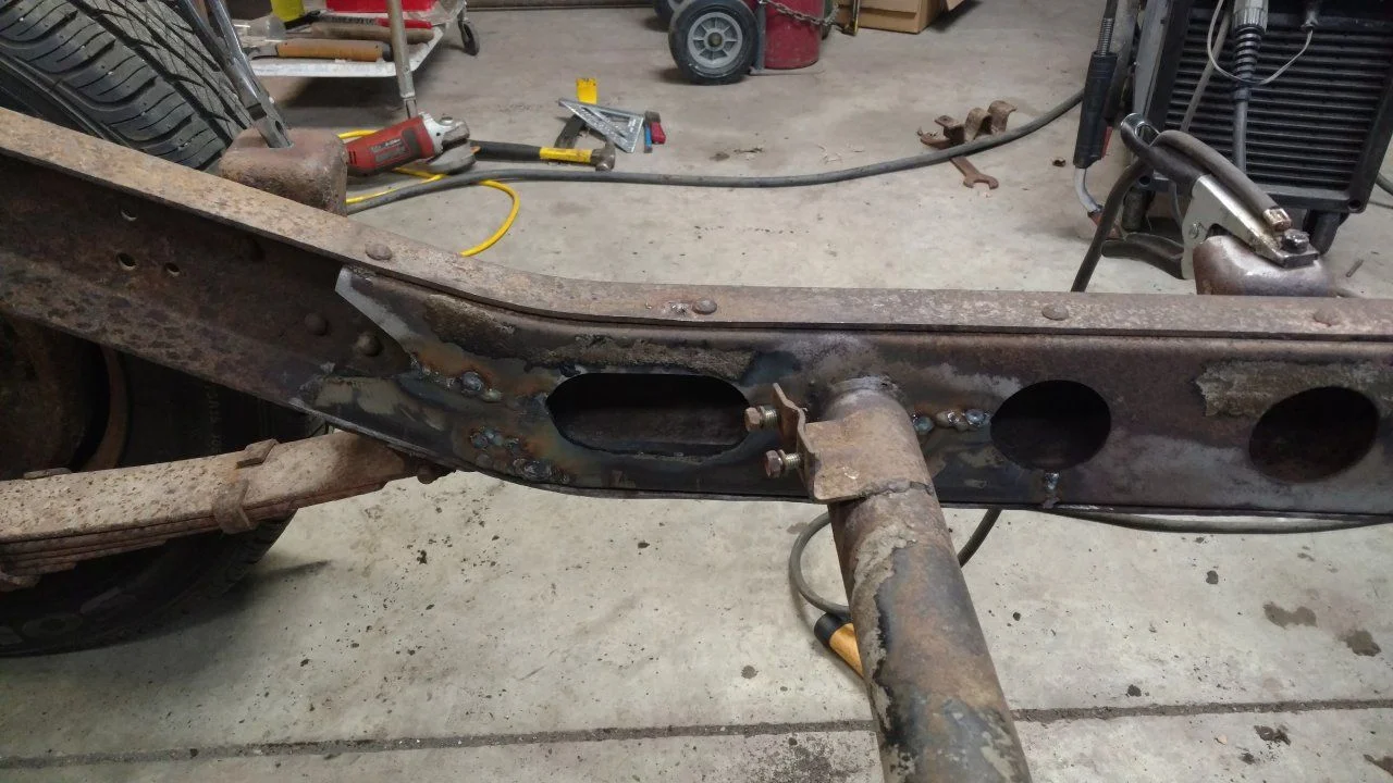

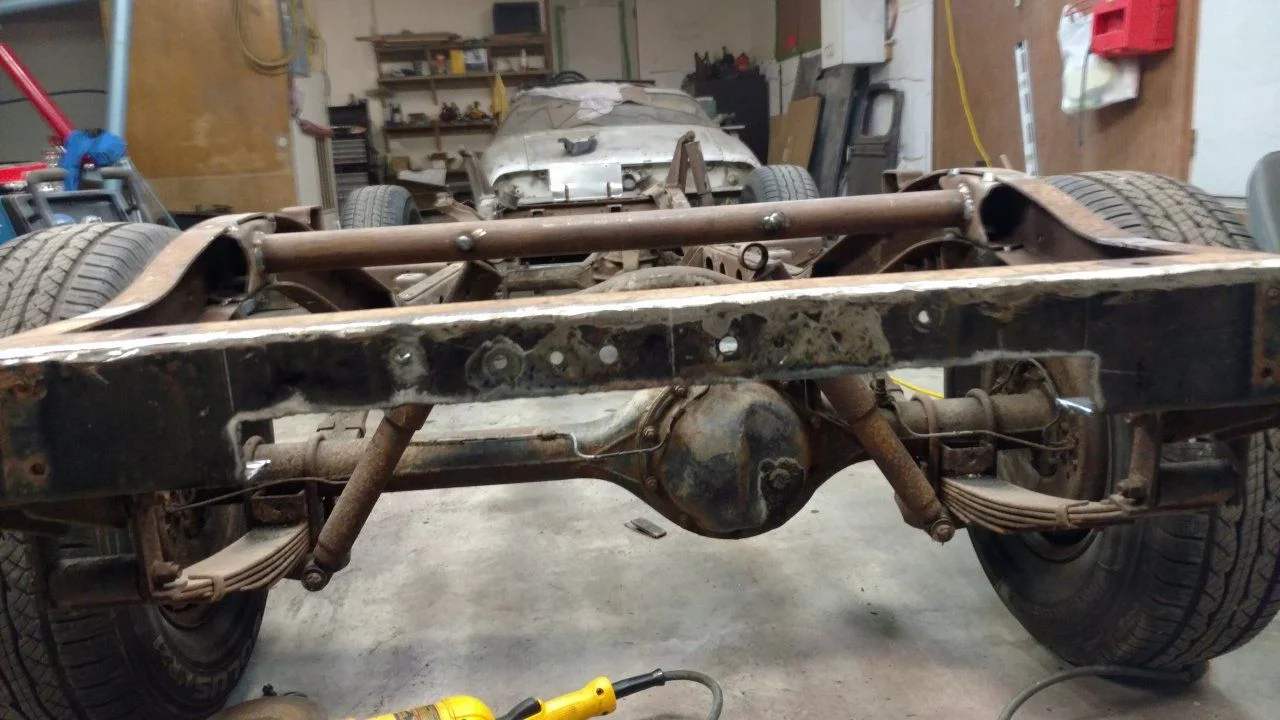

Got patches welded in and also welded my shock cross member back into place. I only removed the cross member because of the scale at the frame on either end. I really trashed the factory tube so I had to replace it. On the frame patches I drilled 1/2" holes where the rivets were and plug welded the patches then welded the seams. I also placed an 1 1/2" stitch along the frame where the patch butts up to the factory piece I haven't ground the welds down as of yet so it looks a bit rough. No one will be able to tell after its been galvanized.
I started the rear corner diagonal pieces also but no pictures.

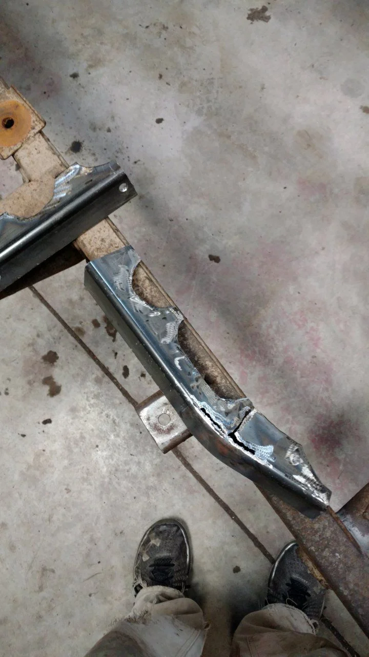

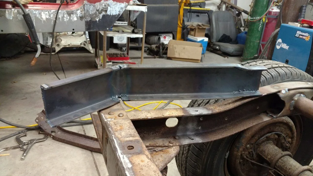

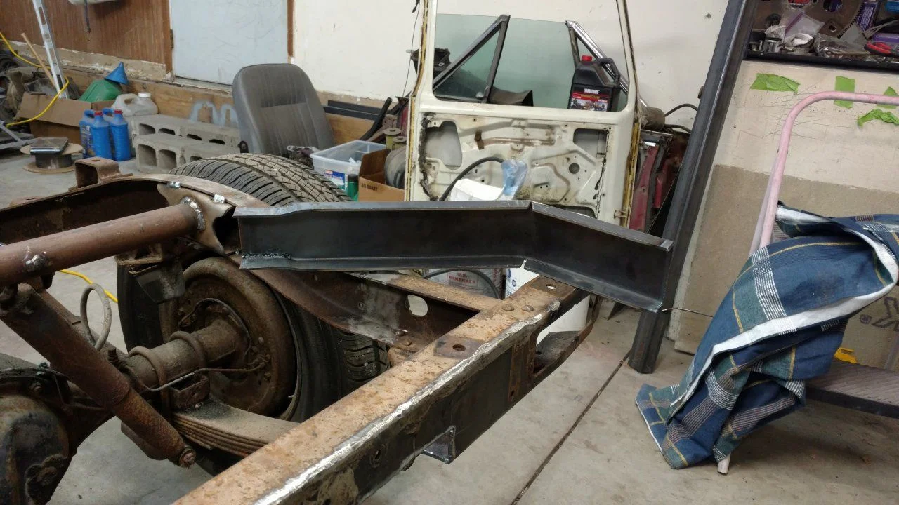

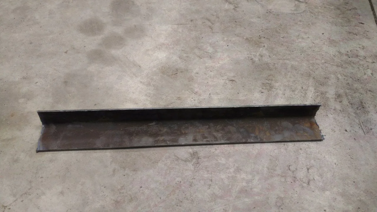

I have my rear frame diagonals made and they have a good fit, but I haven't filled my pie cuts yet. I also cut the middle 24" out of the bottom of the rear crossmember because the bottom was very thin. I welded in the patch but didn't take pictures. I only took pictures of the diagonals and the cut section. More soon to come.
