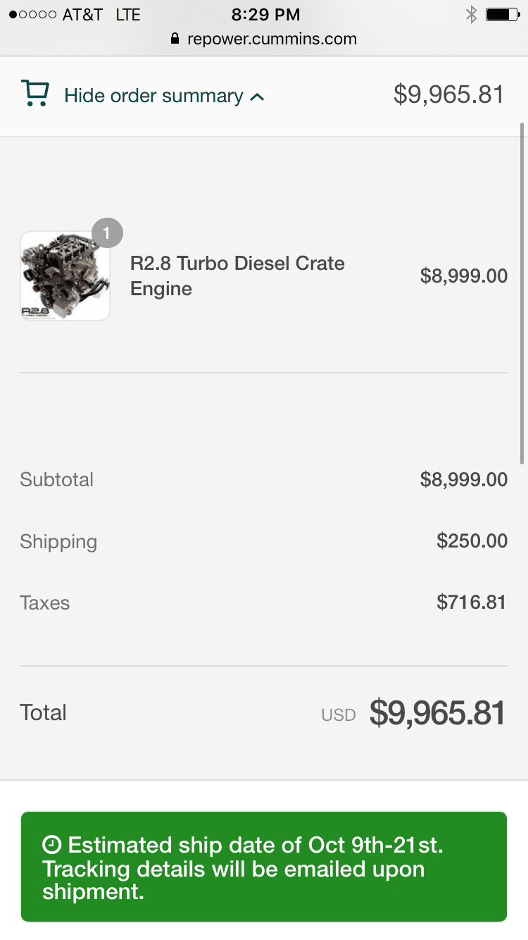

$9,249 shipped. I'll be anxiously waiting for some reviews of this motor in a 40.
Updated with taxes:
