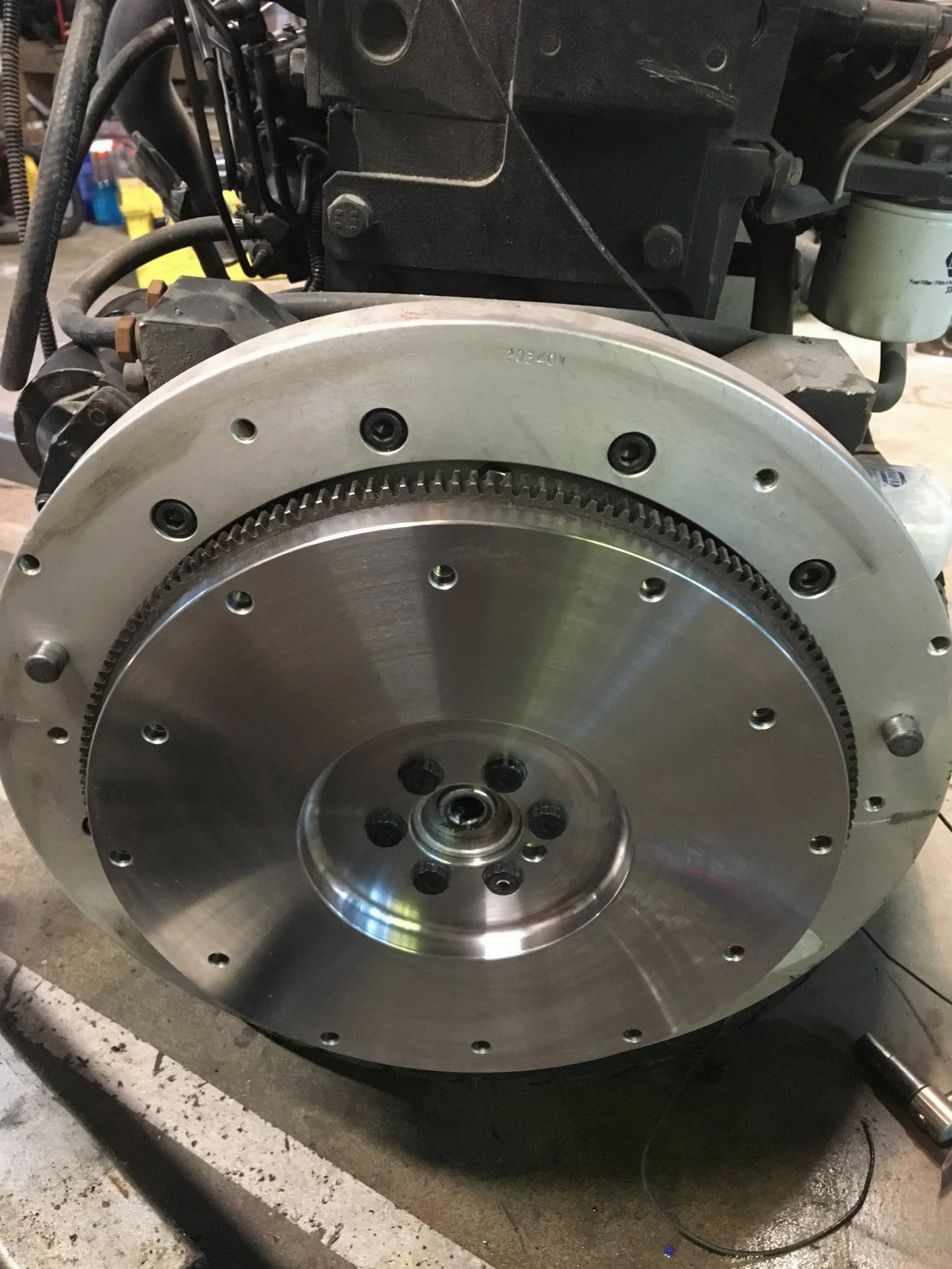

Custom flywheel housing by TorFab I assume? Which bellhousing/flywheel/clutch are you using? Looks like an AA SBC to H42/H55 bellhousing.

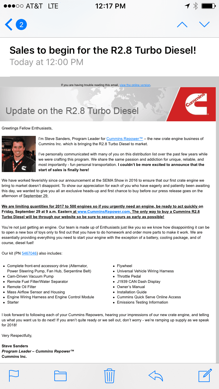

How much did the Cummins 2.8 kit cost? I didn't think they went on sale yet.
We are using an adapter from the Cummins to a 4L60e, then an AA bellhousing from that to an H55f. The Cummins flywheel got machined down to reduce rotational mass, and the AA flywheel also got machined down for the same reason.

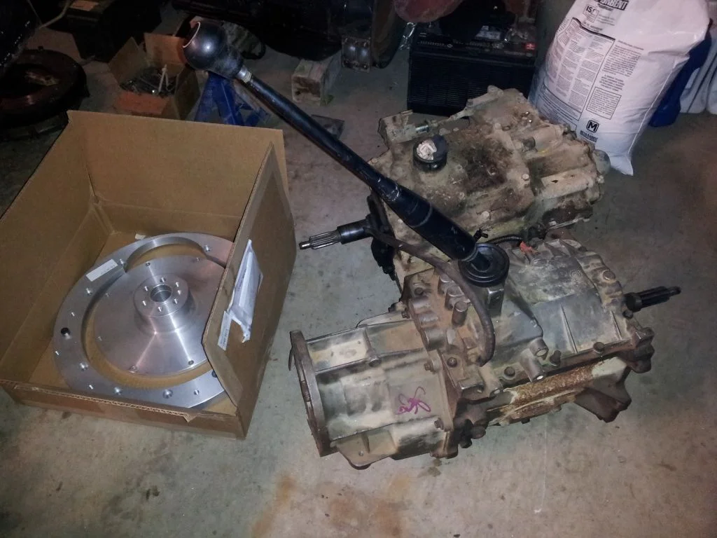

I'm not sure but I would bet it's the same if not similar to the SAE bellhousing used on the B3.3. There's a bellhousing adapter and also an adapter to be able to use an automotive flywheel behind the OEM diese flywheel. I got this stuff from Phoenix Machine and Casting in Nebraska. Bolt these up, and then it will accept Chevy stuff (or an AA Chevy to Toyota bellhousing).
I don't know if the SAE adapter will work or not. The AA guy did tell my brother that their 4bt/6bt stuff would not work.

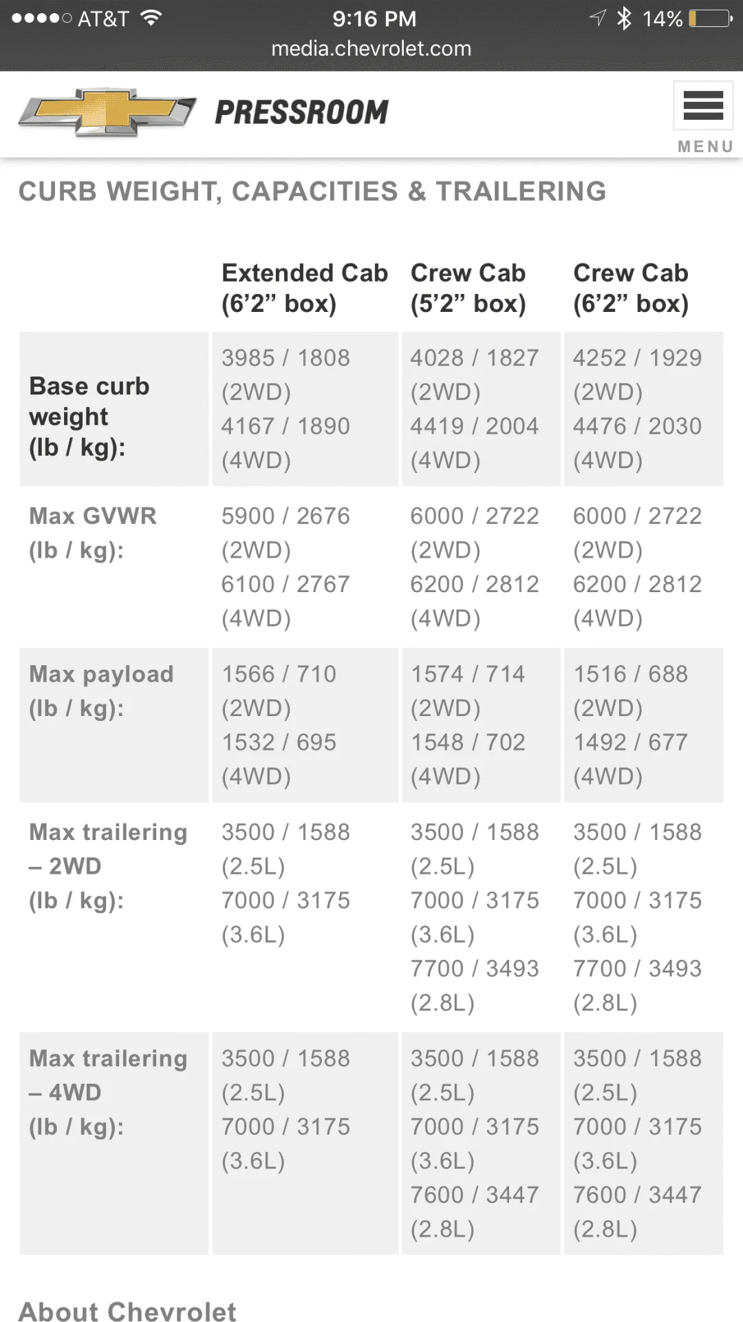

I have been following the developments of this engine for awhile, but I am worried about having a fully loaded fj55 and there not being the power that is needed. I guess the curb weight is about 6,000lbs, where the fj62 is about 5,000lbs. What's your take?
Chevrolet Pressroom - United States - Colorado
Based on the Chevy Colorado above with the 2.8 lists curb weight plus GVW (loaded with stuff and max trailering) to a total of 7600 lbs.
If it's your rig loaded (no trailer) is under that you would prob fine. Added vehicle/payload and trailer is north of that prob want to wait for the next motor size up yo.

I watched a youtube video this weekend where one of these was put in a Jeep. They mated an NV3550 (iirc) to the engine and they used both the flywheel that came with the 2.8 and the Jeep flywheel with a spacer inbetween thus allowing them to run all the standard clutch pieces. Seemed like a good idea to solve that problem but also seemed like a lot of extra mass to add to the equation....though the engine probably doesnt care.

They machined both flywheels to remove weight. Of course, the extra mass on a wheeling rig wouldn't necessarily be a bad thing.

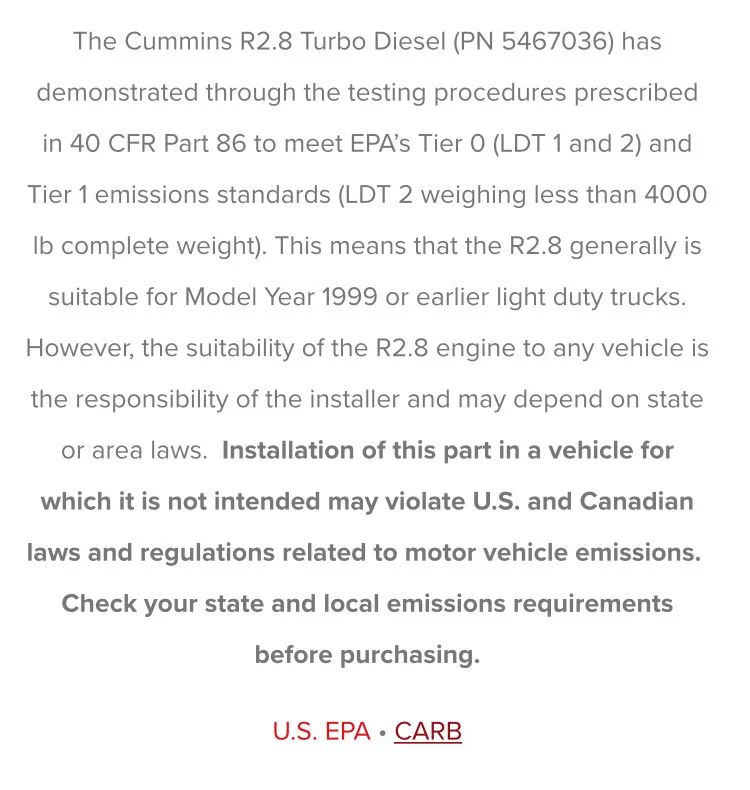

Usually if CARB certified, it says that in big letters. But, if you're earlier than 98, and can get it signed off as a diesel swap, you should drop off the smog testing requirement. I'm going to wait and see what @orangefj45 does with this. He's got the diesel swap thing figured out for California and I'd rely on his wisdom.
For California, once it states "CARB Approved ".

I got that same email, I couldn't find a price for that kit? Does anyone know?.
