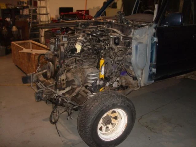

Here are some more pictures as to whats going on with her.
Everything is running full production. Im given a new time frame of october/november by the time she sould be driveable. At this rate, it may even be before then.

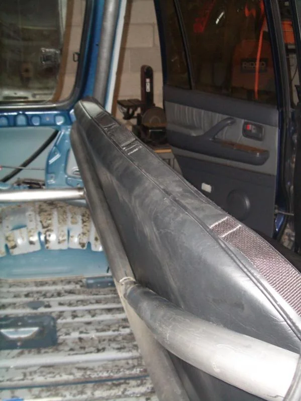

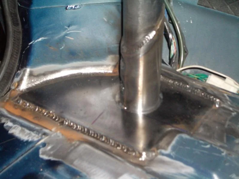

Here are the latest pics of the build going on here at Portal-Tek. The 12 point cage came together nicely. We had to strip the dash out so that we could trim it for the A post bars to go thru the dash instead of wrapping around it. This saves leg room and makes it trophy truck strong without losing normal entry. The cage also continues through the firewall where it will tie into the motor cage for weight transfer and a solid mounting point for the front coilovers. There are some surprises in store for some interior details to really give this truck full trophy truck capability without losing drivability. We are getting ready to start on the next stage of the build which is going to be a full tubular chassis that ties to the cage underneath the 80 body again for full weight transfer and strength. This also allows us to optimize suspension geometry and put the weight where we want it as opposed to having to fit within the stock framerails. This way we can make a truck capable of handling the big whoops sections at speed while still being able to fit in some of the "necessities for expedition" that Ron needs. Now we are just waiting on the green light from Ron to go on to the next stage. We have put a lot of thought and engineering in to the scope of this build with Ron. Here is a brief glimpse of what we have agreed with Ron to finish this truck.

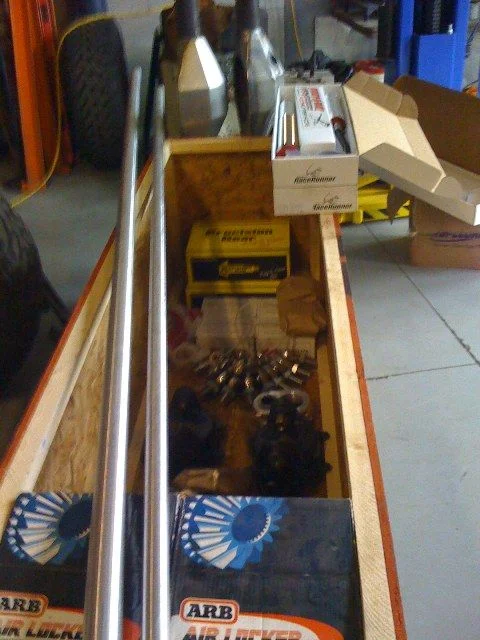

We will post some pics up tomorrow of parts new and old. Shoot an email over to production@portal-tek.com and I will respond to you with an attachment of wheel pics.
