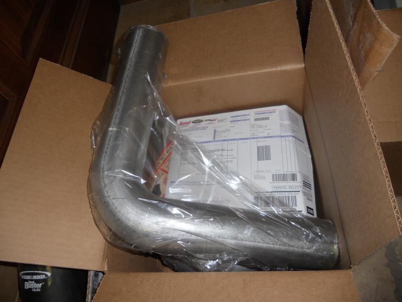

Some stuff came in from Jegs today. I tried to find a more reasonably priced Pyrometer and found some pretty cool ones for better prices, but the reviews said they were junk. Finally, I bit the bullet and bought Auto Meter. I'm a sucker for quality. Then there are some pictures of exhaust components.
