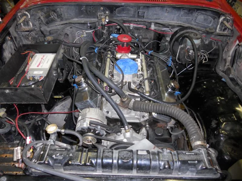

Hey!!!! POST PICTURES OF THAT 383!!!!

Picture of the 383...and more.
Here is a picture of the 383. And the second picture also addresses Stevo's concerns. If you look at the fram you can see how I re-fabricated the spring hangers to get a lot of lift without the SOA. I've got lots of lift. I think I will have to get stiffer OME front leaf springs, though.
