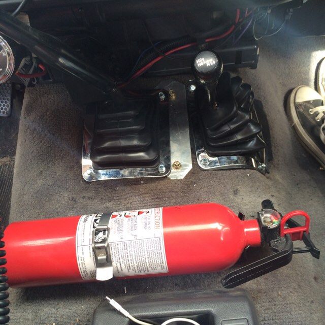

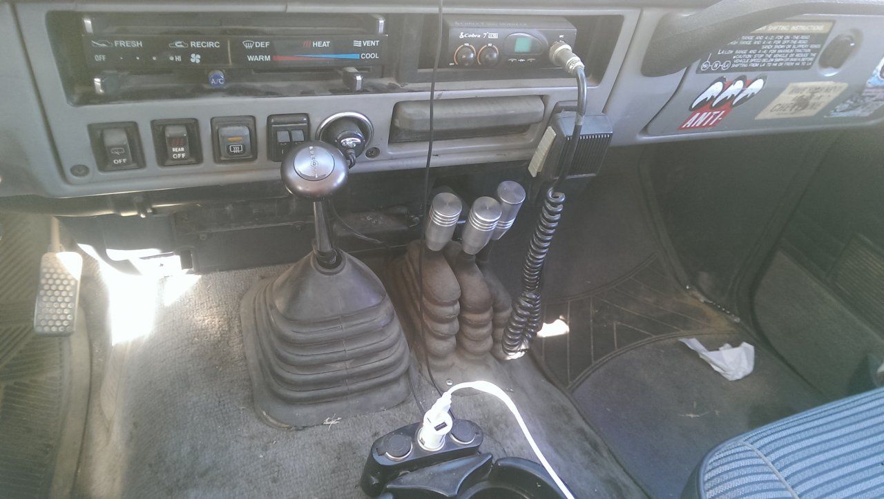

Those last two pics are of a mini crawler box, not a 203.
And none are mine.
Just a FYI
And none are mine.
Just a FYI
Whoops, yeah you're right those are from marlin crawler's website. I was just trying to show the shifters on the floor.
This photo is your set up, however not in the vehicle.
