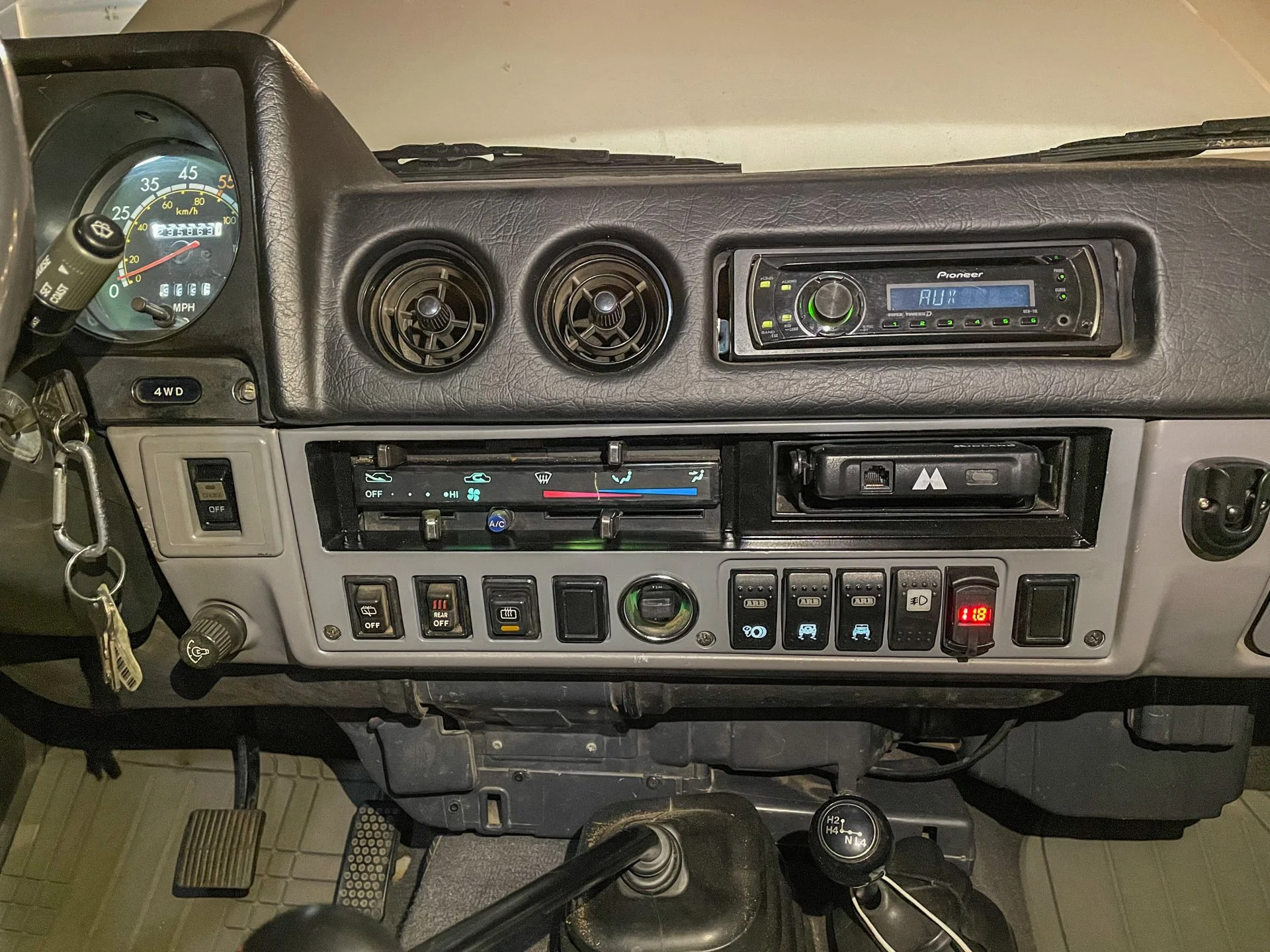

Here it is installed. Used rustoleum satin black for the black and kinda wish I didn’t. It’s too glossy. Should have got SEM for that part too.
looks KING S##T TOP SHELF !
awesome ..... :D
try a simple " De-Glosser " agent liquid on it if u need to sheen it down a tad ?
u obtain this at a Sherwin Williams paint store type place
or
Pep Boys has a vast line up of AUTO interior Plastics and Upholstery aerosols paints
they are INDEED a SATIN / LOW LUSTERE semi-gloss if you will matches toyota interiors perfect !

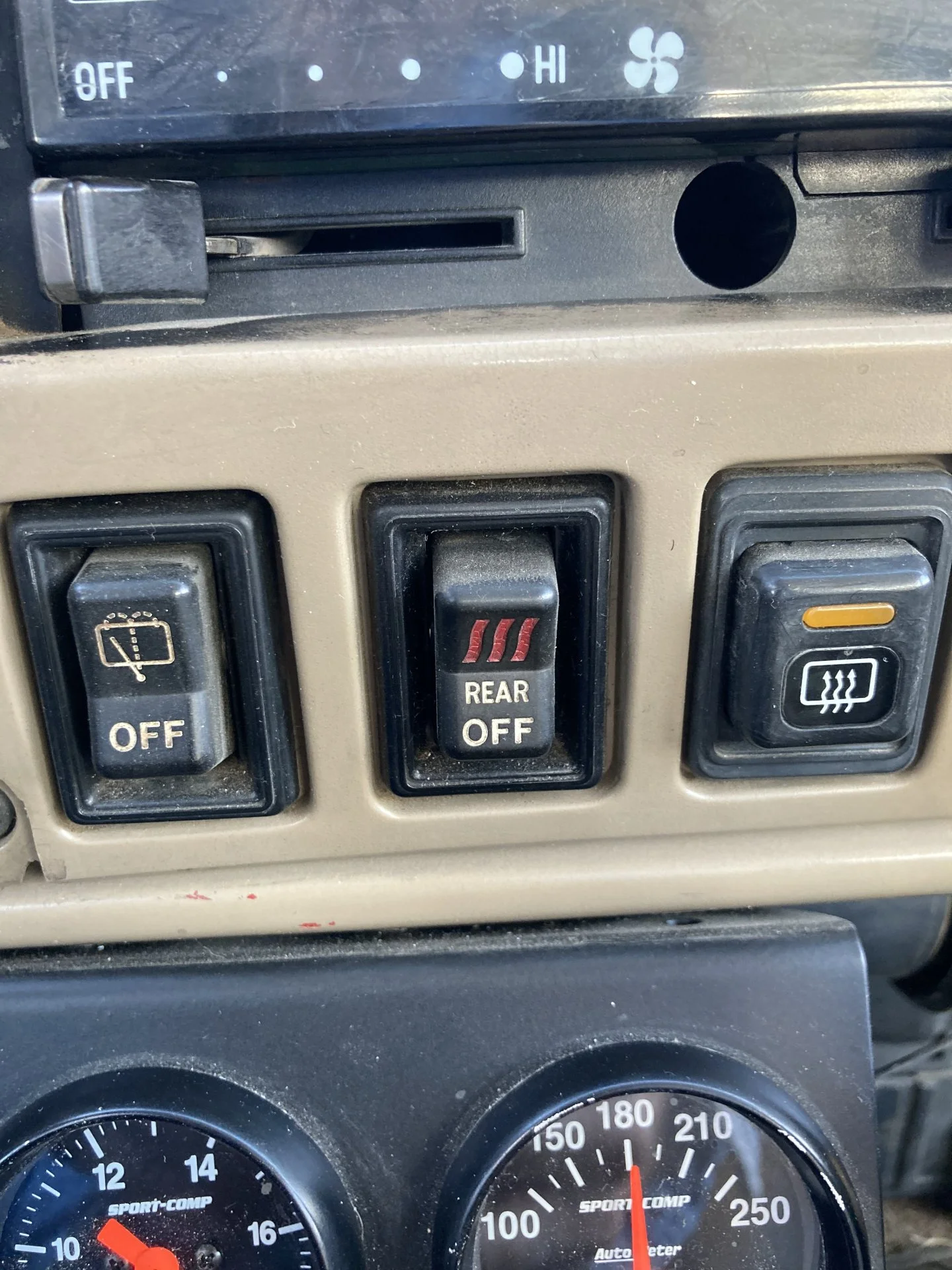

Has there been any thought to retrofitting backlights into the stock 60 switches? They are hard to find in the dark. I'm not sure how that would be done - dremel out holes in the switch itself, or maybe let the light come out between the rocker and the bezel of the switch itself?
Obviously the defrost switch has a light when it's on - I'm talking about lights that are always on (green to match the rest of the lighting scheme maybe) so you can actually find the switches at night.

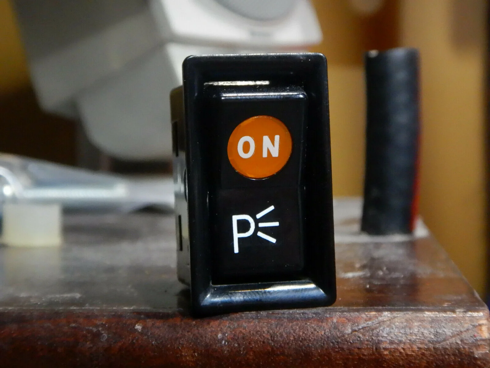

- ACTIVE ON Illumination switch types generally have 2 bulbs but not all the time
- Passive Illuminated Switches , they LIGHT up when u engage your parking lamps head lamps / both etc ,,,,,,
- passive generally have ONLY one bulb , but not all the time
- the fj60 defrost switch has 2
- the FJ62 defrost switch only 1 bulb ( Active Engagement ON )
- this is in a NUT shell how TOYOTA termed some various switches on the OLD SKOOL Microfiche
- however there are MANY Unique oem switches in LAND cruisers that break these rules , and most are NIN USA varity
- MANY also have the 2 BULBS type , passive illumination and the ACTIVE ON feature too
- what BLOWS is most of these UNICORN switches are NON-USA Goodies we did not or do not see much ?

Dude ive got 6 hours into the rear heat switch. My plan was to cut out the little heat squiggly lines and letters, then put EL Lighting tape behind them. I gave up on it a long time ago. Its SOOOOOOOOOOOO much work just to even do one of the little bacon looking strips. Ive searched for similar sized switches from other vehicles and havent been able to find anything.
