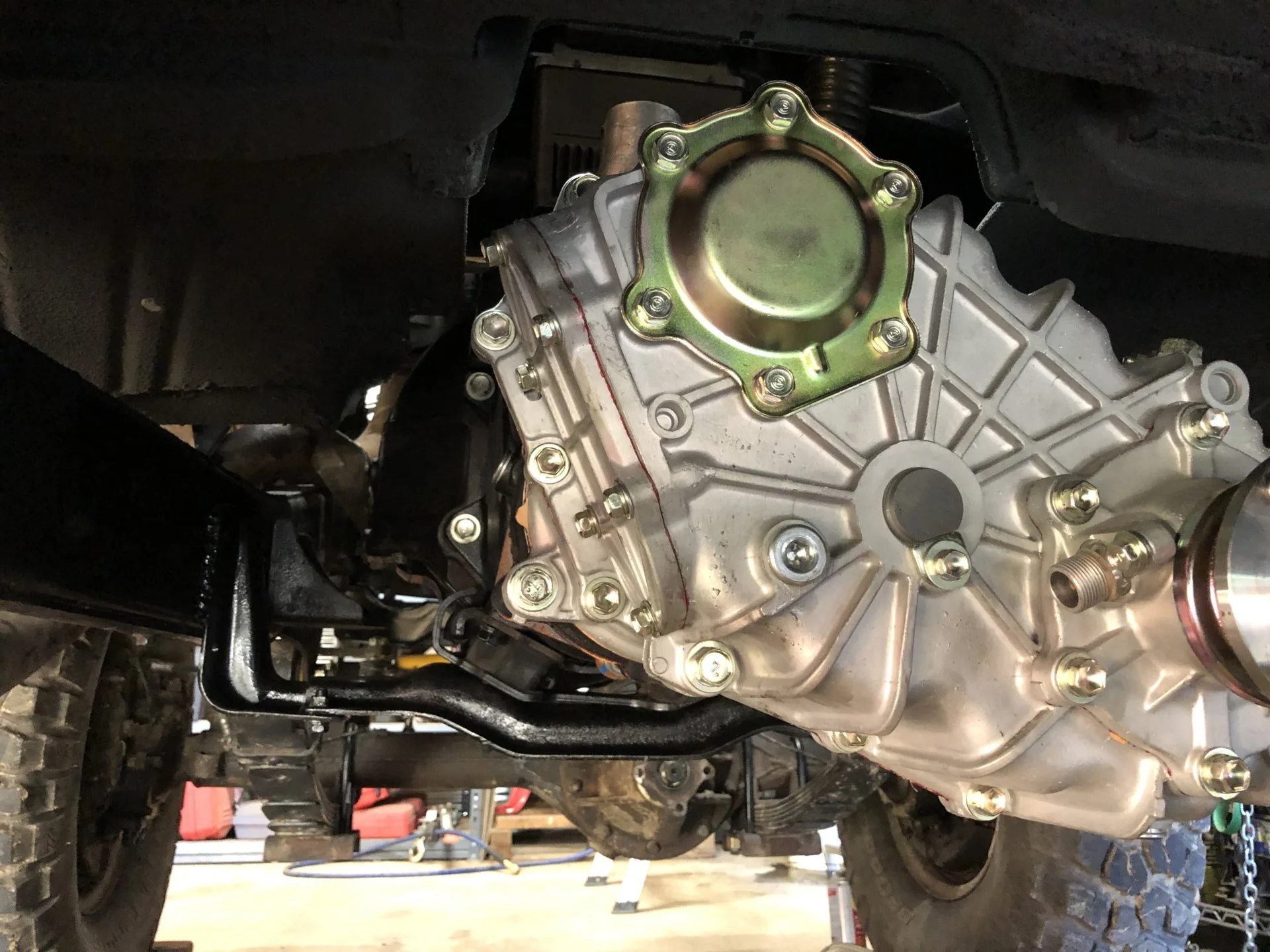

Has anyone used an HJ47 crossmember for an H55F in a 55?
There is this:
From here: Builds - The Warthog v4.4 - https://forum.ih8mud.com/threads/the-warthog-v4-4.1117343/page-11#post-12221300
Did the HJ use the H55? If so then I don't see why it wouldn't work!?
Frame width is different but it would work. 60 is easier to find here.
