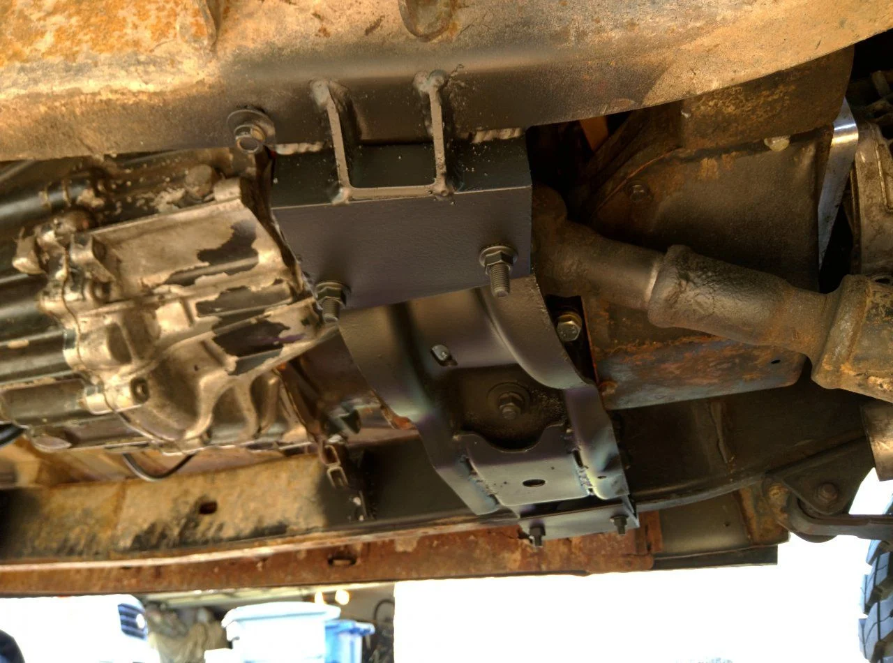

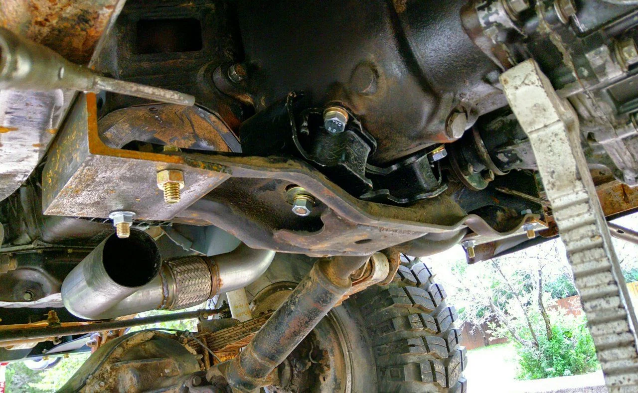

I have the H55, but connected to the Chevy 5.3 via an Advanced Adapter. There is no clocking with mine and due to clearance for the tailpipe I had to dip down some from the frame. Where mine needed to be is right where the frame bends out. I spent a good week thinking and building this second revision...

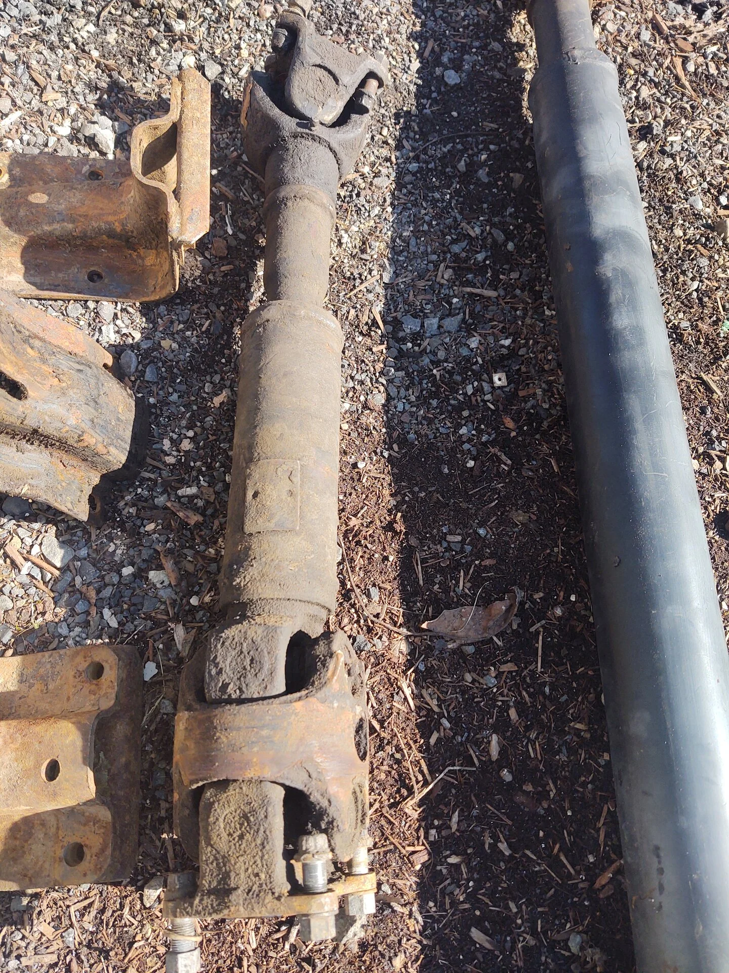

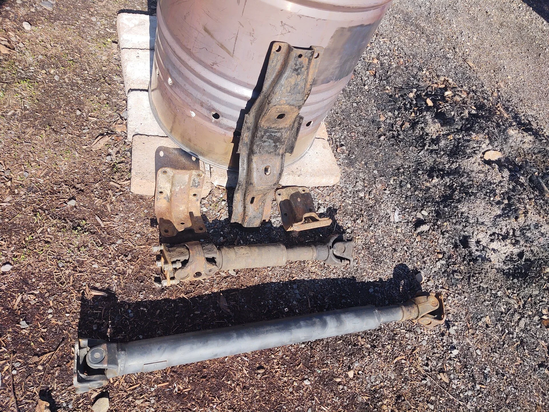

A cross member and drive lines just came available in my area. Should I get the drivelines too? Or at least the rear driveline?
yeah buddy. I picked up the lot. Check out the modified drive lines. The guy told me they will accomodate a FJ60 up to 4-6" lift. I should be able to make these work.
The guy installed Chevy engine and Auto Trans in his 60 then sold it. He also has the All manual FJ60 Transmission stuff If anyone wants to convert a 62 to Manual.
Yea you will want both the front and rear drive shafts. They will need to be taken to a shop and made the correct length to fit the new/unique dimensions.
