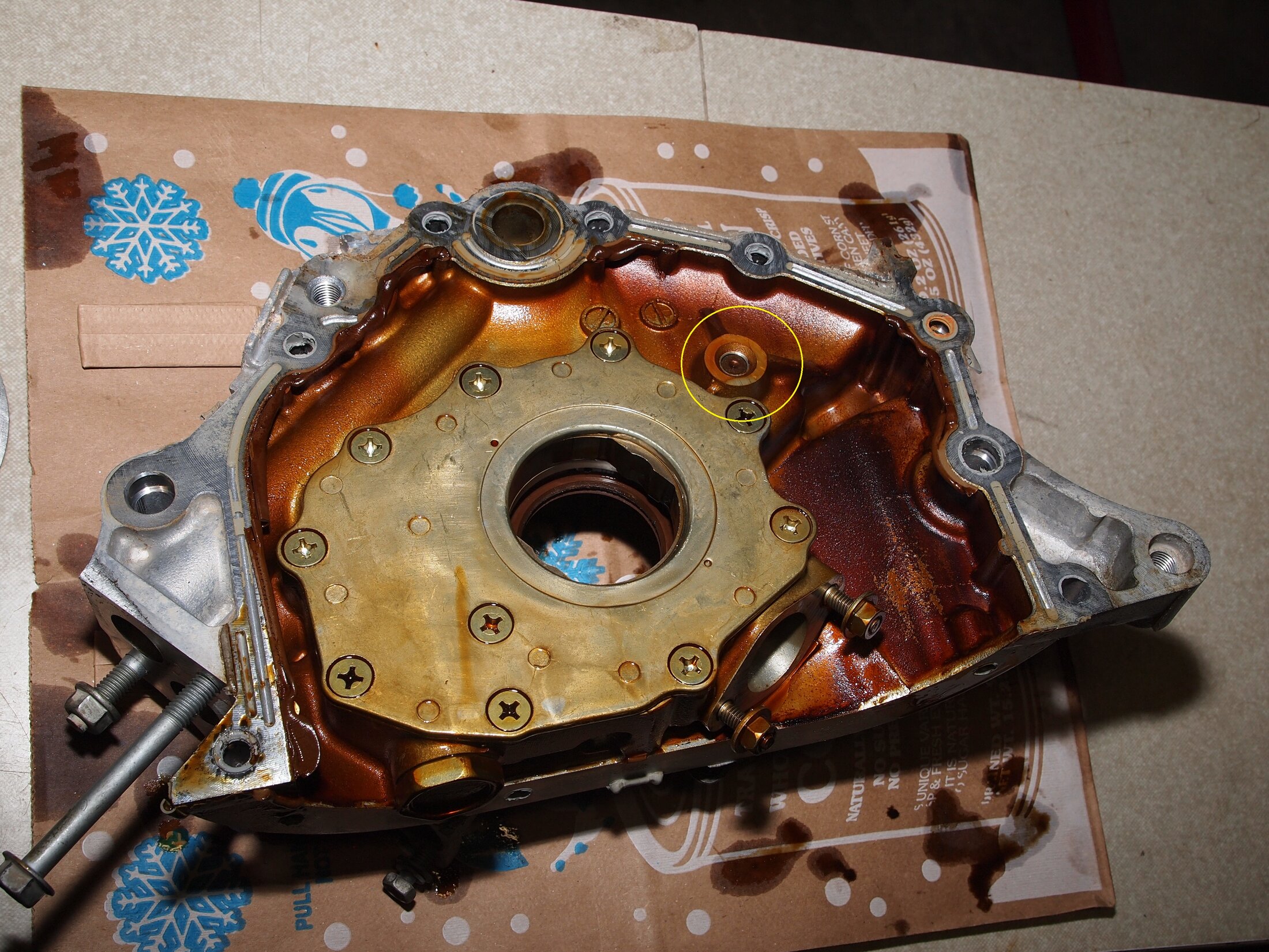

I'm doing a T-belt R&R in a 4.7L VVti w/265K miles. Found last guy in cross threaded tensioner pulley bolt during install. It felt strangely tight coming out, I'd hope just thread sealer. NOPE!.
I'm leaning toward replacing the oil pump. But I really don't want the extra 20 hours labor.
But, I see 3 issues with helicoil or time-sert or any that need drilling & tapping.
1) I see hole passes through. Which drilling and tapping, risk aluminum shavings going into oil pan.
2) Not alot a lot of metal in capture nut casting, would remain for strength after drilled and tapped.
3) Drilling the bore square, is problematic.
Oil pump housing, I've on the shelf. The yellow circle is the capture nut w/ bolt Tensioner bolt in it from viewed from backside.

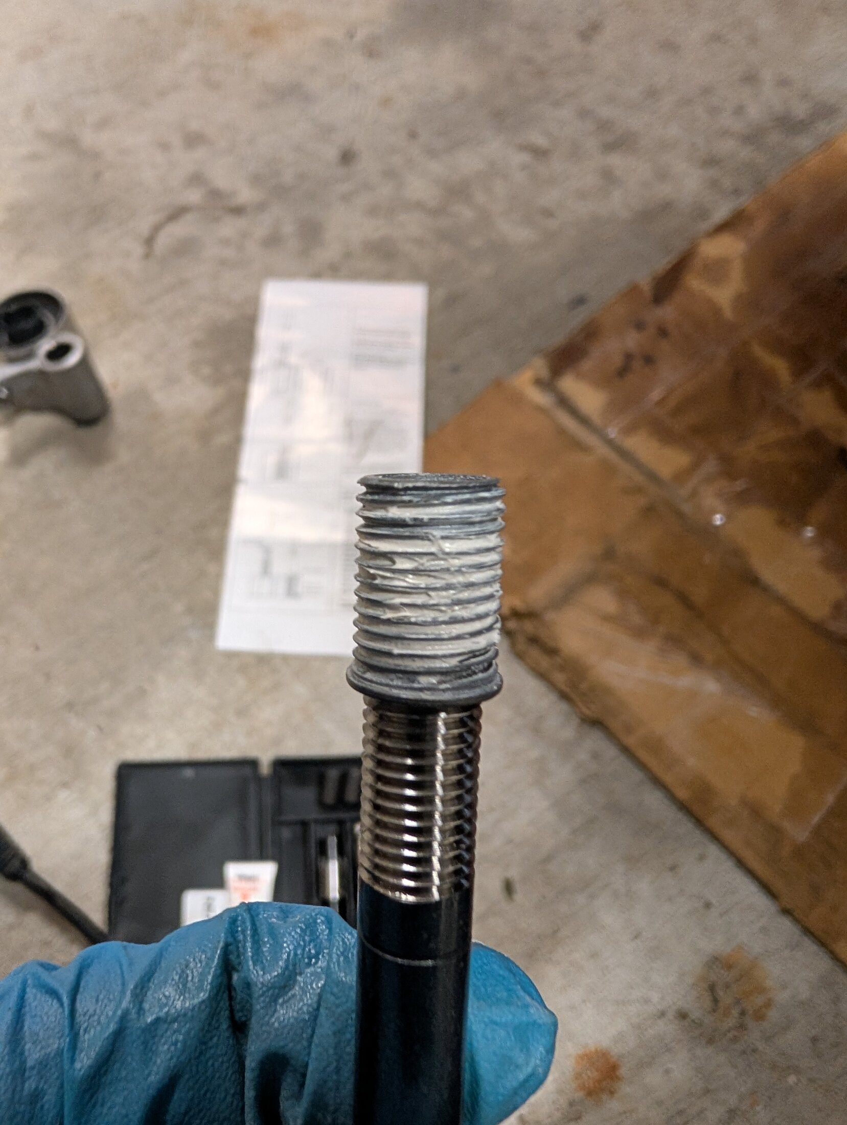

Alright, I did the repair tonight. It went exceedingly well.
I drained the oil and coolant. Removed fan, shroud, and radiator. Then I removed the crank pully and the timing belt cover down there, didn't have to remove any other components or covers thankfully. Remove the tensioner and pully bolt and then you can kinda wiggle the tensioner pulley out of it's slot and get to the pulley bolt hole.
You want the standard M10 x 1.25 kit here,
Once the pulley is out of the way, you can just zip tie the timing belt to get clearance to the hole.
Bc I removed the radiator, I was able to get my entire body into the engine bay from the bottom with my drill so I could keep a really close eye on keeping things square when drilling out the threads.
After drilling out the old threads, you use the kit's counter bore attachment so that the threaded insert sits right below flush and doesn't interfere with the mobility of the pulley.
Then take your time, and tap the threads. I HIGHLY recommend using the little extra "tap guide", a few bucks and really takes the pressure off when you're tapping the new threads, keeps things nice and square. (see it below on the tap). When you're done, you'll have new threads for the external portion of the insert with a nice counterbore for just below flush fit.
After that, put some high temp sealant on the external threads of the insert.
Once you've screwed in the insert, you'll have this new lovely set of threads, that can easily take the 25 ft-lbs you need. Considering where I'm at with mileage, this likely only needs to last me 1 more timing belt change at most. I've been very impressed with this kit. If anyone needs it, I'll sell at a great discount! lol.

A few extra pics of the thread sealer and the insert. And then pulley re-installed. Letting it all cure for 72 hrs before I introduce oil and heat to the threads.
