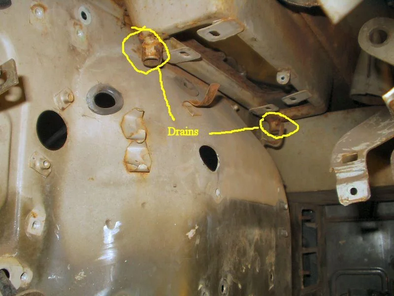

:lol: Exactly what mine was doing when I got it. I had no idea there were drain holes in the bottom of the vent well connected to hoses that were supposed to drain the water. The heater does an excellent of hiding everything.
Here is a pic of the drain holes as seen from the bottom once EVERYTHING under the dash was removed... The OEM hoses are no longer available new. SOR MAY have some used ones but bend over...
You can fabricate new hoses. Search here for what some have used. Also make SURE to put some kind of screen under the grate to catch most of the large bugs and such that will get into the vent and clean it often to prevent the hoses from clogging.
I have a 73 and I use plain heater hose for my drain tubes and works fine, mine drains through the fire wall, plus you can use longer lenghths of tube and direct flowout behind the wheel wells or wherever.
You might want to double check that. I bought some new hoses from CruiserDan not too long ago.

I plugged the drain holes with alum tape and worked some silver por down the inside then painted the inside with por--a couple coats
I coated the whole inside with alum tape top to bottom and reopened the drain holes then painted over that with POR again
I think that will hold up pretty good but if it has any probs I'll cut it out and put in a new one --the pan could be fabbed up pretty easy and maybe put in a couple screened fitting with drain lines
on mine the drain holes were pitted but the rest looked pretty good so they are still able to accept the hoses
I think it just needs cleaned out now and then and was overlooked by first owners

Oh yeah Aquarium tube hose is available in a large enough size at pet stores
Remember what you paid for them?
I found these part numbers in the EPC. Don't know if they will match the new numbering system... :confused:
Passenger side Hose: 55759 Qty 1
Drivers side Hose: 55767 Qty 1
Passenger/Driver side firewall Grommet:55759A Qty 2
Passenger/Driver side Mounting Clamp: 90462-10043 Qty 2
