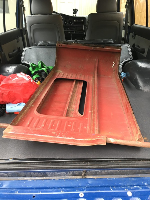

Well out of the blue I was alerted to someone very close to me selling a pair of early hardtop side pieces. They are in pretty good condition and were very cheap. The seller is hoping to find the rear folding door as well (fingers crossed). So I jumped on it. Figured I either find the rest of the parts and go with a hardtop, or not and just fall back to the OE soft top configuration.
Lets see where this goes.
