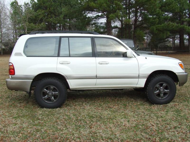

Anyway, purchased my 2001 Land Cruiser in October 2010. One owner soccer mom car with 137k on the odometer. I have fixed the easy stuff like antenna, rear wiper straightening, etc but did my first mod about a month ago. I have been waiting for nice weather to take pictures.

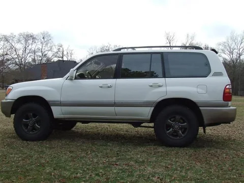

I removed running boards and bought a 30mm rear spacer from Slee and cranked my factory torsion bars 13 rotations. I refinished my factory 16" rims with Duplicolor graphite and ordered a set of 285/75-16 BFG AT Load range D from Tirerack.com. I think I am pleased how it has turned out so far.
I know that my CV boots have let go on both sides so I am thinking about new boots and clamps and possibly the Slee front diff lowering kit.

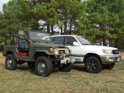

Nice. Thanks for sharing. I had a 40 that same color scheme.
Looking good man! I love the way your wheels turned out, thats a nice color. Let us know how well it holds up.
Thats a slick looking 40, too. :)
I thought mine was a one of a kind...:grinpimp:. It is originally Freeborn Red. The olive drab is just keeping it from being an eyesore till I can paint it correctly.

I talked w/ yoter100 about this and he did his about a year and a half ago. He said it has been through sand, mud, snow and has held up well. I did mine the same way and it appears like it will be fairly tough.
I probably leveled/lifted my front end by about 2". Since my cv boots are now leaking, should I do the Slee diff lowering thing? Or will just new boots and clamps and grease do the trick?

I don't think my cv boots were actually damaged. I think when I cranked the torsion bars it changed the angle enough that it forced an amount of the lubricant to be pushed past the bands on the boots.
Wheel paint is holding up very well after 10 months. I am still happy with that decision.
I did go ahead and do the Slee Diff drop and I am very pleased. I am not sure mine needed it but I feel like it is an ounce of prevention. I have probably put 20k miles on it since the lift and diff drop. No more leakage.

LOVE that 40... thanks for posting the pics I have the same colour scheme on my cruiser and have been thinking about the graphite wheels for a while now.... my worry is that they make the wheels look very small in comparison to the large white body and are far more suited to the darker colour 100's
Great tyre choice for the daily dirver!
Looks great...both of them. I did my wheels in the same paint and they are getting pretty scratched up. I would hate to see what they would look like if they still had the OEM coating. Nice to know that a few hrs on a Saturday will fix them right back up.
I'm looking to replicate your setup on my white 100!
