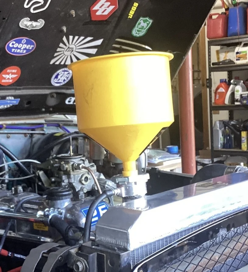

Yes. All I ever do is drive up on a steep ramp so the radiator cap is above the heater hose. Open the cap and let the engine run for a while with the heater valve open. When your engine is cool there should be some air space in the radiator (IMHO). With an excellent sealing cap, a good vent hose from the cap to the reservoir that isn't leaking - technically the coolant should push out of the engine when it gets hot and suck back in when it cools down.

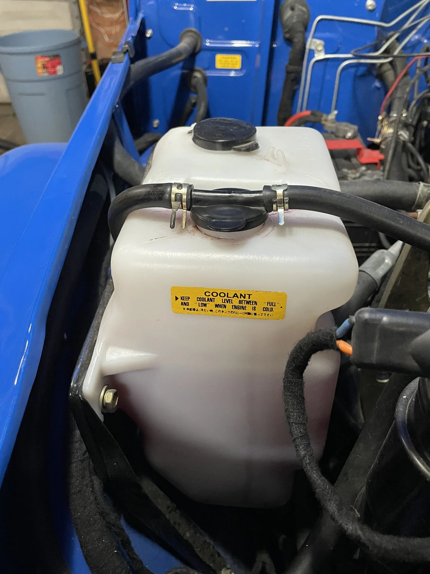

Some older fj40's had a tube going down the side of the radiator and did not have a catch can. If the dealer didn't drain the block thus doing a proper flush you might have incompatible coolants jelling up, might need to be burped, might have a bad cap, might b overheating, might be normal if it doesn't have a catch can. Picture of your overflow would help. The tube drain goes right down the pass side of the radiator, the catch can style will be on the pass side also. For starters get a cheap manual temp gauge or fix yours, is the wire connected on the sender, back drivers side of the head about 5 " from the firewall. Spade connector on it.

Pop the hood and post a picture of what you speak of. You mention a reservoir, do you mean an expansion tank?I

Thanks to so many replies, I think I found the issue. There was too much antifreeze in it. The radiator was full and the expansion tank was full…way past the FULL line.
In the pic, the line that runs towards the left is the one that hangs free under the tank and where the antifreeze has been coming out of.
