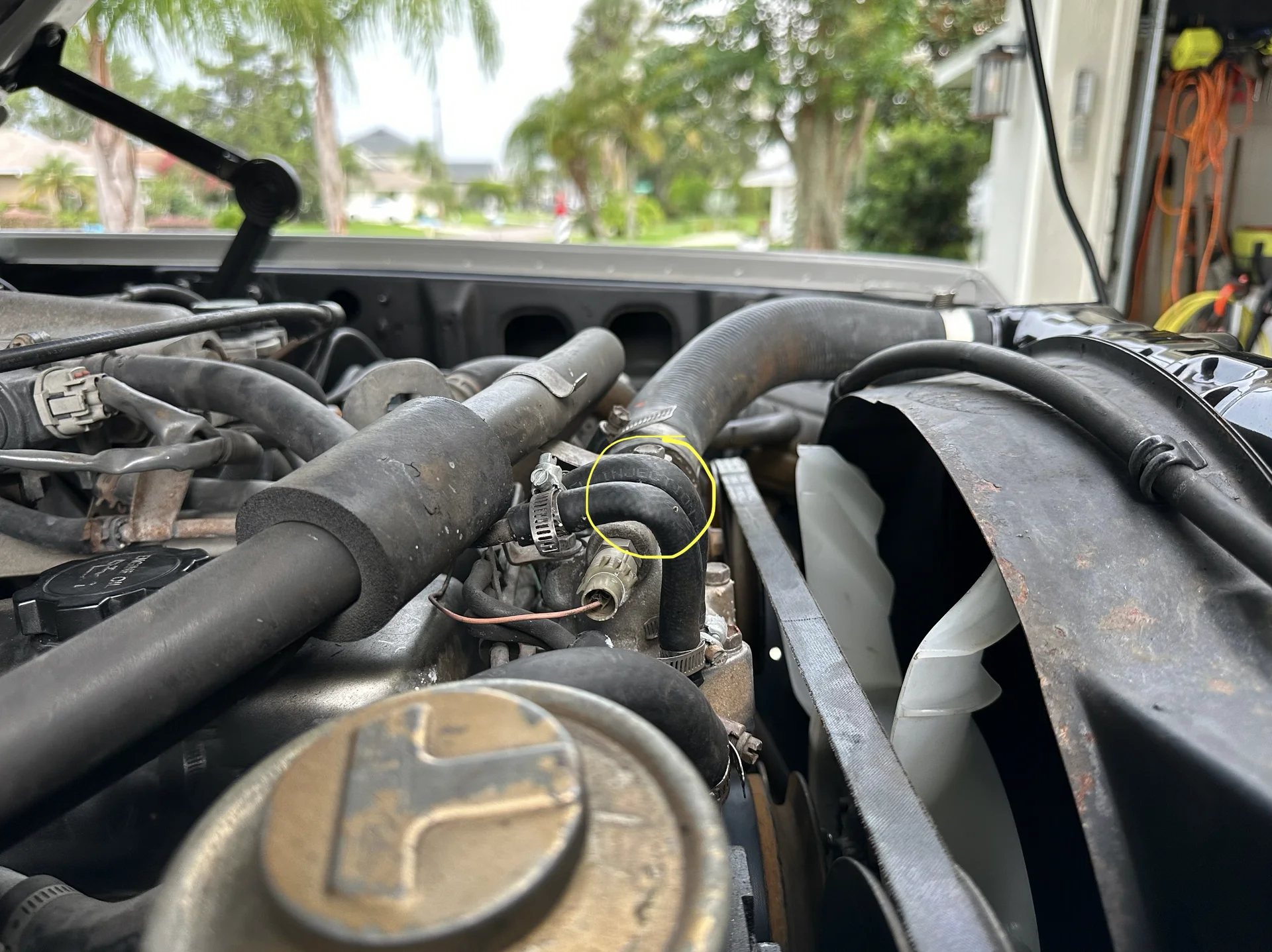

Now I am back to trouble shooting. I did notice these hoses pinching (attached photo) but they've been like this since I got the truck last year.

those 2 hoses should be formed hose, looks like that hose is just bent length of hose, those 2 hoses just go to the throttle body
