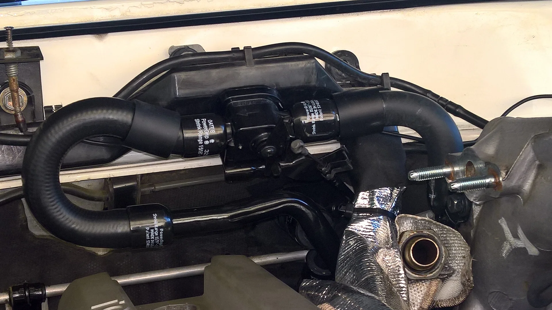

Most of the coolant/heating system clamps in my 97 model have been replaced (when I replaced all the hoses) with these heat shrink "clamps" and not one drop of leakage/seepage since. In a few locations, where I might need to access that area more frequently, I used OEM Toyota clamps.

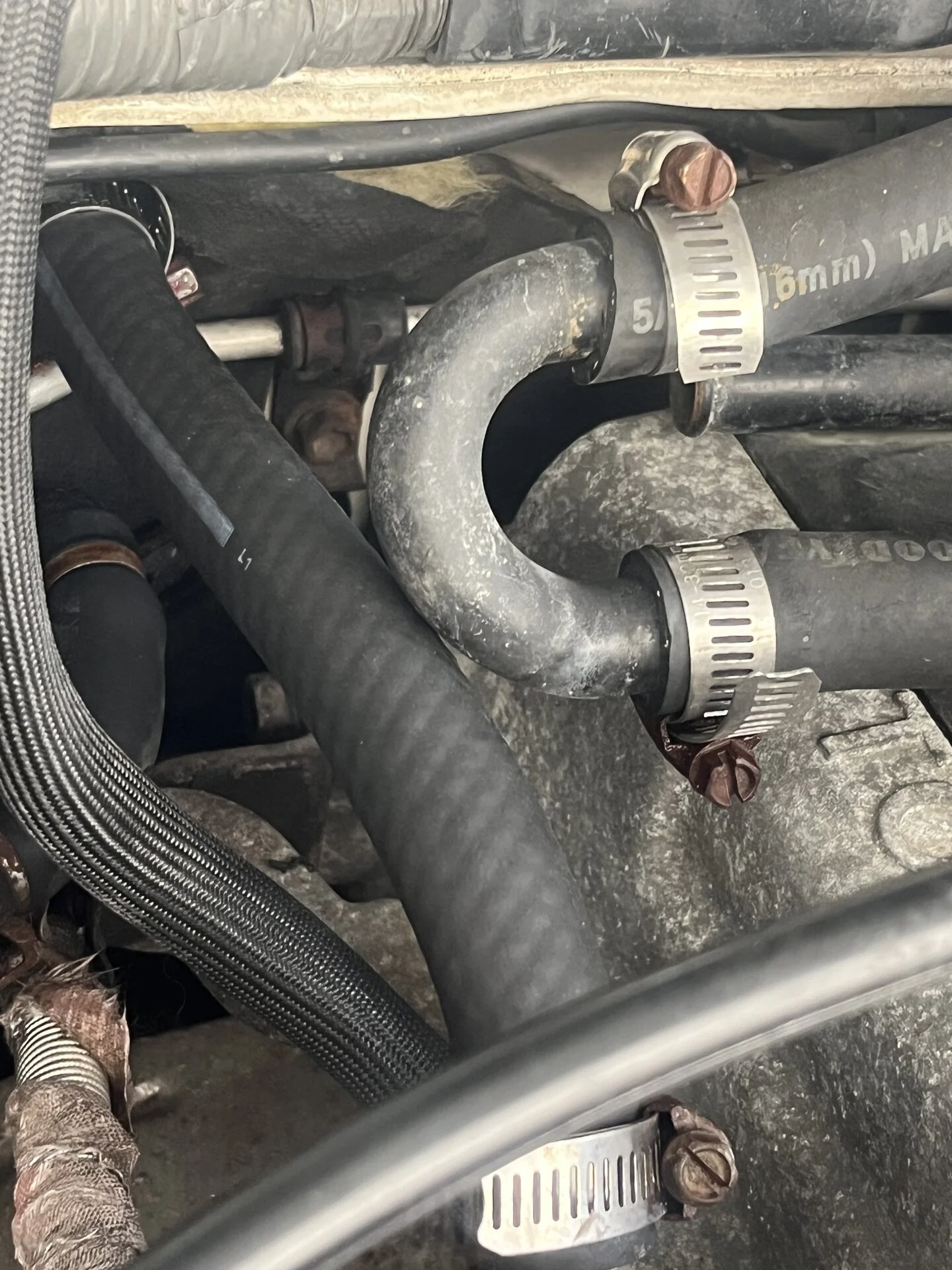

my rear heat is deleted. I do believe it is the same . It was dripping landing on the heat shield and drive shaft making a mess. Originally so minute I couldnt find it . The little piece of hose was compromised just enough to seep by the clamp. I had put a junction there. No clue if it was original bit of hose. Been years since I had done all that. Its like one of the first things I would do on and 80 series. Take 15 hoses down to 3. Then the unlocked low range mods
The top hose in the photo closest to the firewall is for the main/front heater core, is that the one you replaced? The bottom almost 90 degree formed hose is for the rear heater so it would be missing if you removed the rear heat.
Would help if you posted up photos of what you found and what you got now.
Sooo right against the firewall. That clamp was leaking dripping onto the ac line running over to the exhaust heat shield. You can see the hose bulging in the photo

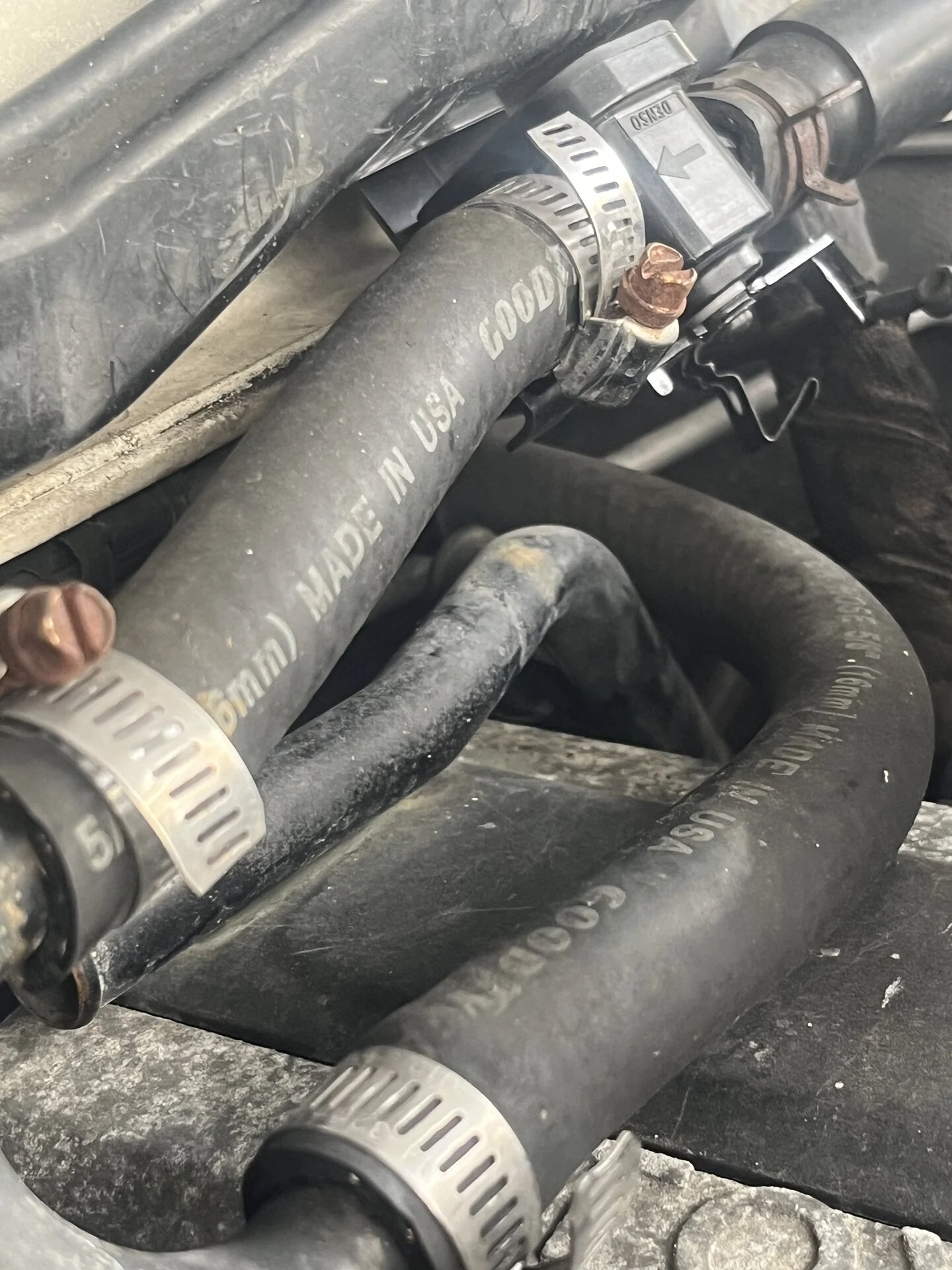

Here’s some photos. Mr T actually makes the cut & bent to fit hoses for the 80 without rear heat. That would take you to 2 hoses. I maintained the 90 degree pipe n used Napa or some other low budget hoses

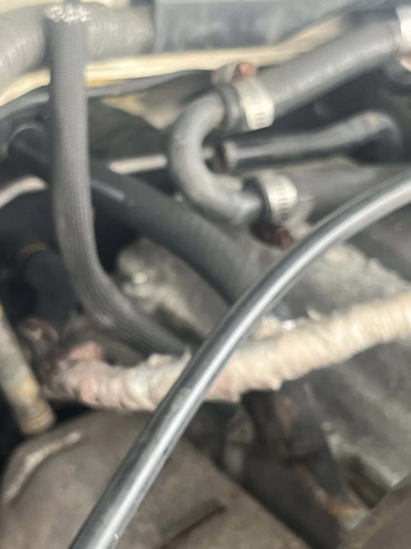

View attachment 3539881View attachment 3539880View attachment 3539879View attachment 3539879
Apparently, I need to be drinking more so I can focus better on those pics.
You're talking about hoses bulging and where they are. To me it's like driving around without my glasses......
I just cleaned off my glasses, no improvement. ;)
OK, so you disconnected the rear heater and left some of the pipes and hoses in place.
The worm screw clamps IME are quick and easy but they just don't work all that well with wide swings of weather temps. Cheaper bulk heater hose also just doesn't last as long IME compared to Gates Green Stripe. (So I don't sound like a clamp snob, my daily driver 80 has the worm screw clamps in a few places)
Either way, glad you figured it out.
