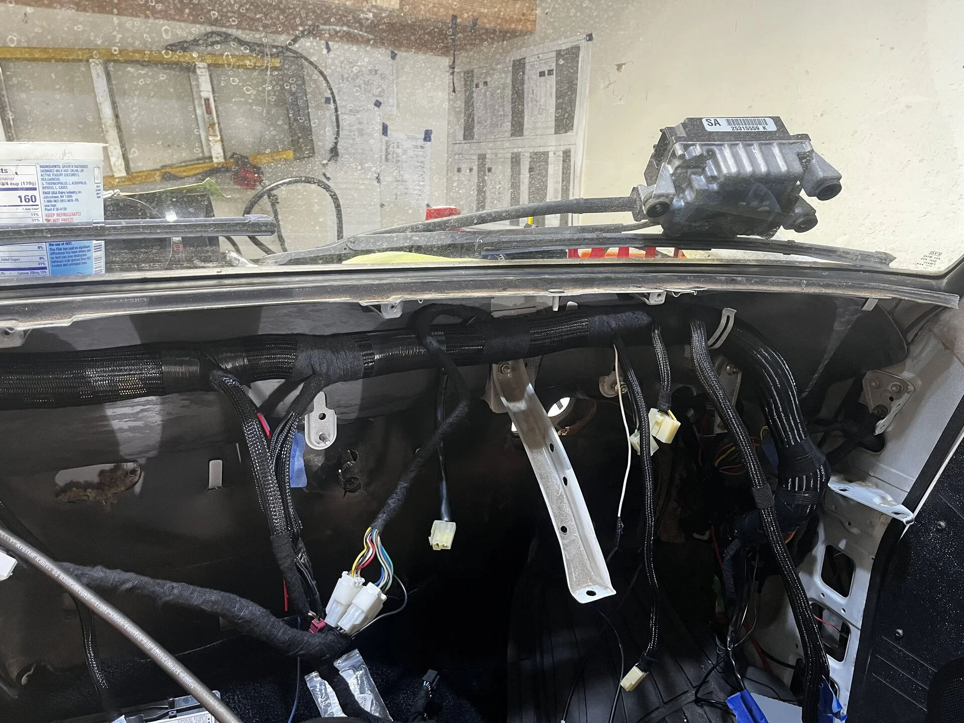

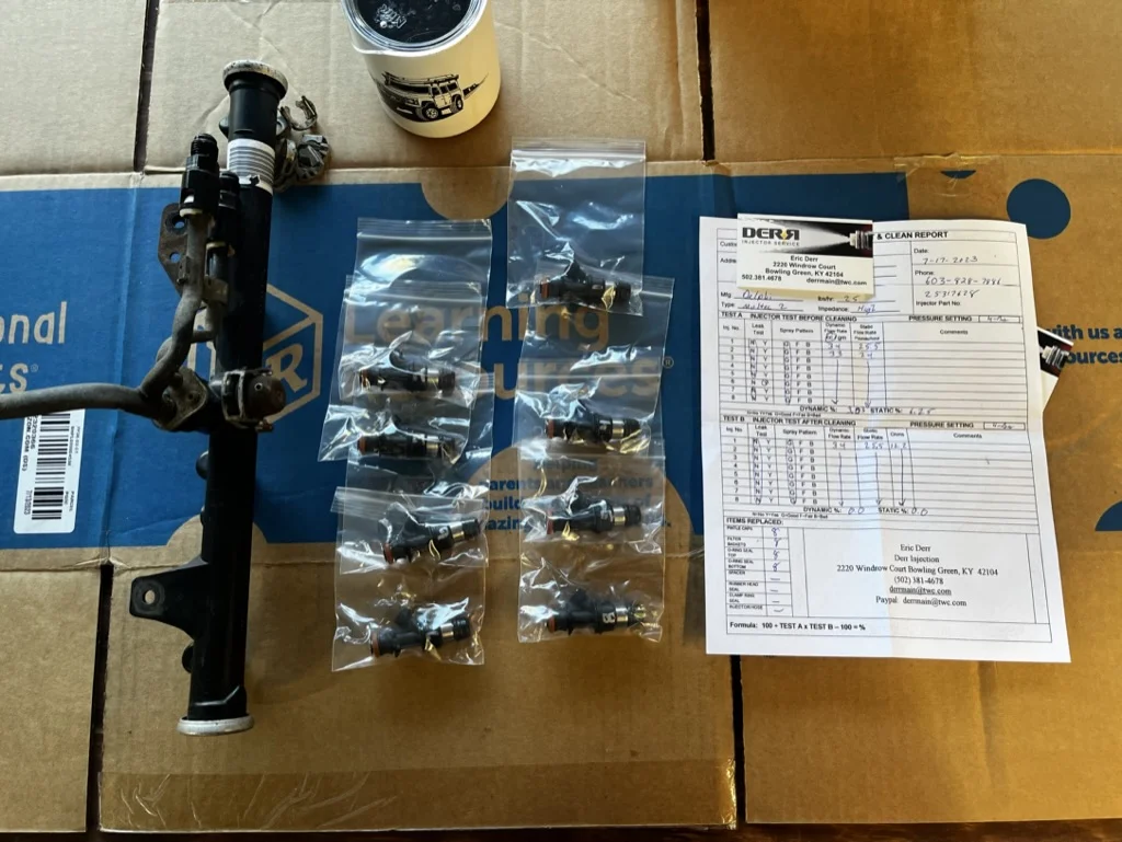

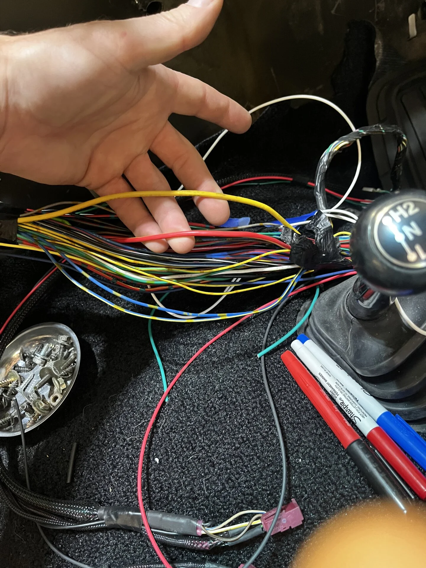

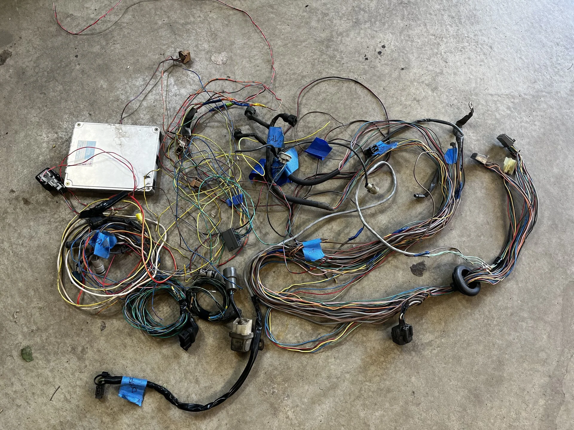

Sent my injectors off to Matt’s guy. While waiting for their return I am working on wiring. Have most of the 3FE EFI wiring removed or terminated. Trying to decide if I should leave the yellow EFI fusible link and large main relay power wires (red) in the truck or not.
Let me know if anyone needs any connectors. Where possible I pulled the entire section of wiring.

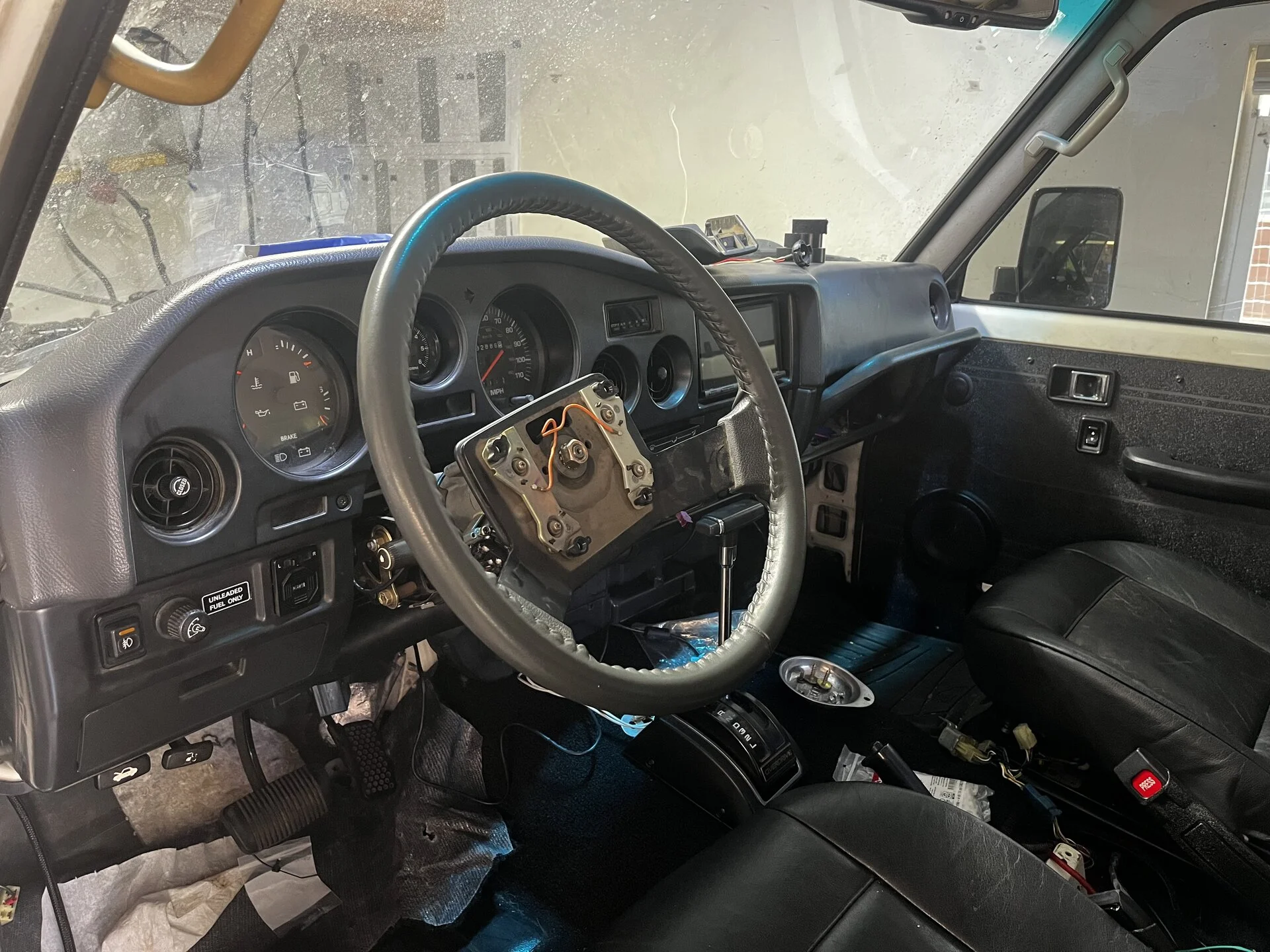

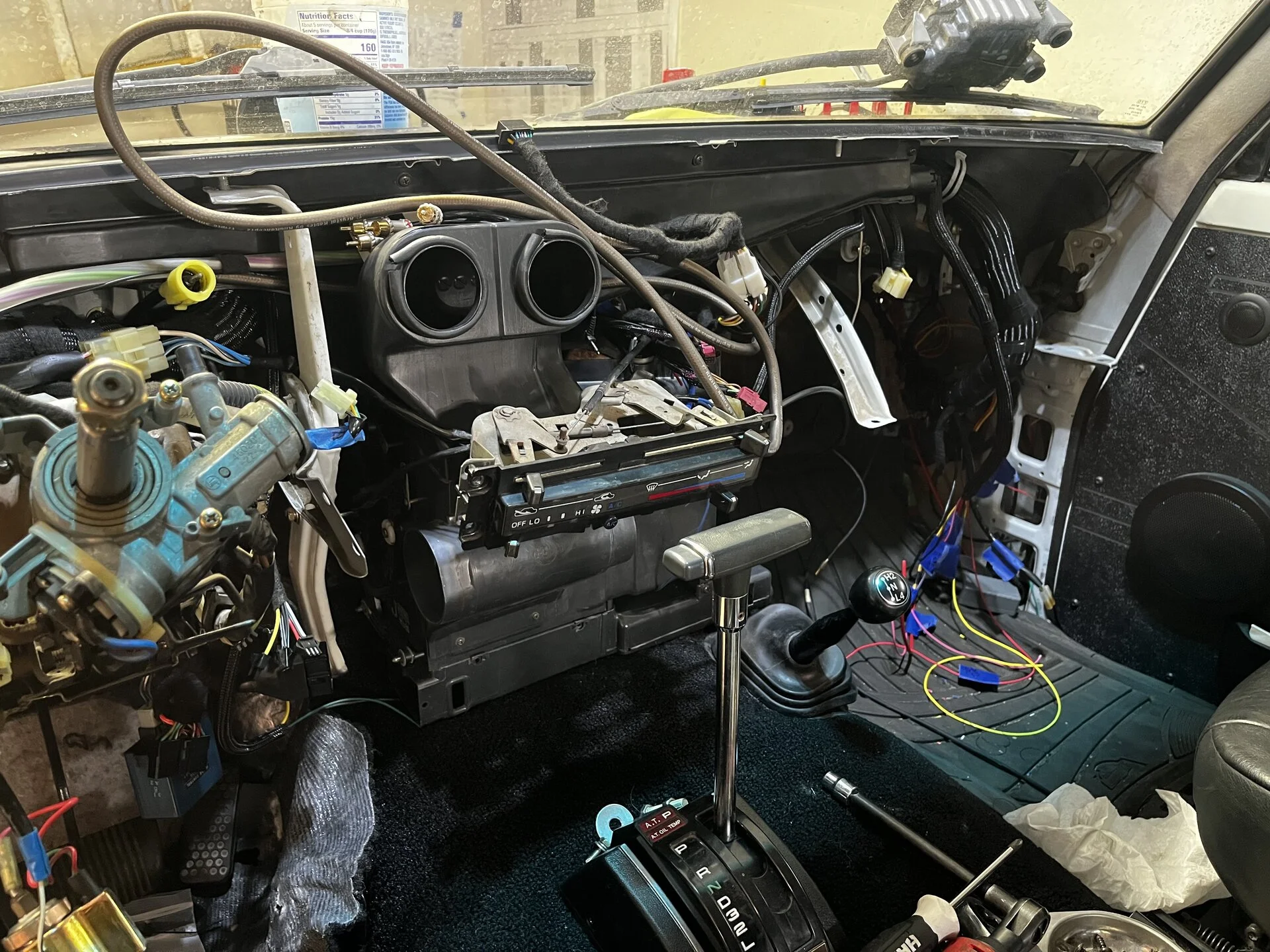

The list is getting shorter. Got the wiring cleaned up, hvac re-foamed and assembled, and dash back on.

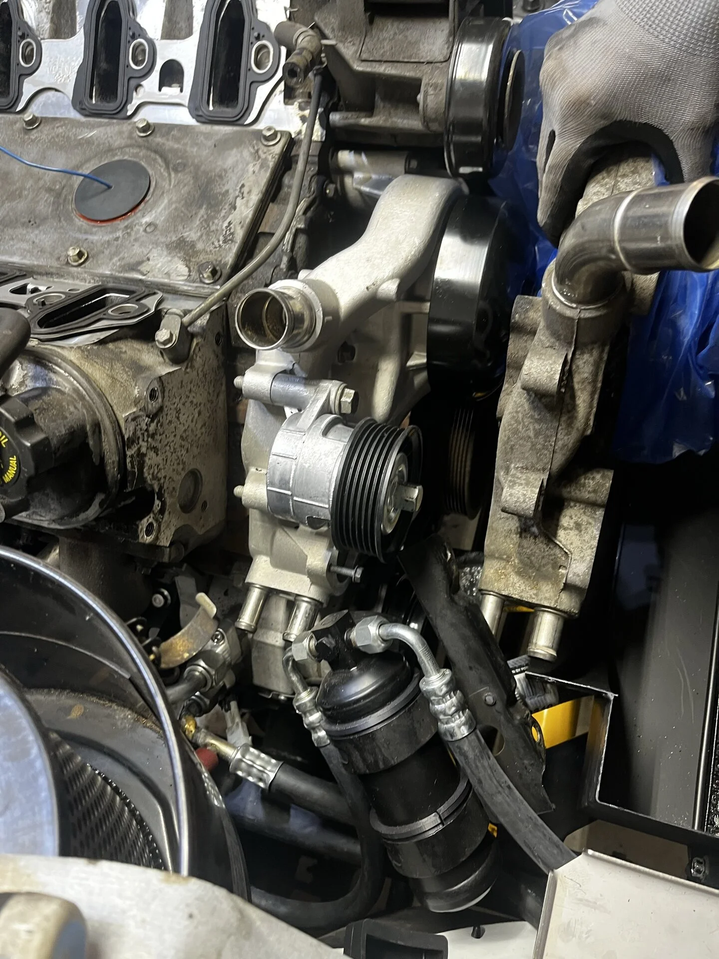

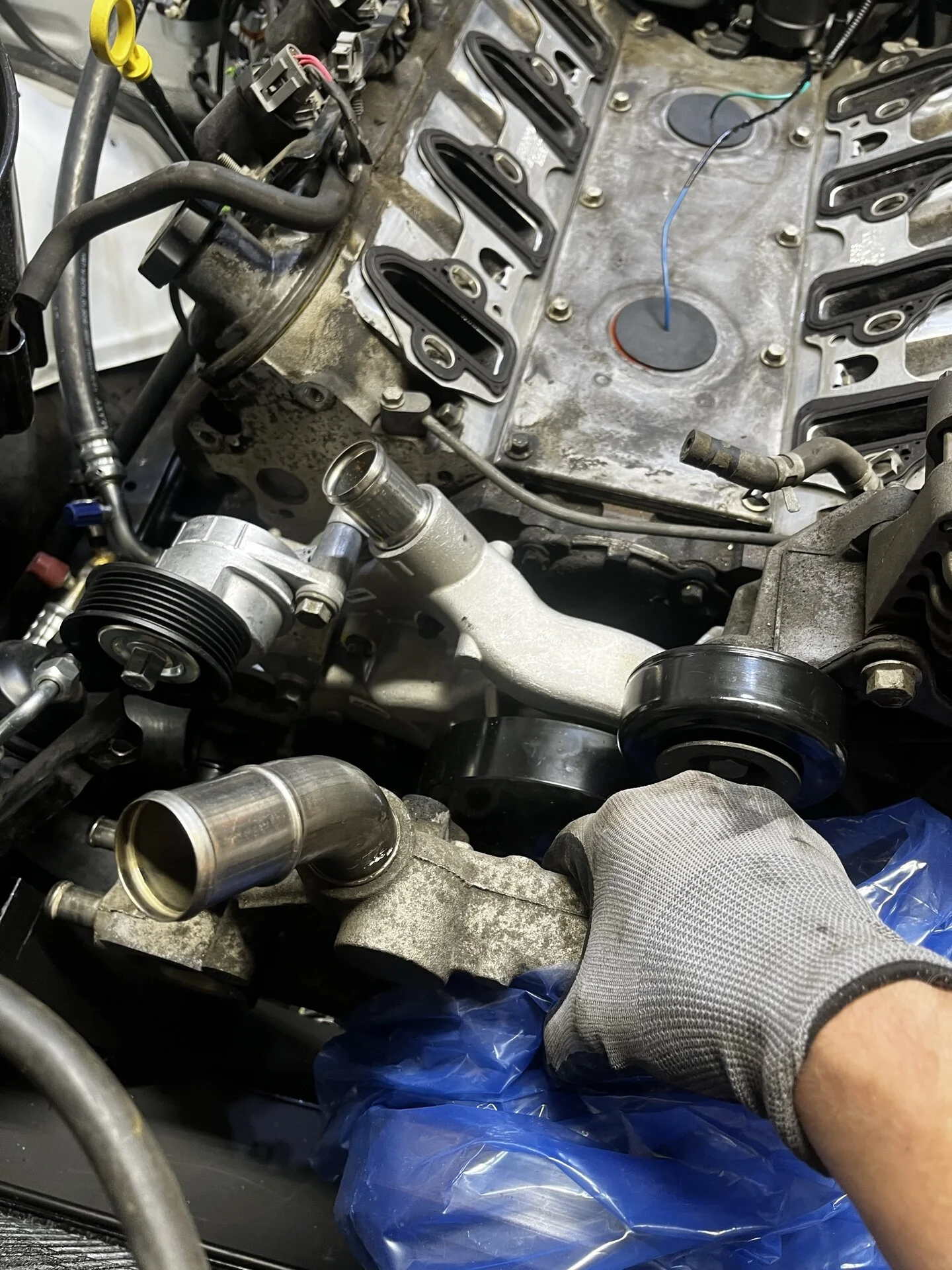

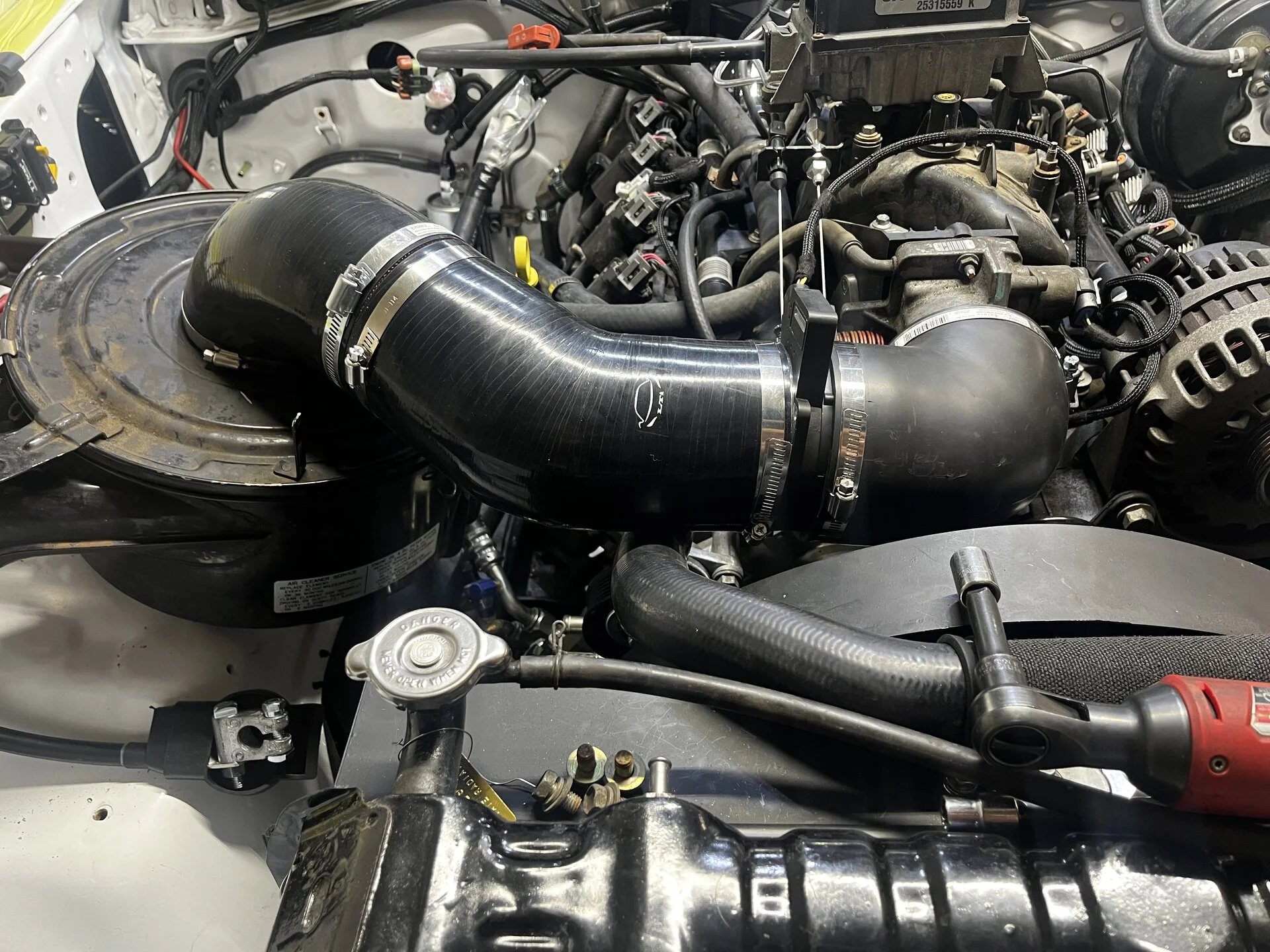

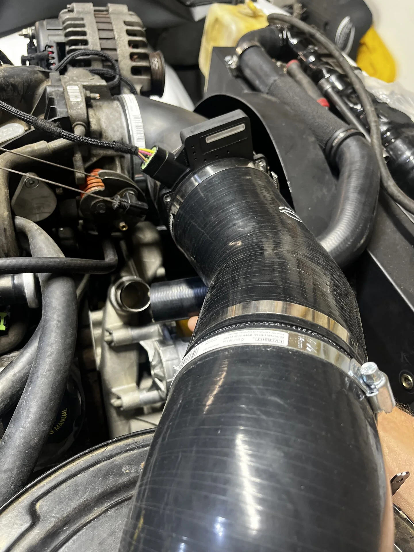

Also got intake pieced together, and swapped my water pump out with a Gen IV truck pump, which redirects the water outlet pipe towards the passenger side. Should have done this as PM before I put the motor in, but here we are. This version is much better for hose routing since I kept the mechanical fan. Waiting on a 1.25” hose barb to connect a 90 degree piece to my upper hose (you can see in last pic). Should be able to get coolant filled when that and a t-stat arrives.

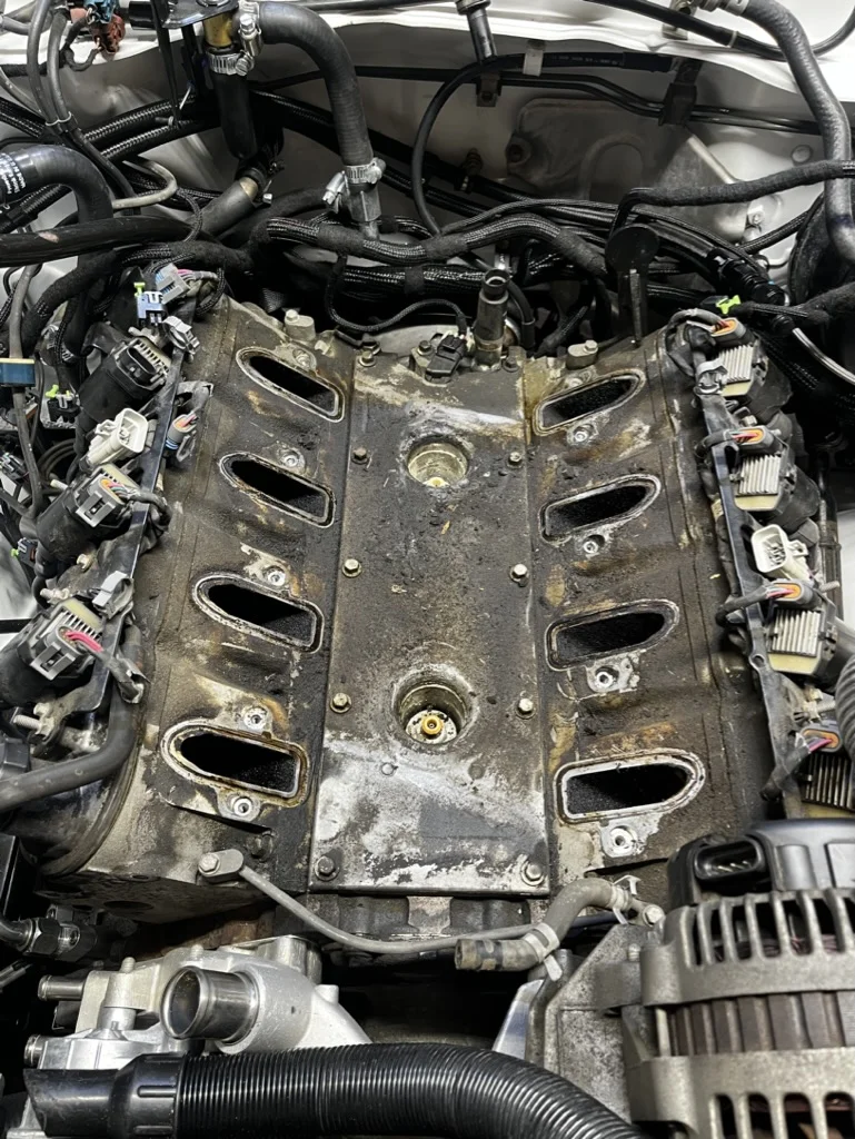

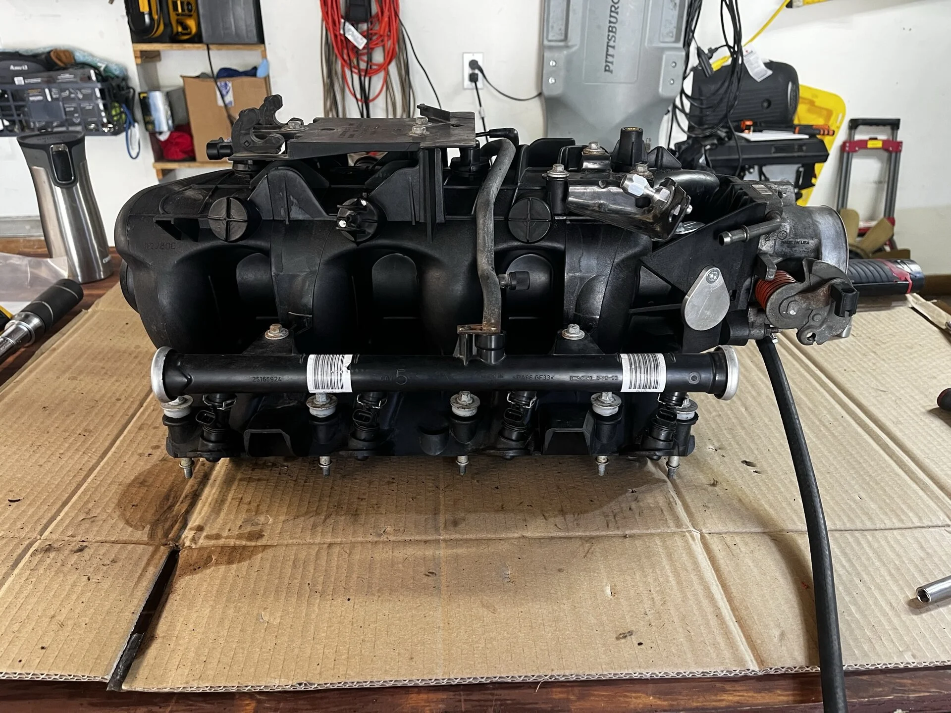

Also pulled the intake manifold off for a cleaning while I was waiting for the injectors. Pretty nasty under there. New knock sensors, harness, and manifold gasket.

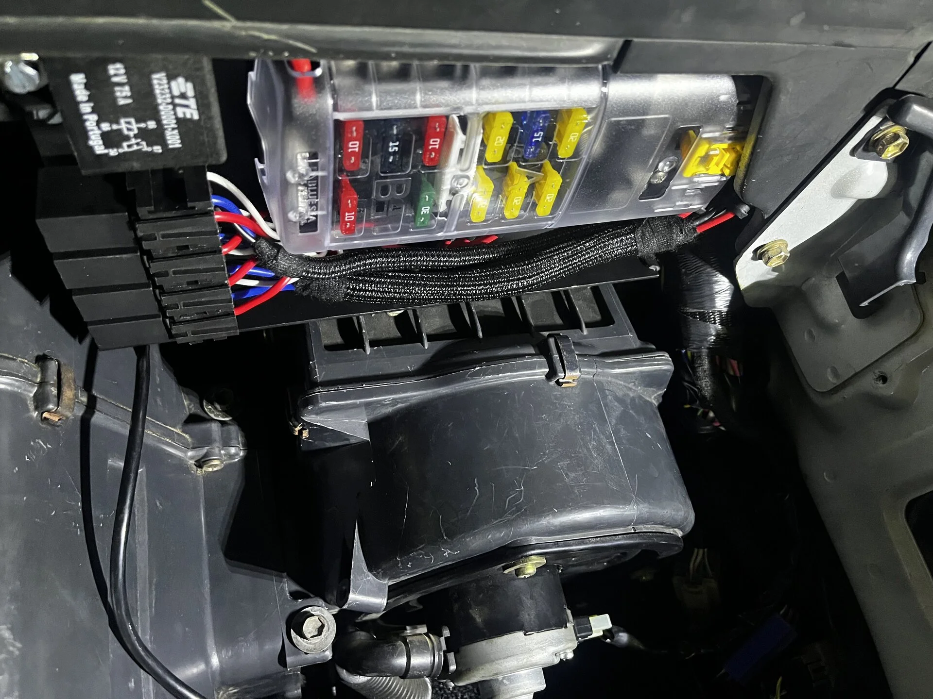

Need to get the rear heater back in place, finish the refurb of the combo switch stalks, wire in the aux fuse panel (@BurntToast I think I am going to blatantly copy your very slick setup, as it seems you know what you're doing with electrical). Also need to find a place to mount the relays for the cruise control switches.
Fuel injector guy's info is in pic. Quick turnaround, and very competitively priced.
Here is the difference between the two water pumps. Gen III (in hand) vs Gen IV. Both "truck" pumps.
hopefully the injectors fix your issue. And yes Eric is great
The only thing mine doesn’t have is local relays. I would have considered maybe a bussman panel if I needed that. Otherwise I think it should work fine!

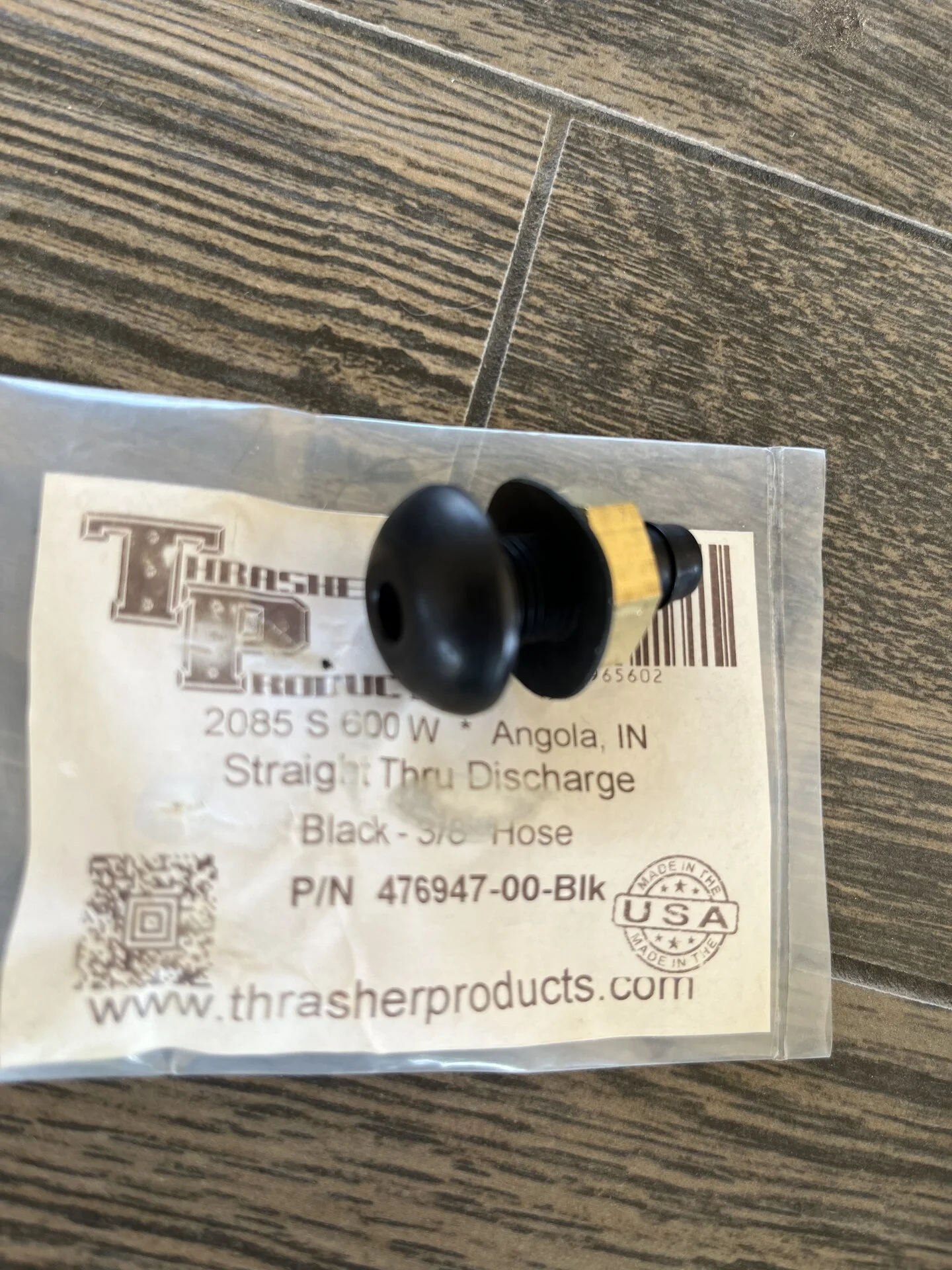

I’ve got a 3/8 hose that needs to get to intake. I’ve got this as an option to drill hole in one of the tubes/elbow but not sure if it’s best route.
Is there an unused port on the manifold that you can tap into? The vortec manifold has a few, so yours might. I had to tap into mine for the 4wd solenoids on my 62.
When we did the LS6 intake we had to put one of the hoses right into the intake. I welded a bung onto the intake tube itself. You could easily drill/tap one or similar

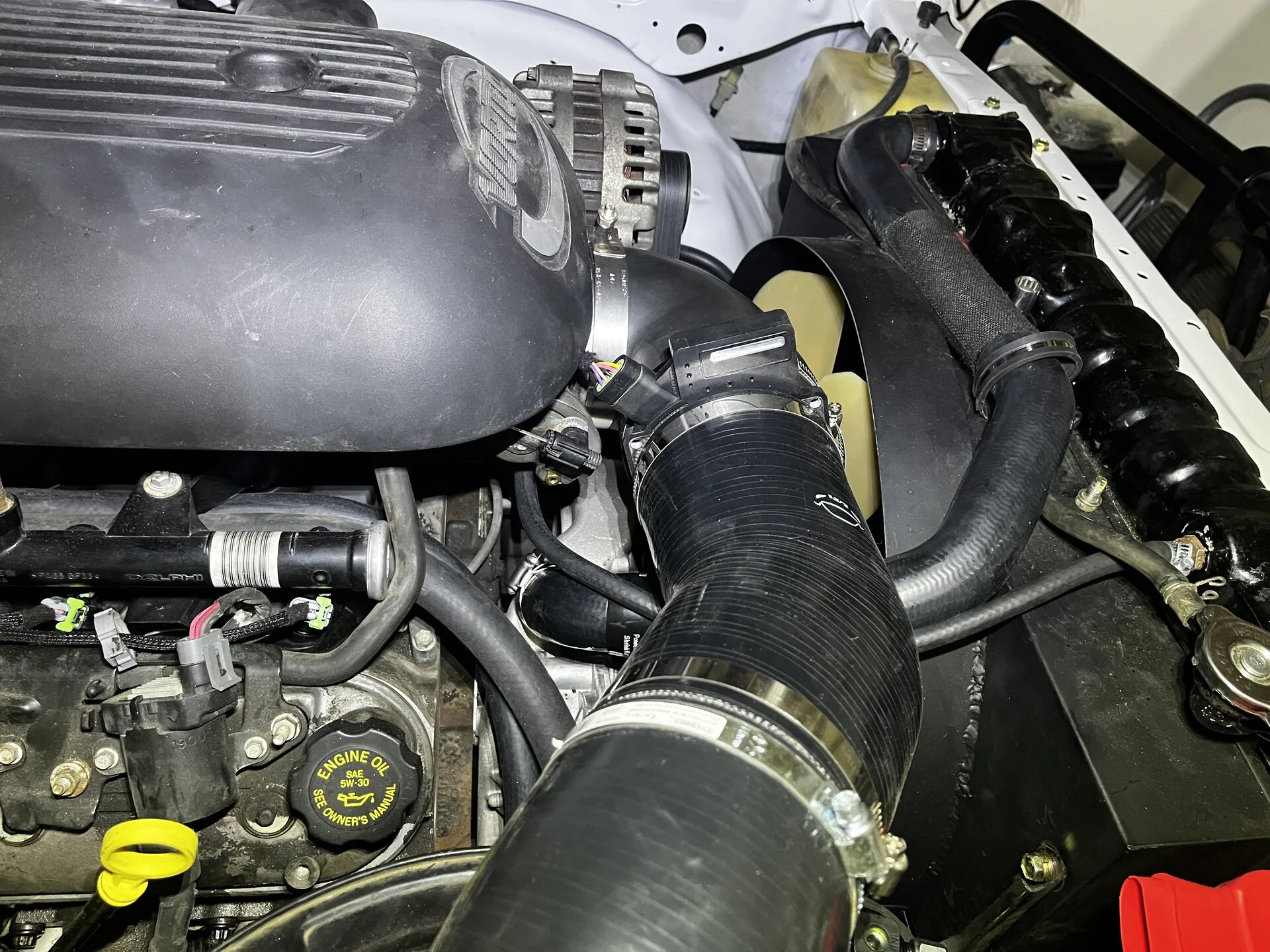

Got water pump outlet hose made up with two pieces of hose and a barb fitting.
Fits great underneath my intake piping.
Once that was finally done I filled the cooling system as best I could with the rear heater in-op. Adding that to the list.
And needed to turn the truck around in the garage so that I could get the passenger door open more than 10” to finish up the aux fuse panel. Copied @BurntToast idea with the relay and fuse panel, and added relays for ac and the three cruise control switches. Took that excuse to drive around the block. Loudly.
Going to need to move the fuse panel over since the way it is I can’t get the cover off when it is installed. Should have test fit that one.

Looks excellent! i had to grind that cover a bit too to get mine to fit
