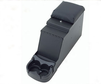

Thanks to Landcruiserjunky and his Smittybilt Console Review thread I purchased mine this week. (Amazon prime = free 2 day shipping and about $80 w/ tax)
In a rare occurrence I actually got off my butt after work and got it installed tonight! (Truly a minor miracle as most projects go about the speed of molasses uphill in the winter...)
Since my 84 is in stasis in the garage I figured I could grab my Tuffy to compare side by side w/ the Smittybilt console...
And I didn't dust off the tuffy so sue me...
Here they are side by side
A bit dusty i know...
Side Shot - Smitty w/o the back bottom piece
Hardware that came w/ the Smitty

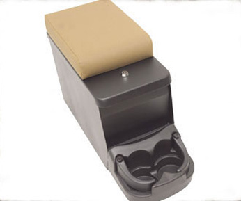

Tuffy is about 24.5" long
Smitty is about 26.5" long
Smitty is 8" wide
Tuffy 7 3/4" wide
Both are 16" tall off back leg, and 12 tall from base:
Smitty opening
Tuffy opening
OK - now we see what i like one over the other:
LOCK! This thing is beefy on the Tuffy
Vs the Smitty's lock...
IMO there really is no comparison... The tuffy has a solid, protected lock vs what i'd expect in my office desk (latch wise) in the Smitty.
Tuffy has a nice push down release with standard key (won't push down when locked)
Smitty has a more pick resistant, but simple turn to lock w/ no release (rattle or bouncy?)
Hinges (dusty is Tuffy)
Both open interiors
Smitty
Tuffy
For my spare truck the Smitty looks fantastic (was going to do the ammo can console) and chose the smitty on price and that it locked.
I still prefer the Tuffy due to easier fitment, better latch/lock.
I haven't tried the cup holders in the Smitty - so can't yet compare with the simple ones on the Tuffy.
What i like on the Smitty is the a) Price, b) Price, c) Taller cushion, and *maybe* the cup holders... we'll see.

I bit the bullet a few years ago and bought the Tuffy center consul. Yes it was expensive ! But I've never looked back as it was a mistake . One thing I was not so keen on was the Mounting system that tuffy provided. If installed as per instuctions you have to remove the OEM brackets and install the Tuffy bracket which bolt thru the floor of the vehicle . i was not prepared to do this ,wanting to keep the stock mounting. I measured and drilled several 6mm holes in the bottom of the Tuffy so it would attach to the OEM bracket . Although not as secure as bolting thru the floor pan . it is a much cleaner install . so we have all heard before ...." make sure you get what you pay for" with the Tuffy you do get what you pay for. A tough little box with a bombproof lock.
It's tough to compare these two and not see how nice the Smitty is... It looks, feels, and measures up against the Tuffy on almost every aspect... at 1/3 to 1/4 the price $$$!
I think the Tuffy may be a bit thicker steel (very marginal) as it seems to weight quite a bit more - at least noticeable while moving them around. My Tuffy has a CD Deck in the pocket, otherwise they should weigh the same, and i don't imagine the CD player weighs all that much.
Pro's and Con's of the locks - I like the latch and positive feel of the Tuffy lock. Though a simpler key I think it's probably better since i can get another cut anywhere - vs the cylinder key (or whatever they are called). The Smitty probably is more "pick" resistant, but honestly if they can pick a lock they are already not the guy i'm trying to keep out. Meth douchebags and joy ride kids...
Neither console is really likely to stop them from smashing a window and getting the change in the ashtray - but i might still have my stereo afterward. hopefully with the CD player out of sight and a locking center console they will just look for easier and more lucrative targets. Here's hoping...

The Smitty really looks to be nearly a clone of the Tuffy w/ taller pad, a different cup holder, and a bit less secure lock/latch. Small things like the adhesive weatherstrip being a bit cheasy compared to the Tuffy's rubber "gasket" type... etc.

Thanks for the nice comparison. For my $$, I bought the Smitty. The only real drawback to me was the smaller locking mechanism but I figured that a determined criminal is going to use a prybar on either one and eventually get in if he really has the time anyway. IMO, the average hoodlum breaks into the truck (easy as we all know), sees that the console is locked, tries to open it for about 30 seconds and then moves on to easier pickings. Both stand up to this test. The informed criminal is taking your whole truck, not just the few valuables crammed into the console.

One other bonus for the Tuffy is the fact that you can change the key to match other things. For example, in my CJ I had a rear locking trunk and bought the Center Console, then changed the lock to match. Very convenient to have one key work multiple things.
I also liked how the Tuffy cup holders fit a "soda and cozy" perfect.
Open top rig, get a Tuffy, you'll sleep better knowing that lock is very hard to get into. But for the price and in a 60, Smitty wins.
