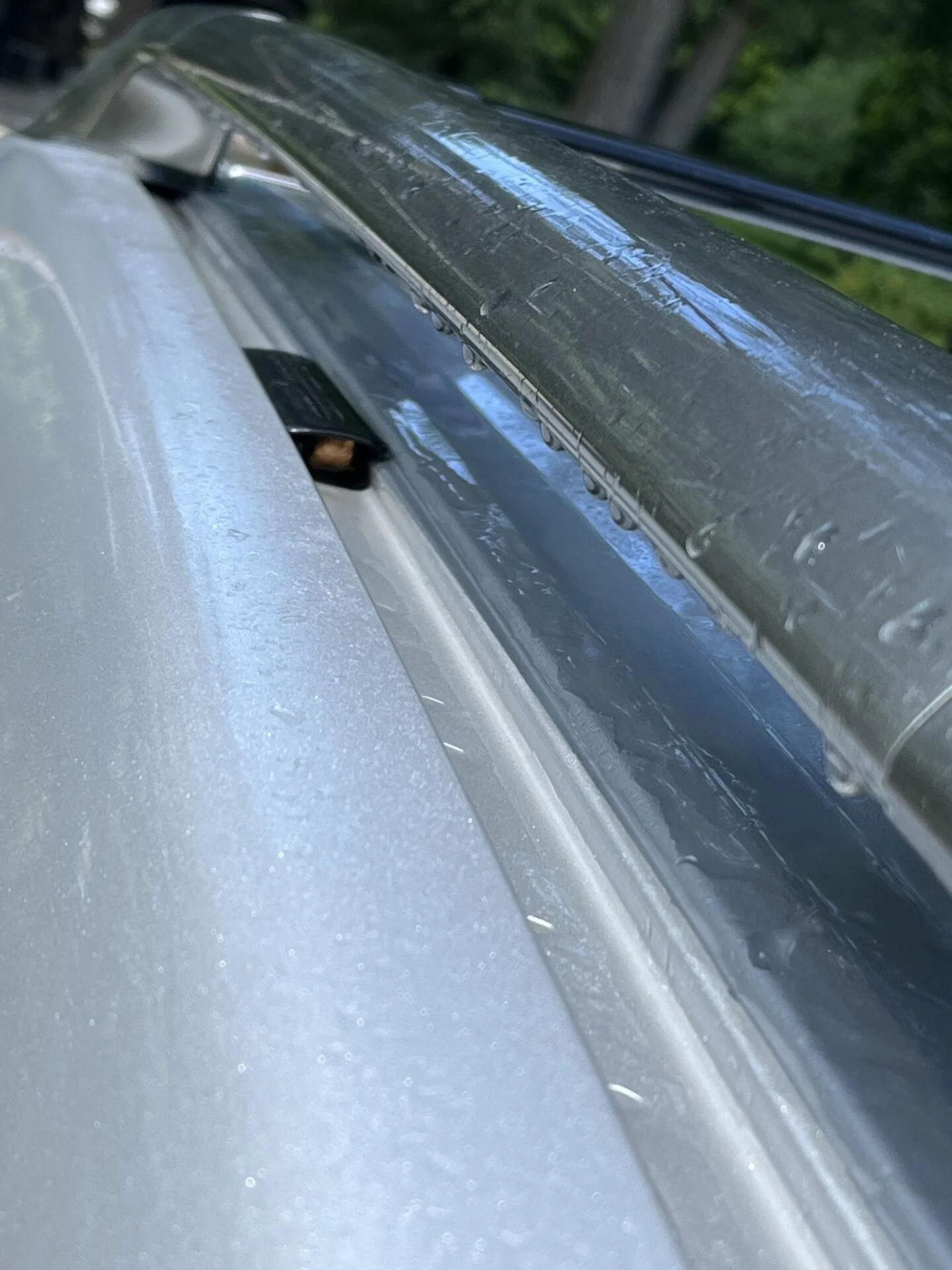

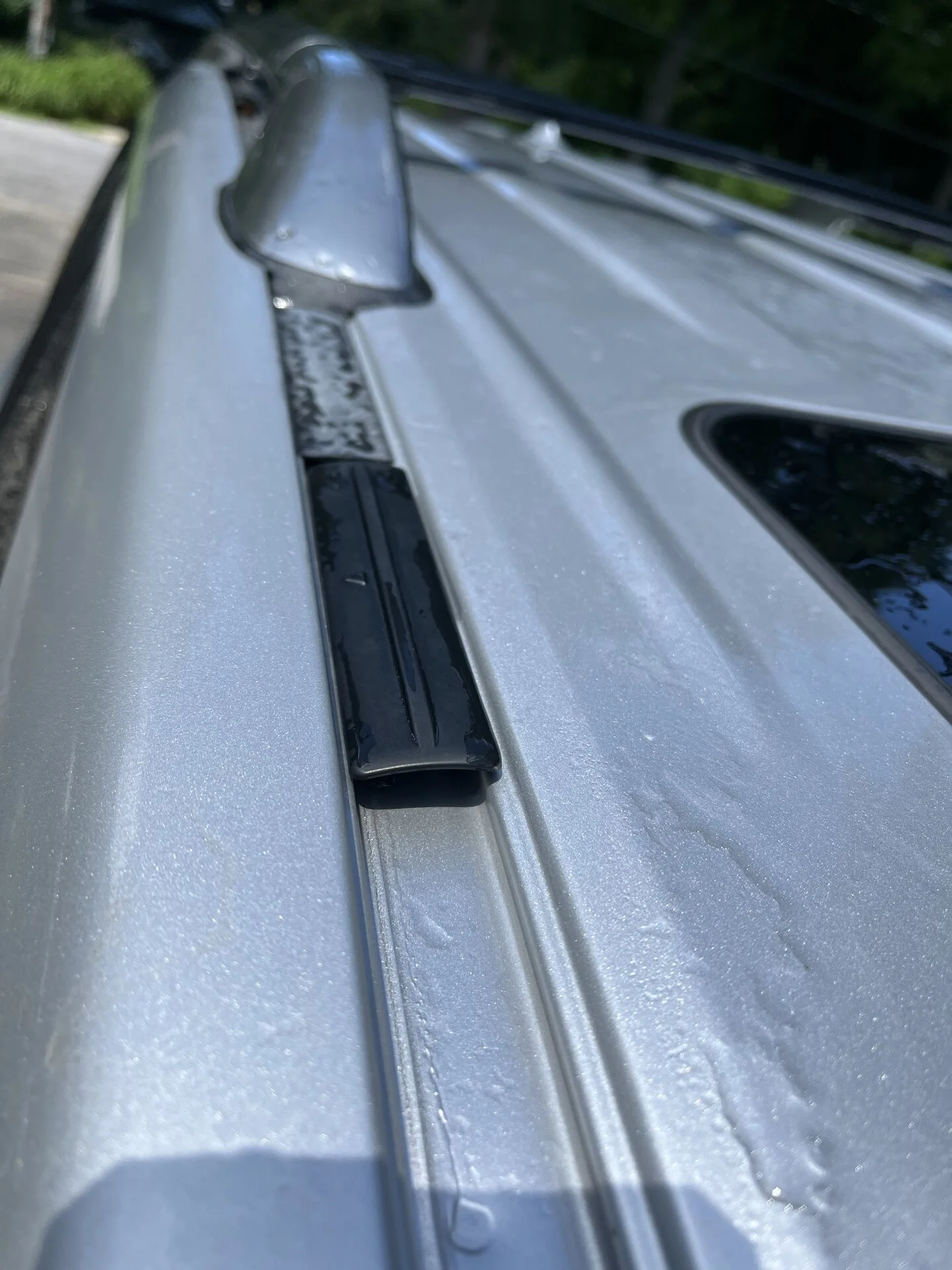

I need help from the brain trust!! Should I go with 285/50 or 285/60? And what is going on with my roof rails….are these all the pieces or am I missing some, does it matter?
Thank you in advance
