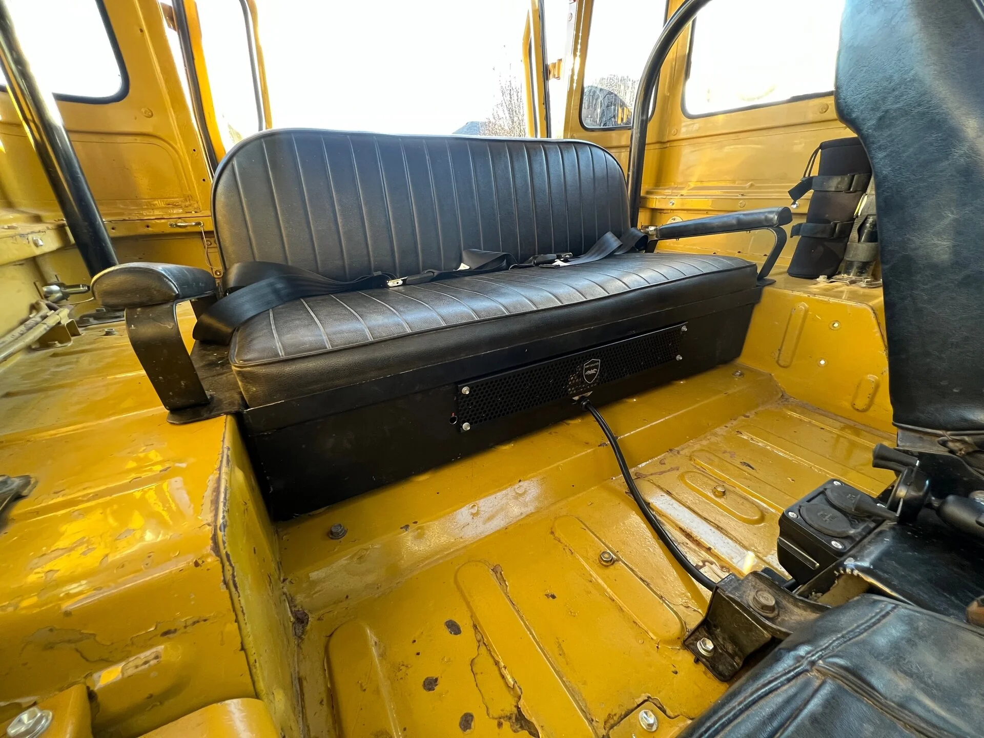

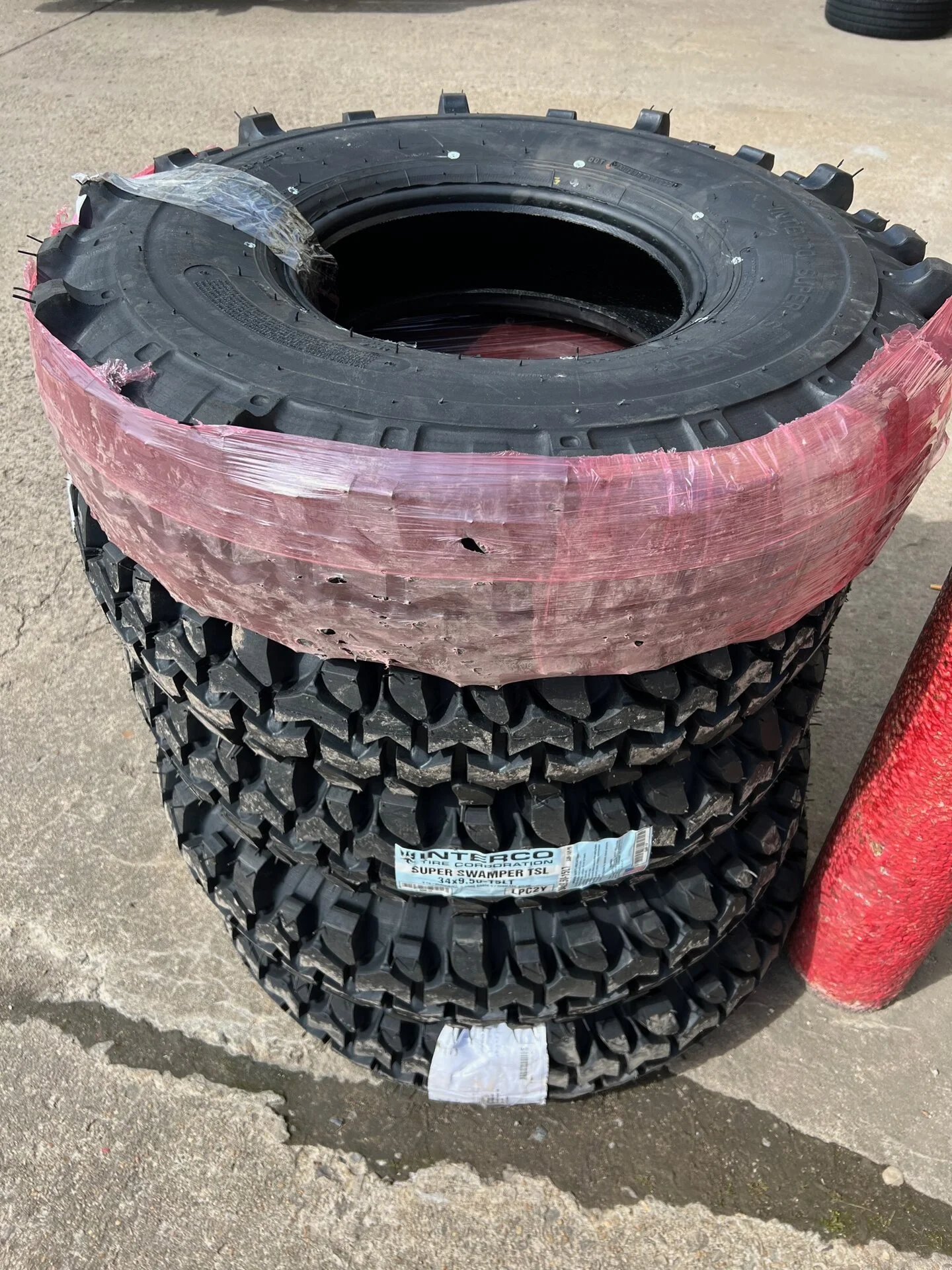

havnt posted on this thread in a while. been driving the heck out of mustard, it is a great driver. the brake mods i did are amazing, suspension is great. have only been doing routine maintenance and upkeep. i have have plans very soon to pull the transmission and do a clutch job, all parts are on hand. ill do the RMS while im in there and reseal the tranny and tcase. anyways i did end up with some new tires this week. im a fan of tall and narrow, suits my hobbies well. i also moved my sound bar inside of the conferr bench. its out of the way and works well, looks cleaner than mounted to the rollbar also. also notice i was able to snag an oem fuel can for the oem jerry can rack on the back woot woot.
I thought all Swampers were made in the 1990s and just resold on Marketplace over and over

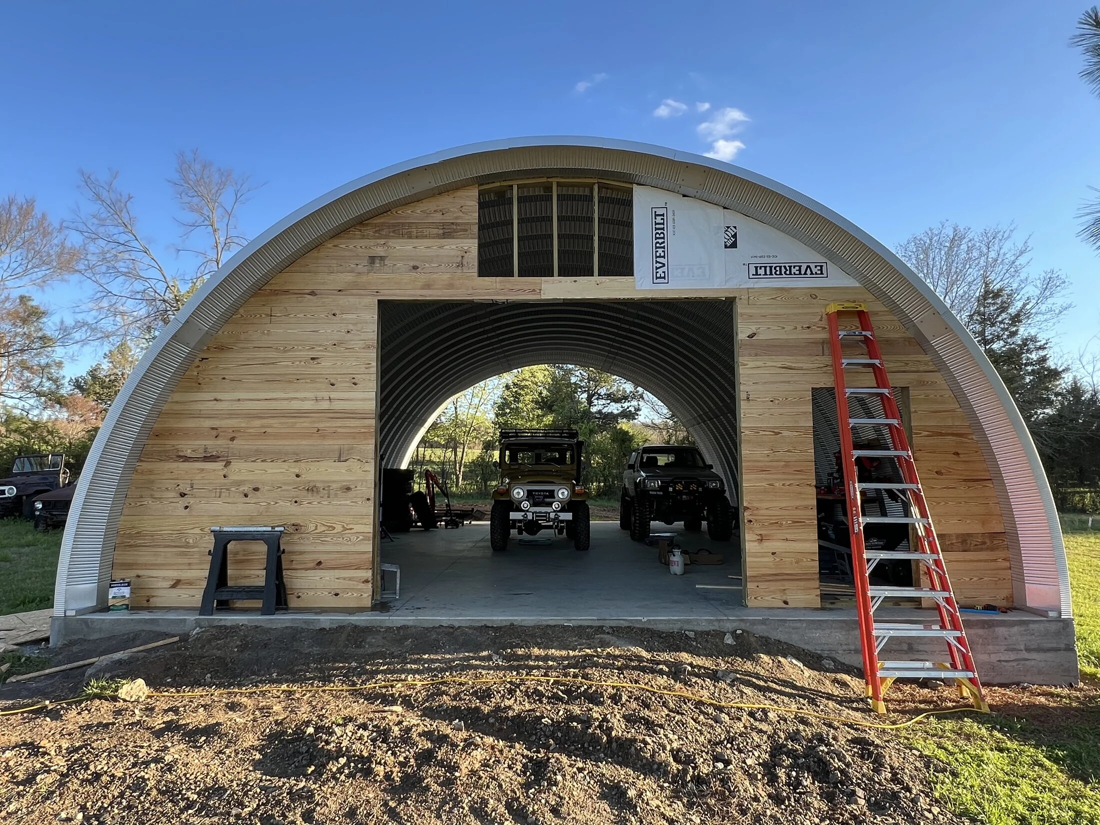

I’ve been a little stale on the site lately but I have started construction on my shop. We bought a house last year, and a shop was high on my list. One piece at a time but it’s coming along. Work on the rigs has been slow.
