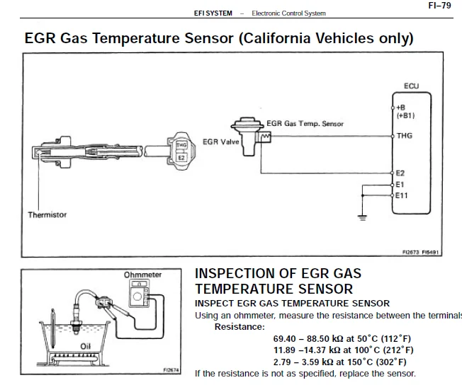

What is the correct resistance of the EGR temp sensor when cold? I get 0.24 megs. It was a split year, mine appears to be the early one. Toyota # 8941250010.
I did the diagnostic flow chart. California model. The VSVs , EGR valve, EGR vaccum modulator, all check out.
Well there you go. Mine is messed up. I ordered another one at a chain parts store. I will check theirs before I install it.
Mine was not messed up. The new one track exactly the same as the old one. The resistance at 50C and 100C are spot the specs on for both old and new.
Is there any point is using the new sensor?
