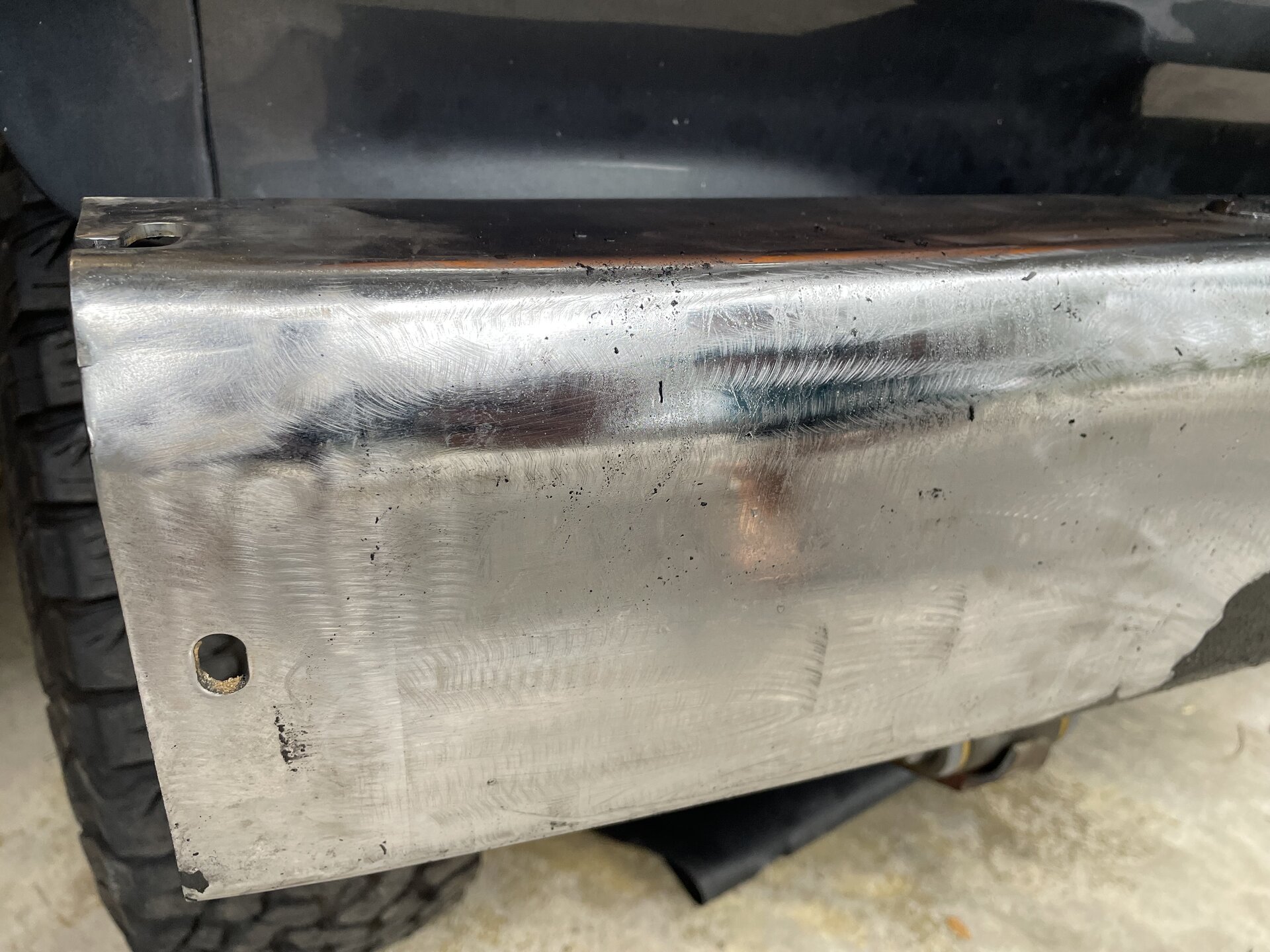

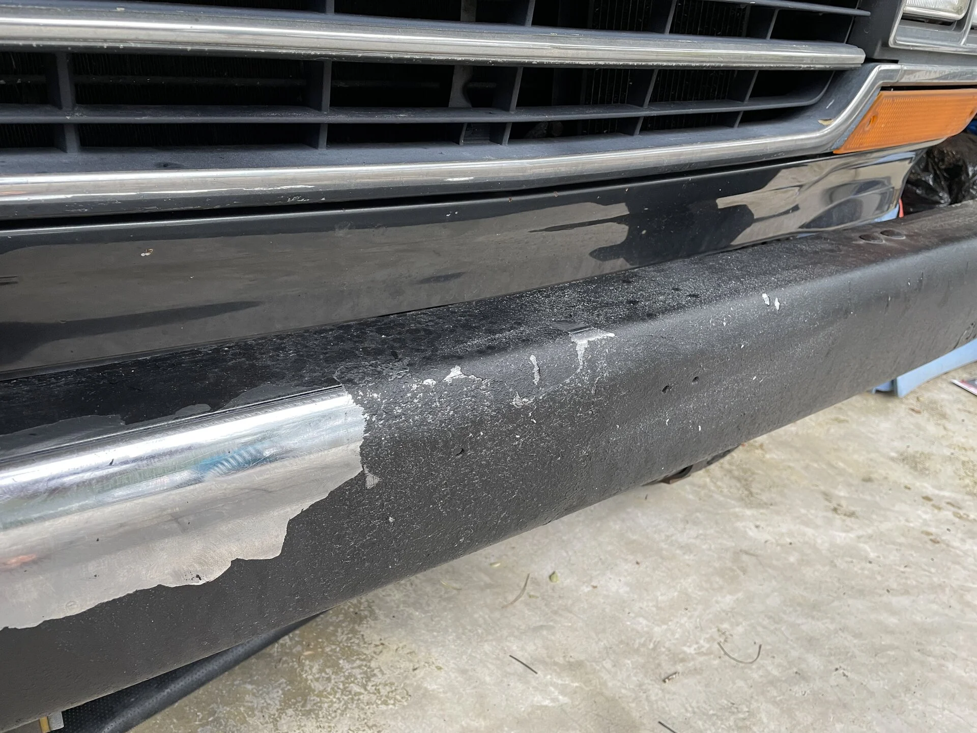

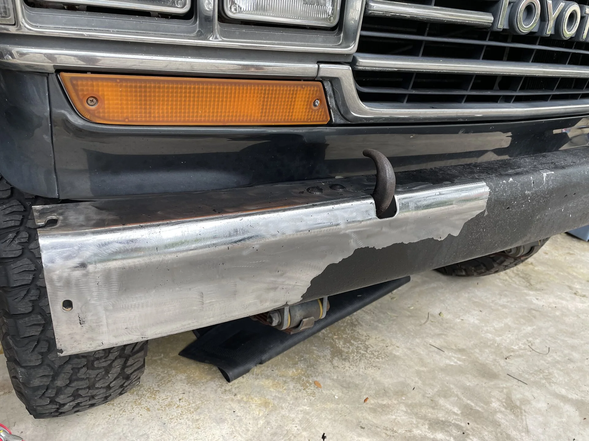

My new to me FJ62 has some sort of coating on the front and rear bumpers. I have started the process of removing it (WD40 or goo gone seems to work best), but it’s a slow process.
What I’m finding however is the metal below the coating does not appear to be chrome. Or maybe it was but someone hit it with a grinding disk or wire wheel. It almost looks more like a polished metal rather than chrome.
What do y’all think, can it be polished out and left like that, or better to just coat it again with something like plasti-dip or bed liner?
Looks like someone scuffed it to improve adhesion for the coating. I don't know much about polishing chrome, but given that the chrome has already been scuffed, you might as well save yourself some time and hit the remaining coating with a knotted wire wheel. It shouldn't put up too much resistance.
Remove the old stuff and apply some new stuff. The original old chrome is a goner.
If it’s coming off with WD 40 it’s likely plastidip that’s on there right now. Bed liner would be more robust or get it powdercoated if you want them black. Or call A local plating shop for a rechrome quote
