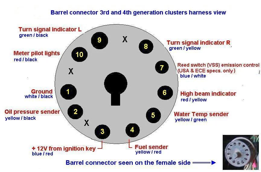

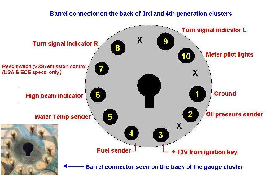

Rudi, please note in the pictures of post #130 & #131 where it says 12V from ignition, there is nothing there. No pin, no wire in the plug. I'm confused how the 12V gets to the cluster. Thanks.
barrel connector on the back of the gauge cluster
I had a question from a fellow MUD member today about the pin numbers. The FSM is not 100% clear were pin3 (+12V from ign. key) is.
Here is the barrel connector for 3rd and 4th generation clusters in addition to the FSM.
Rudi

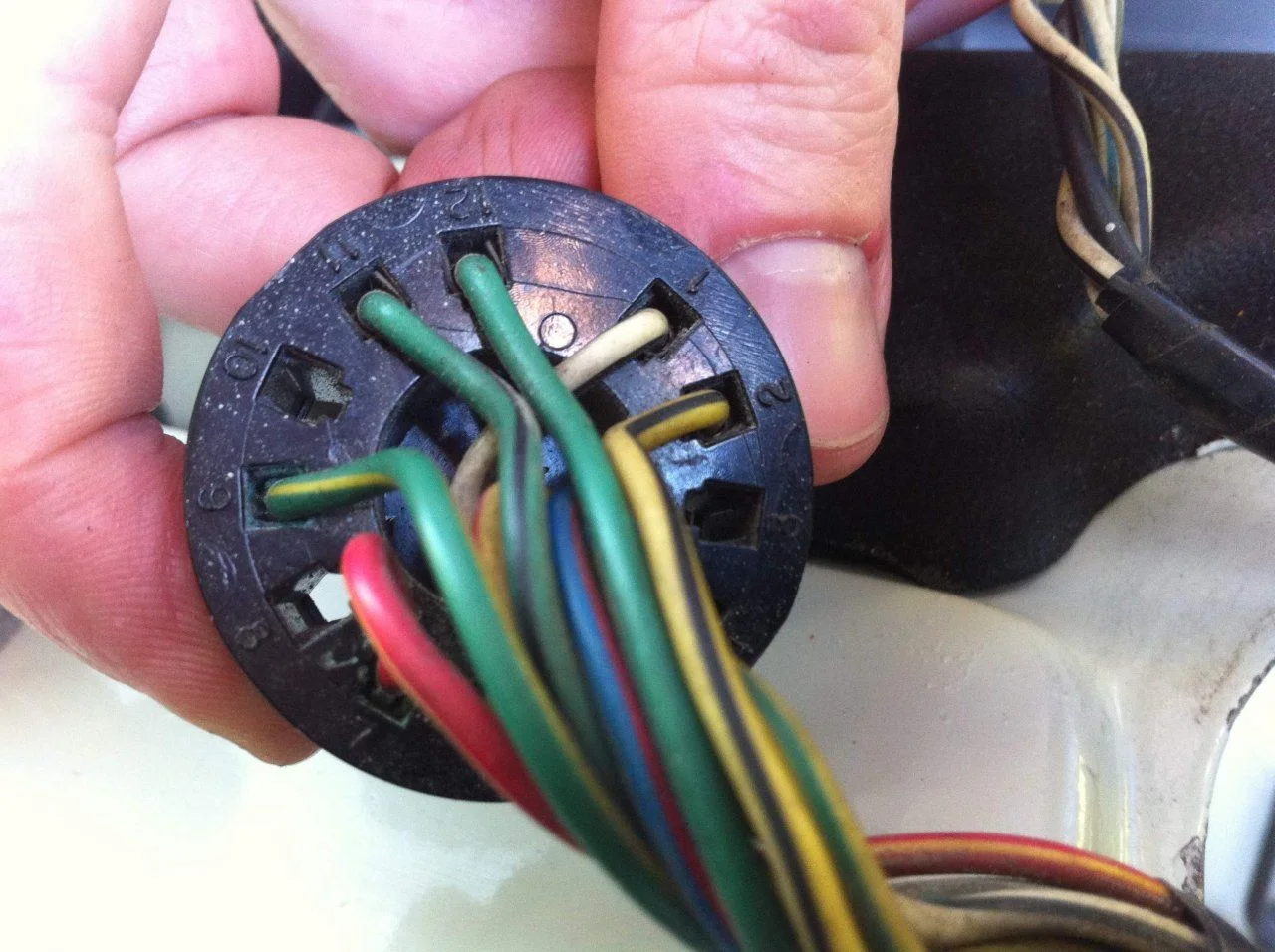

I think the confusion is that the plug on the harness is labeled 1 thru 12 with two locations not used (#3 & #10). Then they omit those numbers and end up identifying ten positions, e.g. #4 is Fuel Sender but it is #5 on the plastic plug.
Good, you figured it out!
The numbers on the connector don't match the numbers mentioned in the FSM, so I followed the numbers from the FSM.
Rudi
Rudi, I just used your diagrams to create a sub-harness that adapted a late model gauge cluster to a 72 harness. I too was confused by the labeling. Don't know why Toyota skipped the numbers. In my world of process control, when documenting a circuit, you NEVER skip numbers in a connector. It confuses people! :D

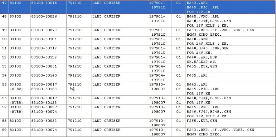

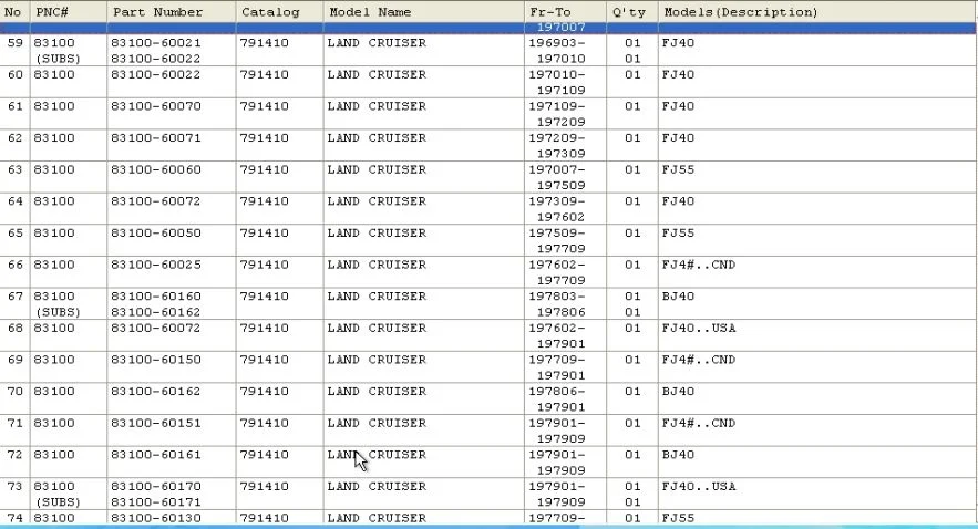

FYI, Here are the part numbers for clusters used in the USA Market.
See next posting

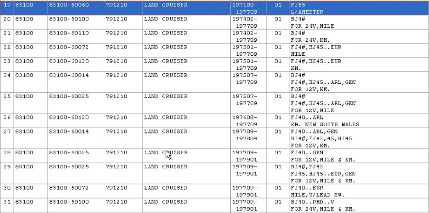

And here are the part numbers for the General Market:
Rudi
