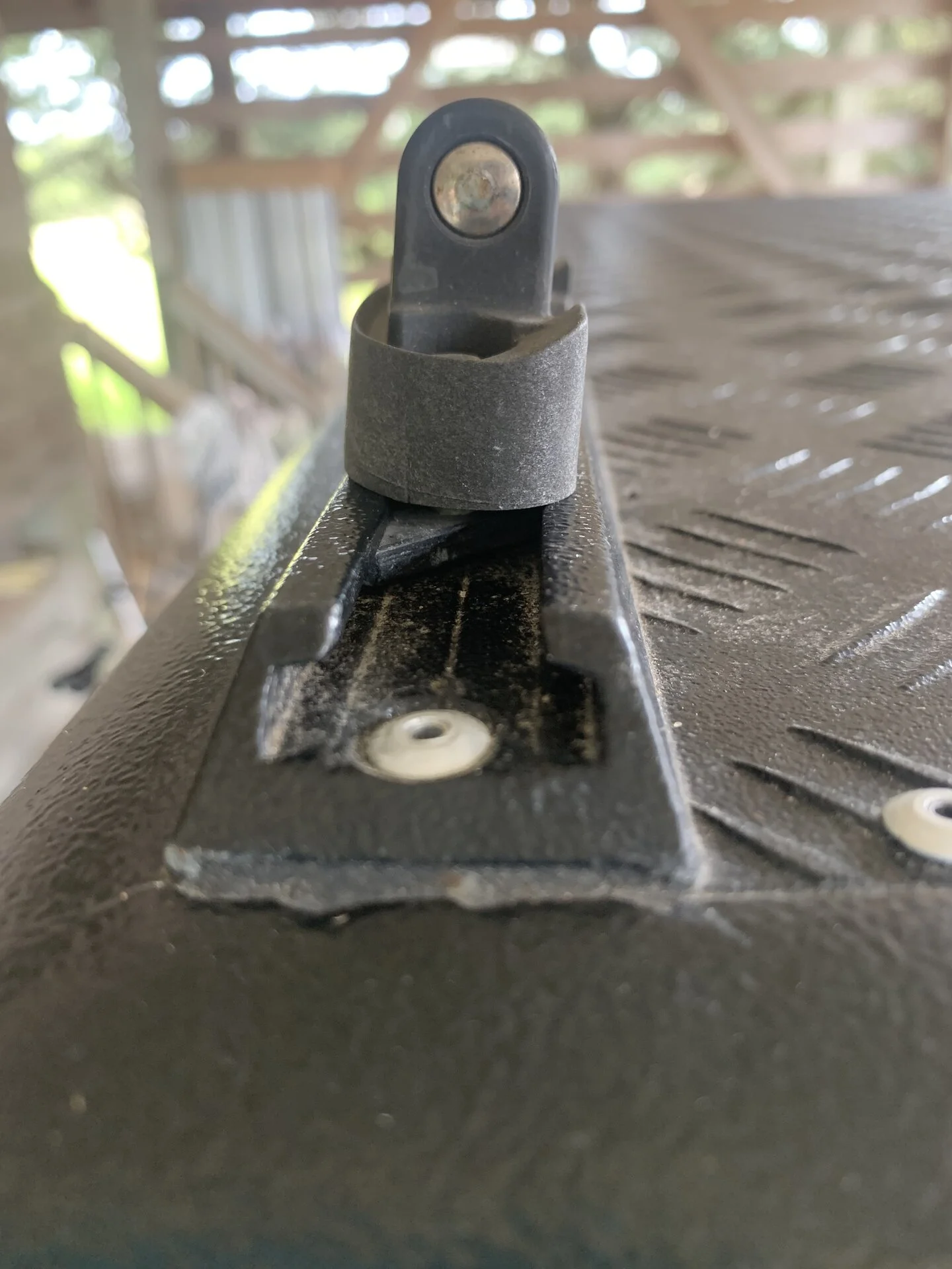

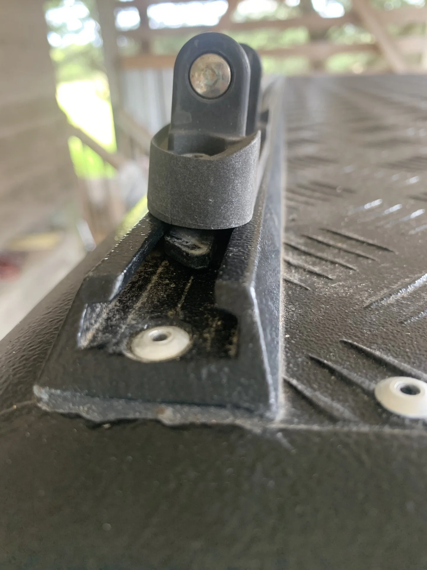

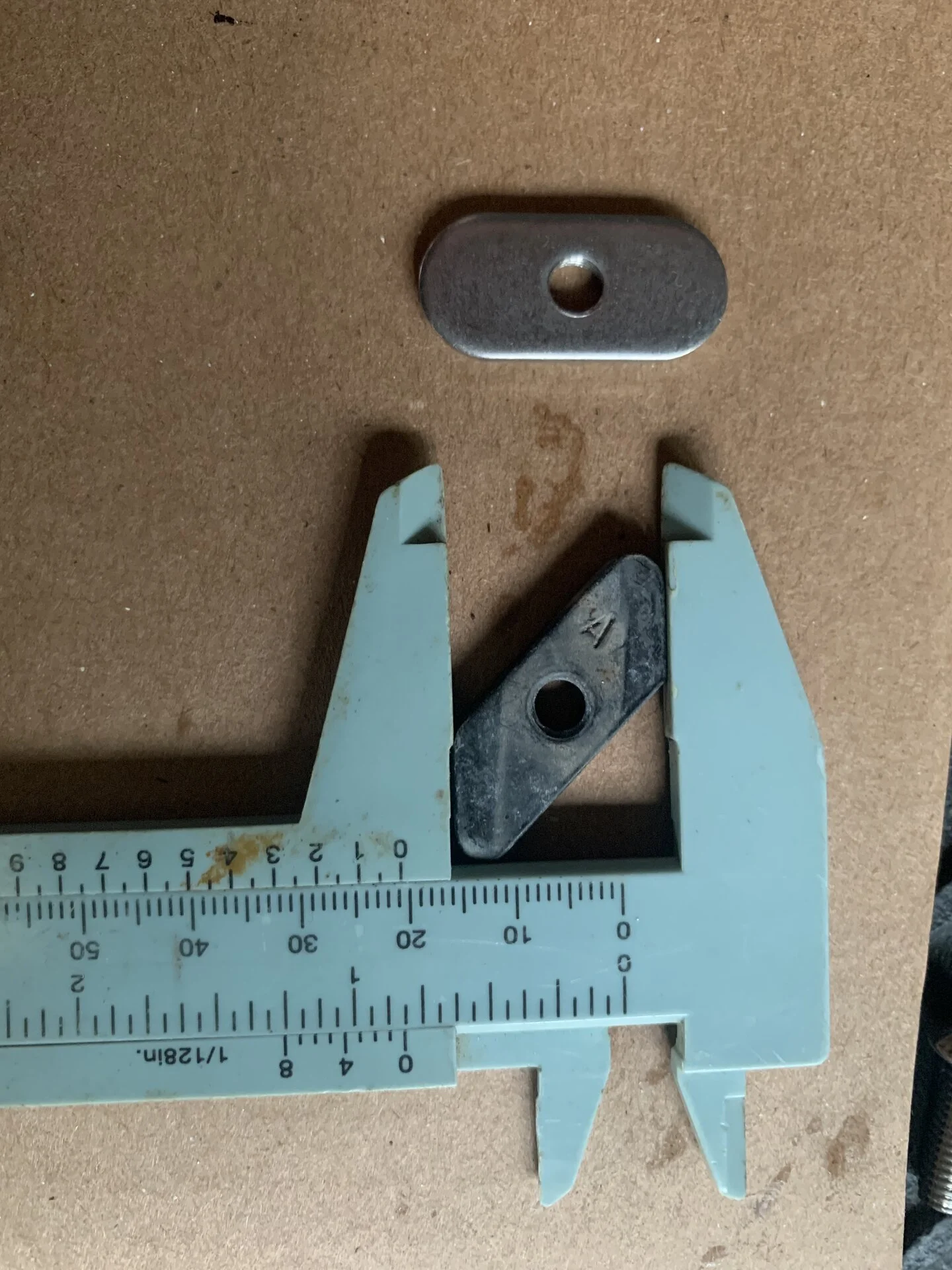

The T Slot track is approx 24mm at the base/widest point, 16mm at the top/narrowest point, and about 5mm deep. The black oxide Thule anchor with the angle cut is 4mm thick. The oval stainless anchor is 3mm thick and I was planning on grinding them to match the profile of the Thule anchors. The bolts that thread into them are M6. I have some Rhino Rack anchors that are just over sized in both width and thickness, but would be easy enough to grind down to fit; they also accept a M6 bolt.
The Thule anchors are available at Etrailer, I recall them being stupid expensive. The stainless ones came from Amazon, and a pack of 10 were pretty cheap... draw your own conclusions.
I ordered my top a year ago, so no idea if they have changed the track they are using. I wouldn't buy anything until one receives their top and can measure the track for themselves.
Hope that helps.
Thule cross bar base and anchor
Anchor Engaged

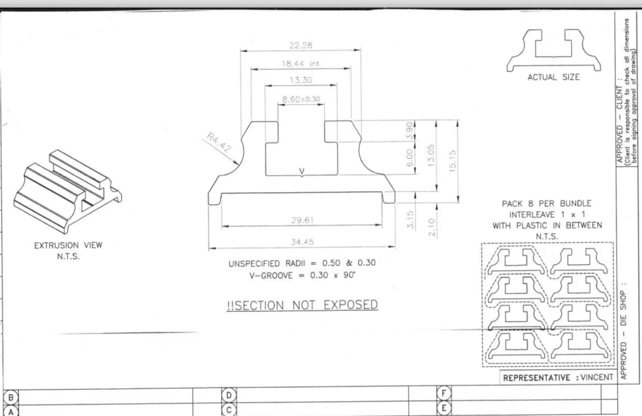

Additionally, I've attached the schematic of the roof rail. Converting to freedom units, it looks like the rail internals are 0.2 inches wide x 0.5 inches tall.
