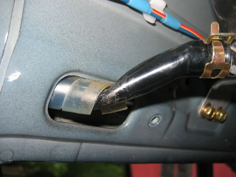

I finally got tired of wet carpets and decided to remove the interior and headliner in search of the culprit. I did put the two front seats back in, but that was it. There's more than one leak and I haven't chased them all down yet, but I definitely found one.
I couldn't get any weedeater line to feed all the way through from the rear drains to the sunroof pan. The drivers side had a fairly good kink in the drain tubing. I tried to work the tubing back into a less restricted position before reinstalling the headliner. The passengers side was completely disconnected and appeared to be so for some time. Note the lack of clamp impressions on the tubing. On a final note, removing the headliner wasn't that big of deal. There was a lot of screws and whatnot to remove, but it was more tedious than anything else. This tool made removing body clips a breeze. Maybe it's just me, but I always seem to break a few. It's definitely a luxury item, but I didn't worry at all about damaging the headliner or clips.
I still seem to have a leak coming from the front passenger area. I have a few suspects thanks to this forum. Please pardon my links rather than images. I have a few things yet to figure out.
