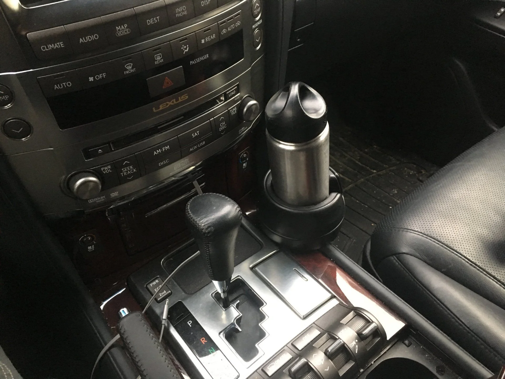

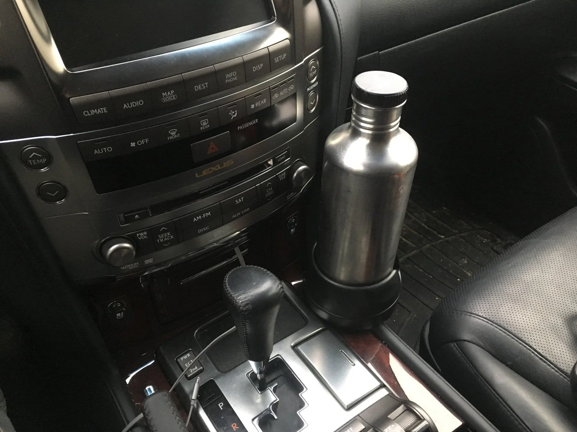

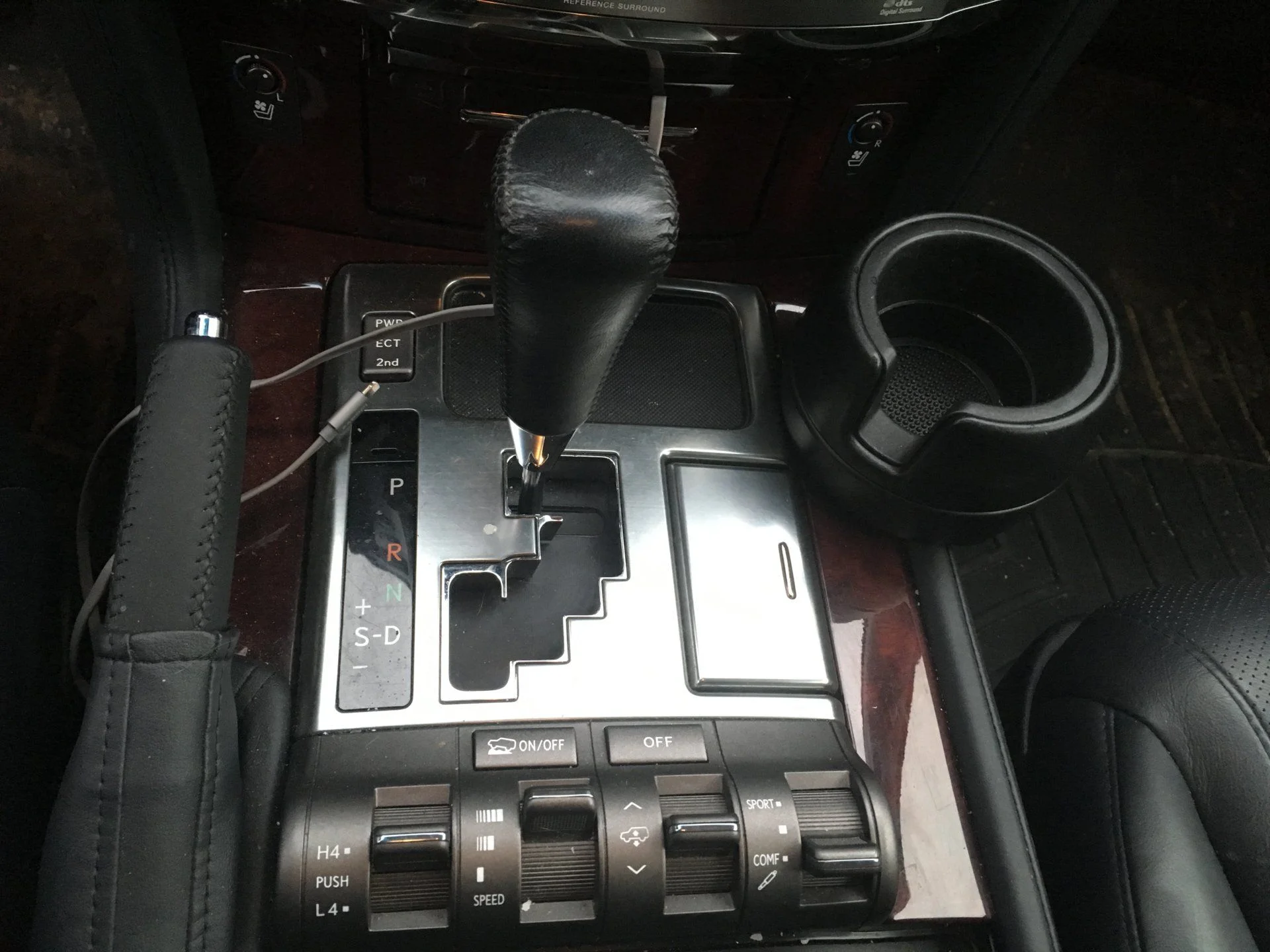

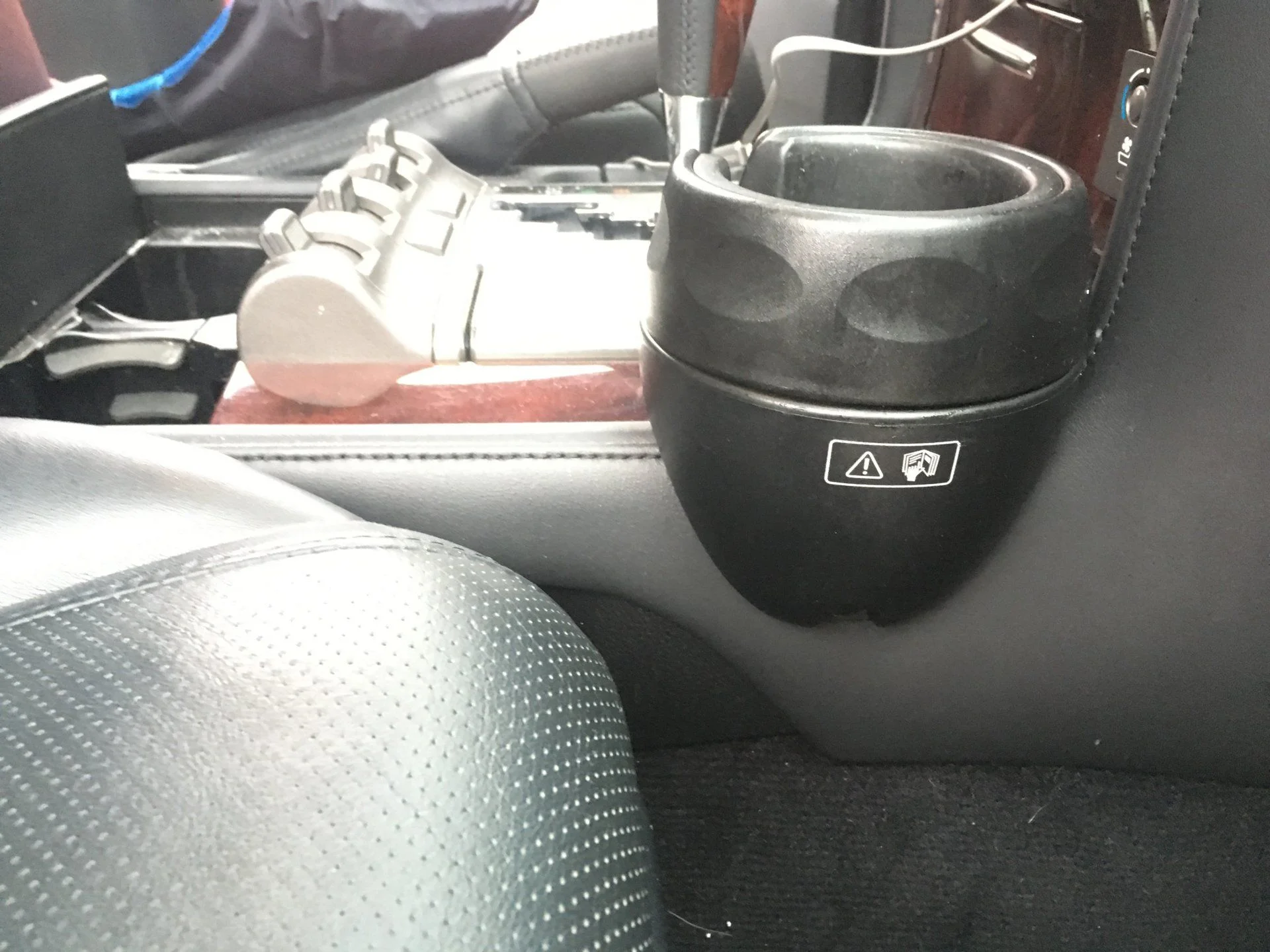

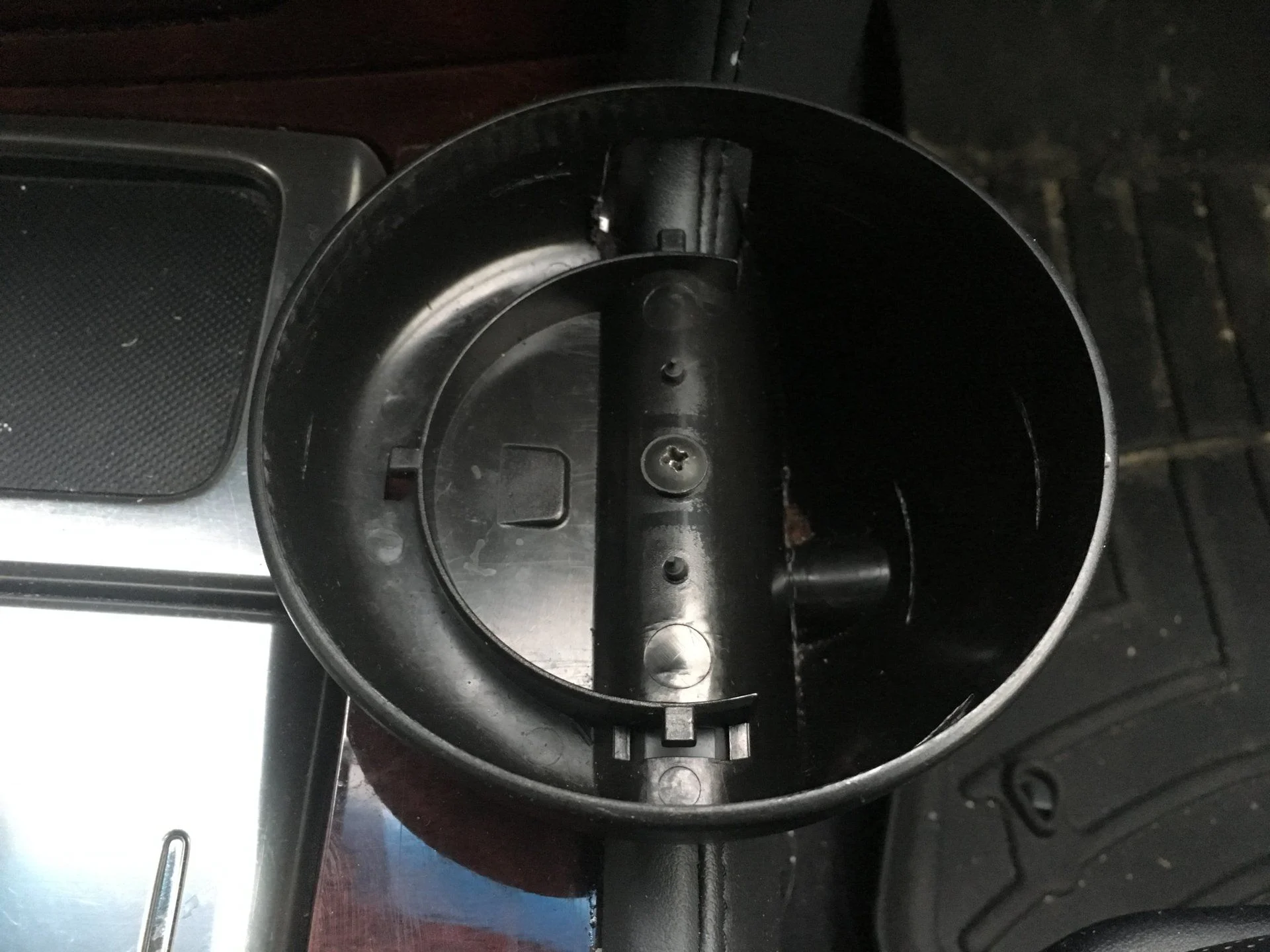

I got tired of the OEM cup holders (especially since I like to slide/extend the armrest forward, which covers the cup holders) and added one. I have an FZJ80 and this is a pretty popular mod for that generation. It takes some commitment as it's mounted with two screws. The cup holder is from a Land Rover Discovery (used from eBay). It has a removable insert/spacer to accommodate narrow and wide bottles/cups and the slot (clearance for a mug handle) can be pointed at the driver or the passenger. I cut out a portion of the cup holder with a Dremel so I could position it a little more forward and provide clearance for the little door that covers the USB slot; picture of removed material included below. I also used some shims to get it level. The bottles/cups pictured sit securely, but none of them fully bottom out; they get wedged in the ID taper.
