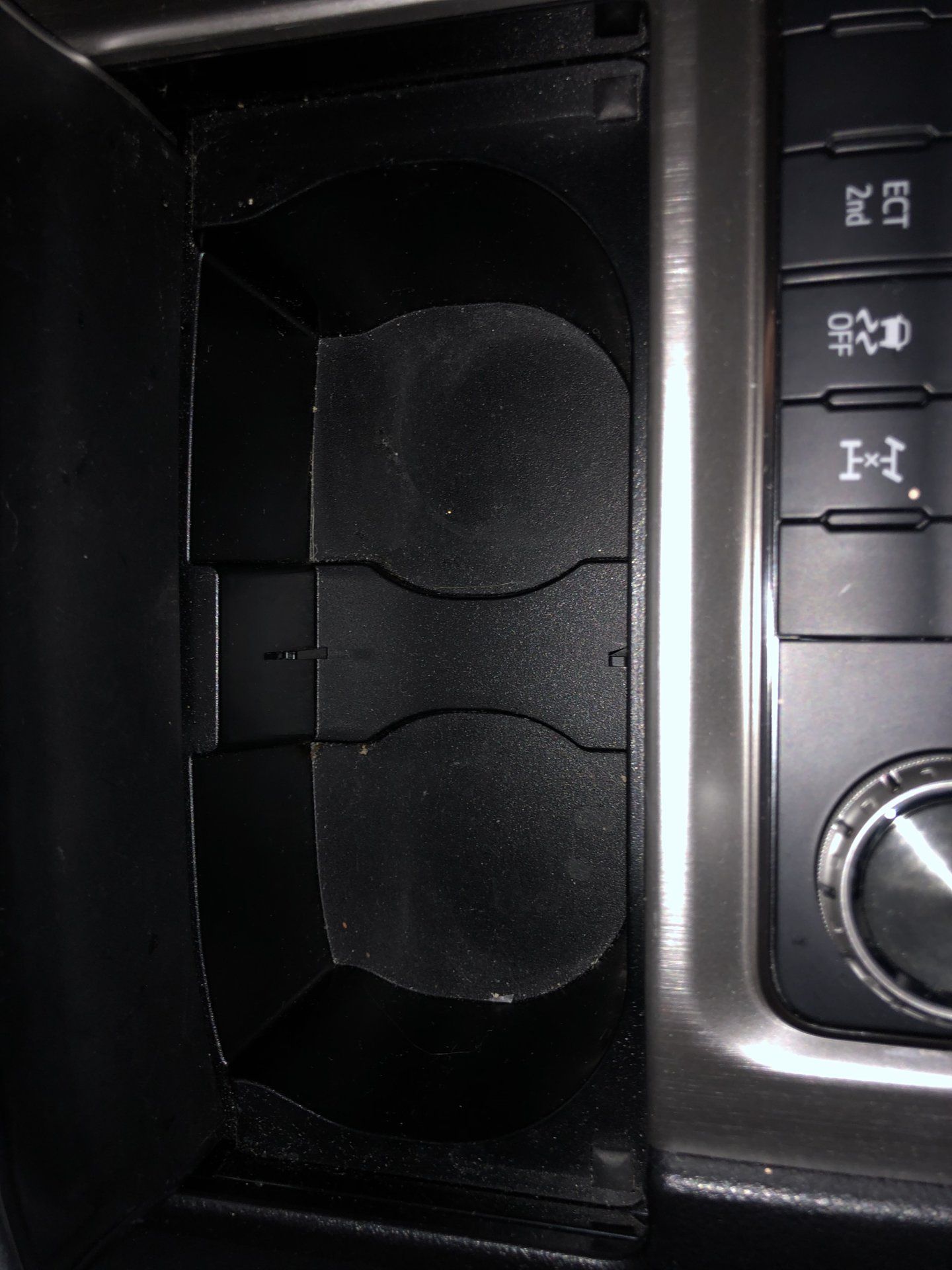

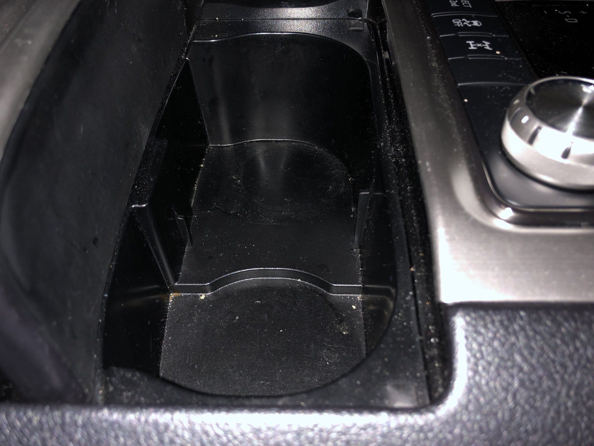

thanks for the pictures but I think those are the older style 200 series interior. That is the same interior I photographed Today's back. I think the one I photographed and dimensioned was from a 2014. I'm guessing around 2016 or 2017 is when they changed the interior and those are the pictures I need.
Ahhh sorry.

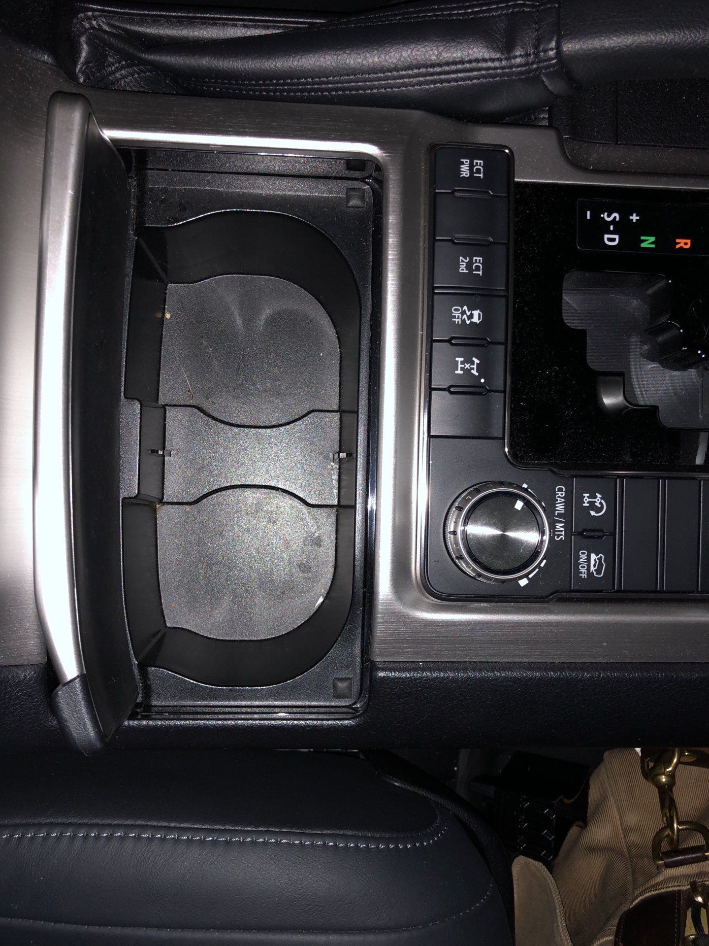

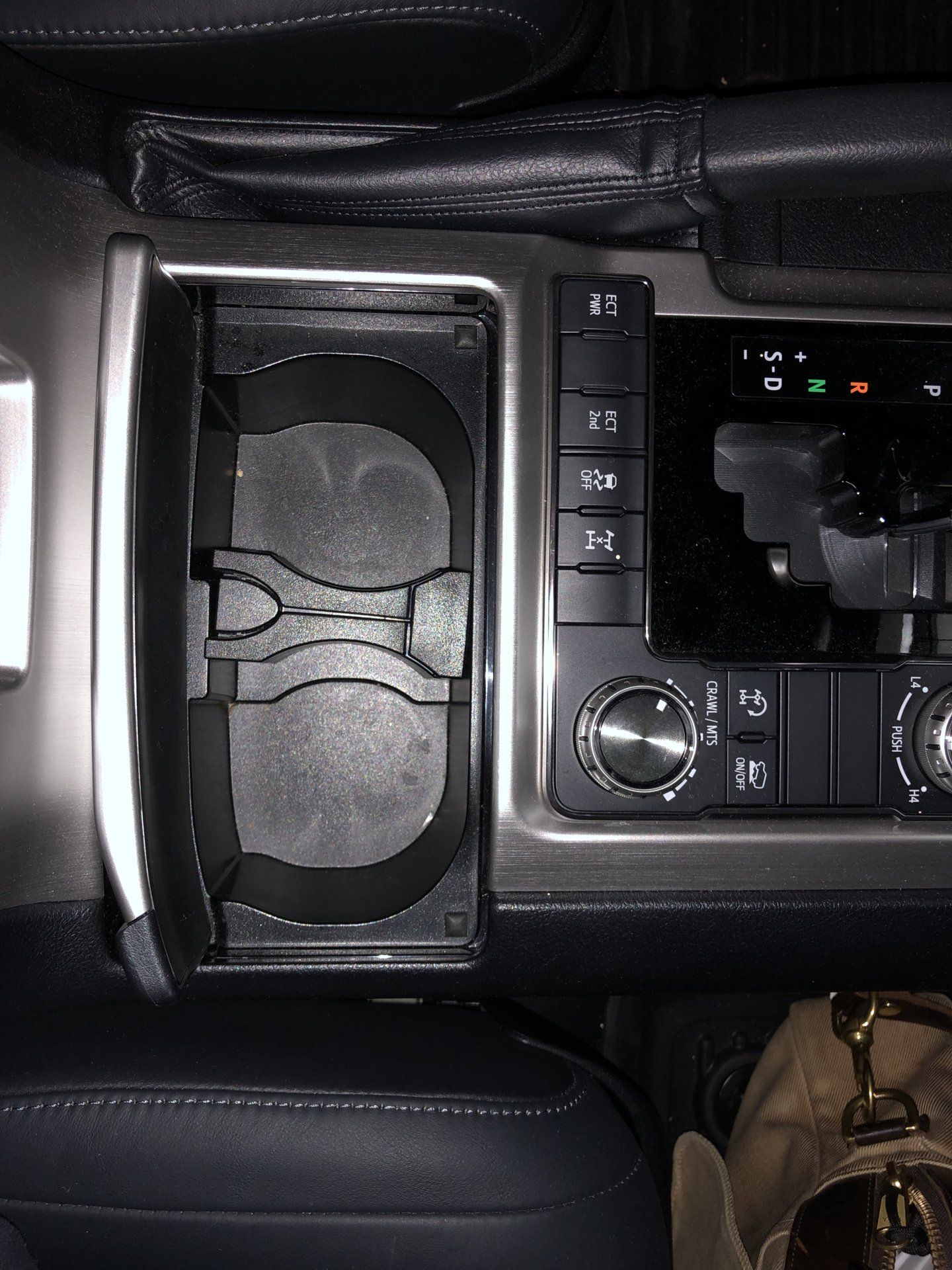

Photos of a 2016. Let me know if you need other angles.

Now I'm more confused. That is the same exact interior as the 2014 I measured a couple days ago. Is there 3 interior console options over the years? The 2009 pictured earlier has a different cup holder area than the 2014 and this one above. If there is only two console options then I need to know which years they were offered.

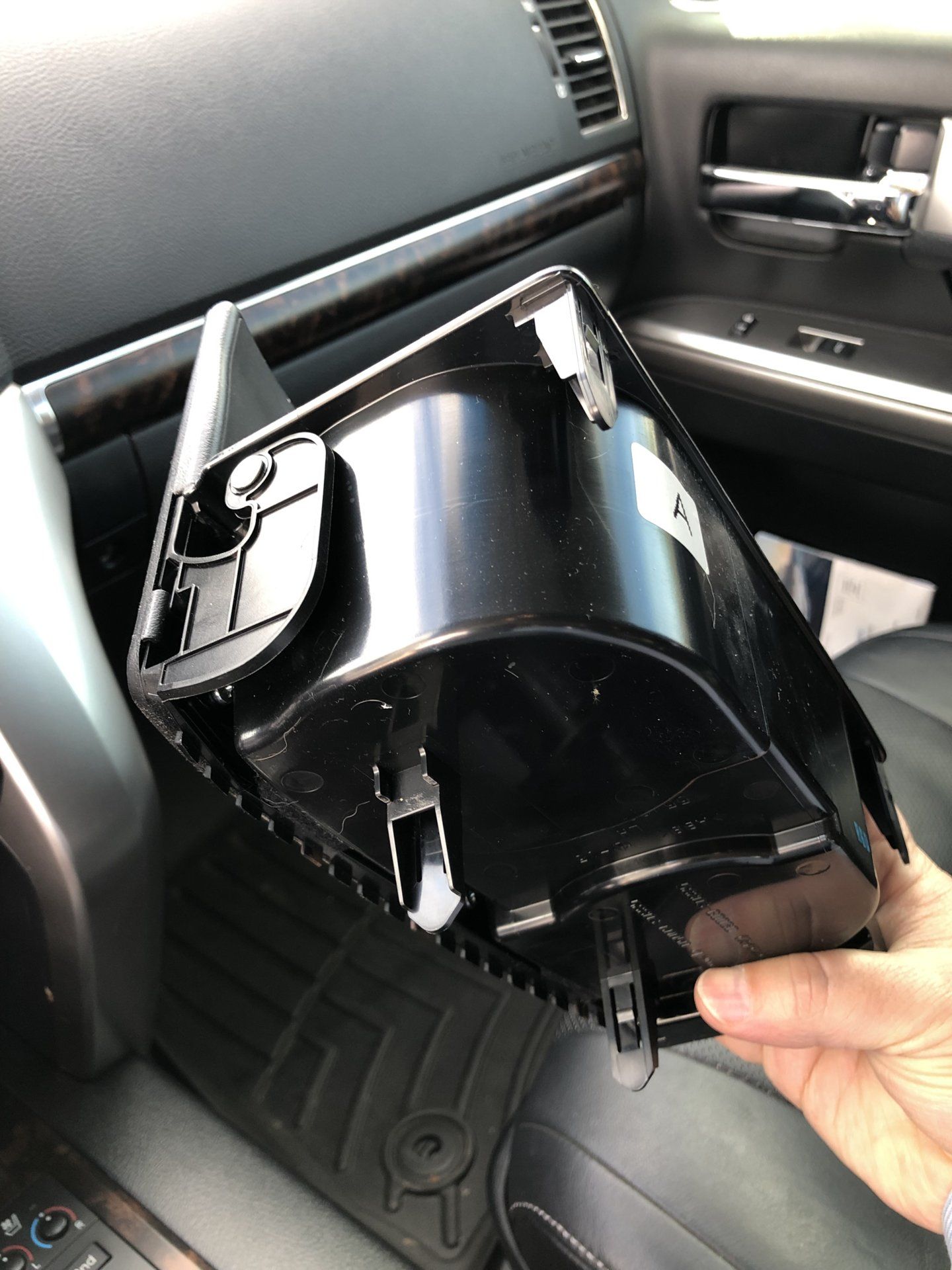

If that cup holder is anything like the Lx, removing the lid is easy. Yank the cup holder out - it's just snapped in. Undo 2 screws, catch spring that flies at your face, and presto.

I believe it’s pretty simple. I’ll check and post a photo. Pull hard on cup holder...then you access the lid attachment.
I had no idea it was that easy or I’d have left it with him to do the design. I reached out and maybe we can get a complete replacement eliminating or incorporating the door.
