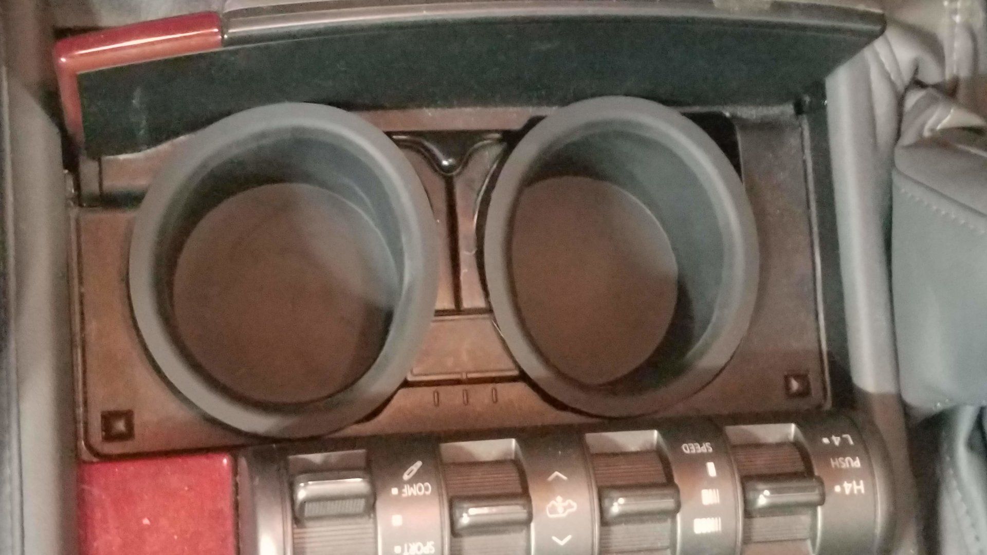

So I purchased this cup holder for the FJ and it fits perfectly in my 2018. AND my hydro flask fits perfectly in the cup holder snugly but not so snug that it’ll remove the cup holder from my car. I do wish it was taller to prevent it from toppling over when I wheel but it’s a huge improvement. If you like hydroflasks, I highly recommend this piece. @Taco2Cruiser something to consider.
That's funny, I just received mine today as well. I left the middle piece in so they would fit more snug. Haven't driven yet but did set a normal water bottle in there and yes much better. They do deform a little with the other piece in but won't move.
Can you still close the lid? Can you snap a pic of the FJ inserts installed BUT with the center piece removed? Are the inserts stable and have zero wiggle?

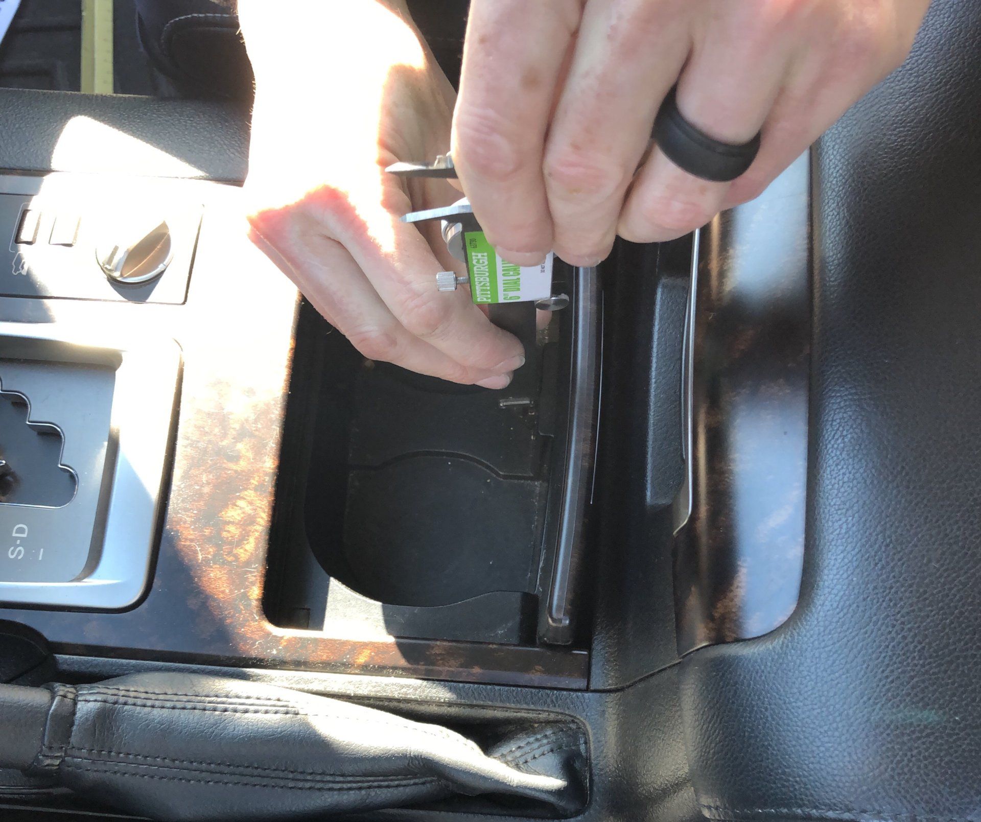

I just got a ton of dimensions today from @DRCocaCola rig. Found some weird design choices by Mr.T. The depth of the cup holes is just under 2.5" while the industry norm is usually 2.75"-3". These are a bit too shallow. The normal cup hole diameter is usually 3"-3.2" while the 200 series holes are 3.45" which is too wide. In short these cup holders are too shallow and too wide; which you guys already know that. The weirdest thing is that they are not round. The are 3/8" wider front to back than they are left to right. That means your cups wiggle much less on side to side movement in your 200 then front to back (hard acceleration or braking). Why would Mr.T make an oval cup holder? Your guaranteed an unstable fitment for your cups. I do already make the FJ inserts but the insert that needs to be made can't be round. It's outer surface needs to match the awkward oval space that is there with the inside diameter being round and at 3"-3.2". As soon as the Valentines rush stops, I will start working on this project. I was hesitant to design cup holders for such a modern vehicle since you rarely see such a simple feature screwed up, but after personal inspection I definitely see major design flaws. This can easily be addressed with some major improvement toward function. This will be a slow process even though it's a simple design because I don't have a 200 in the shop to work off of. I will have to mail each prototype out for testing fitting, wait for delivery and test fitting, get feedback, make subtle changes, and repeat. This will be a slow process to get perfected.
I snapped a couple of photos for good measure while @bhicks was taking his precise measurements and adding the dimensions to his quick sketch. His estimation is it will take a few tries at a prototype before he can produce a finished product. We’re about an hour away from each other so some of the fitment and testing will occur by shipping prototypes back and forth. We’ll try to speed up the process if either of us is heading in the other’s direction at any point.

@bhicks I ended up removing the center piece and put some double sided tape on the bottom so they stay. They are loose otherwise. My lid will not close.

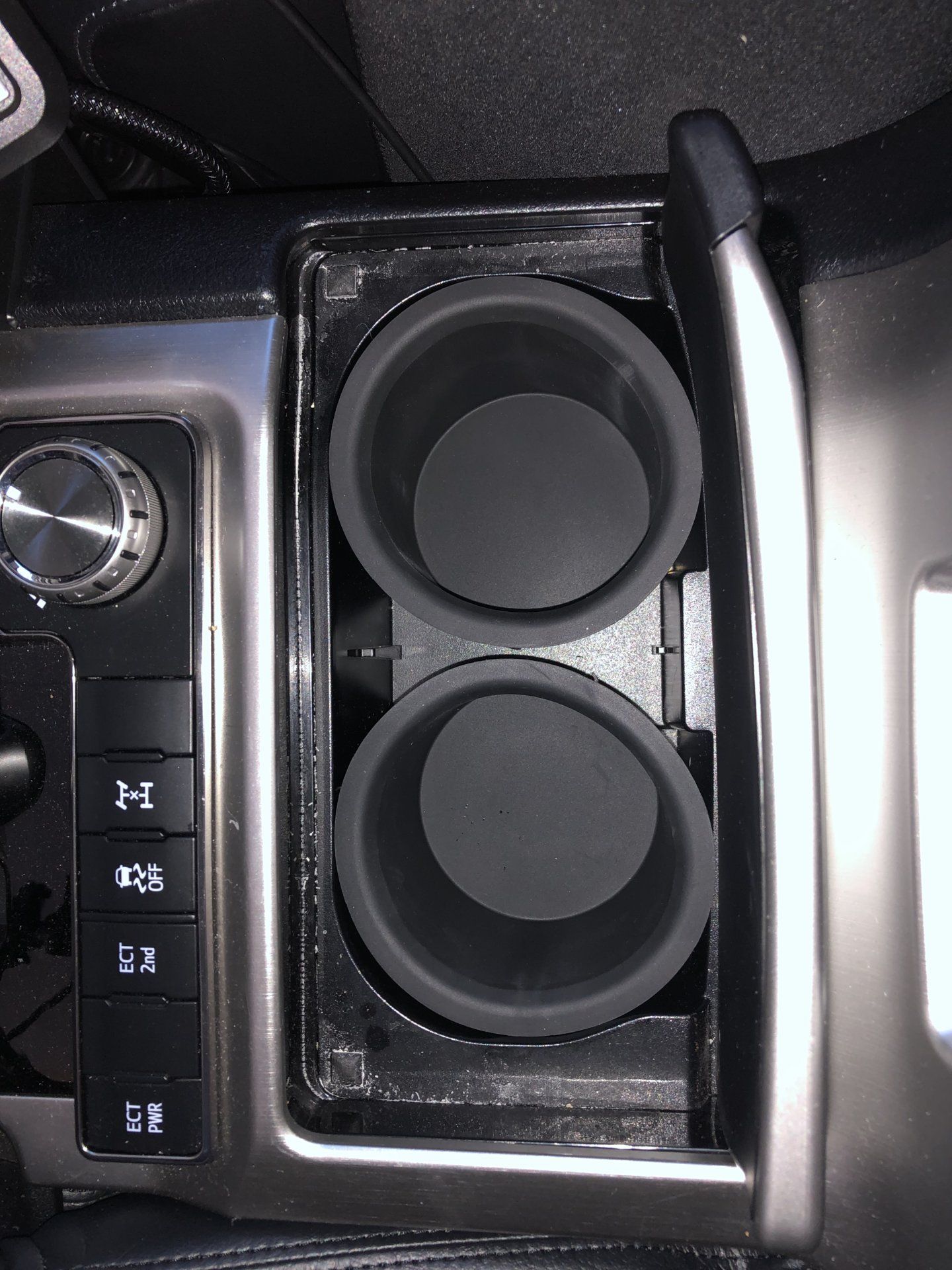

Here's some pics of the first prototype. It's a modified and mirrored FJ Insert. The final product will be smoothed out flat black and not rough 3D printed white. I prototype in quick rough settings and always in white so I can mark and take notes directly onto the surface of the prototype. Can someone post pics of the cup holders with nothing in them on the newer interior 2016/7? I don't know what year the newer interior started so please let me know.
