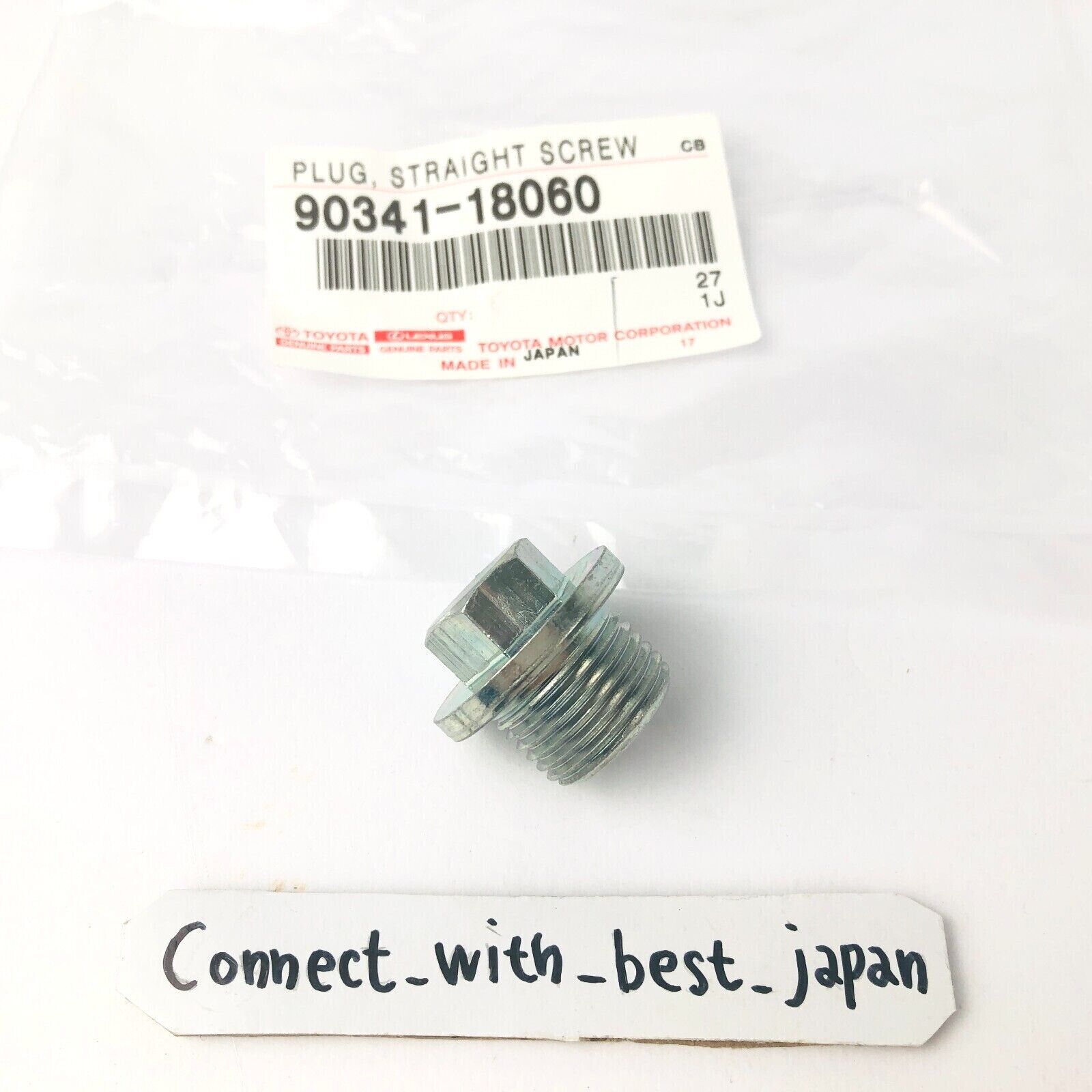

4G63 POWER, Nice product, but Compared to the 20 bucks it would cost you for 8 factory plugs. I think I'd rather save that extra 260 bucks it would cost you for 8 of these DIMPLE® Oil Plugs. and just spent it on something else for my truck. YMMV
I'll stick with my OEM hex plugs with the weak magnet and change the fluid more often.
If you drive through water your going to suck water in to your diffs no matter what you do. I'd rather change cheap diff fluid every 6 months than risk it with expensive fluid every year or two.
But what do I know, just been doing it this way for 23 years... :)

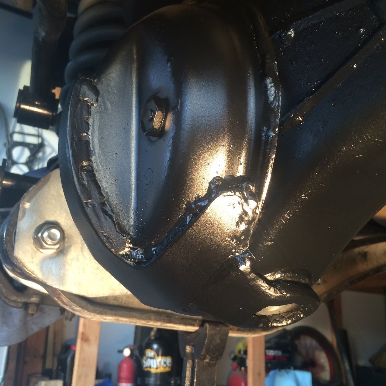

Labor Day weekend a fella in a 4Runner two rigs ahead of me on the Rubicon lost his rear OEM diff drain plug and oil. We never found the plug because it was almost dark. The guard ring on his axle had been ground off on the rocks and his plug knocked loose.
Mine were pretty ground down and I had to use a chisel recently to remove the drain plug.
So I did this last weekend: photos next post.

baldilocks, with that much extra armor welded on your diff's, you must play alot harder then i do off road, i guess I'm just getting old.

I live 100 miles from Rubicon and other similar trails where granite grinds the hell out of the underside. I have been wheeling my 80 just over one year and the rocks had already ground the Toyota drain plug guard down to the level of the plug. I expect that I will be adding to and/or repairing the drain plug armor you saw pictured in the not so distant future. I'm going to start "grinding" on it Saturday. :D
