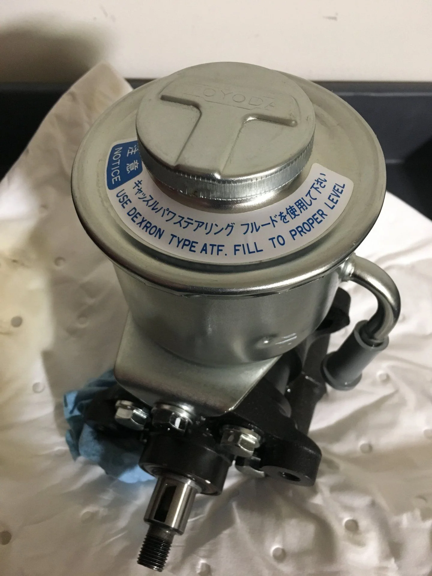

I’m not totally sure, but I don’t think the one from Toyota comes with the reservoir. Been on the hunt for an OEM one as well, so if anyone can confirm/deny this, I’d appreciate it.
Mine did. Its been on the truck for several years now but came with reservoir. I think the reservoir is also available separate (or at least was). HTH.

I saw this thread just in the nick of time. I had placed an order from McGeorge for a few small parts for my Sequoia, and then saw that they had the OEM PS pumps for sale. Added that to my order and it is en route. My original one is still going strong, but looks like it may have a slight leak.
