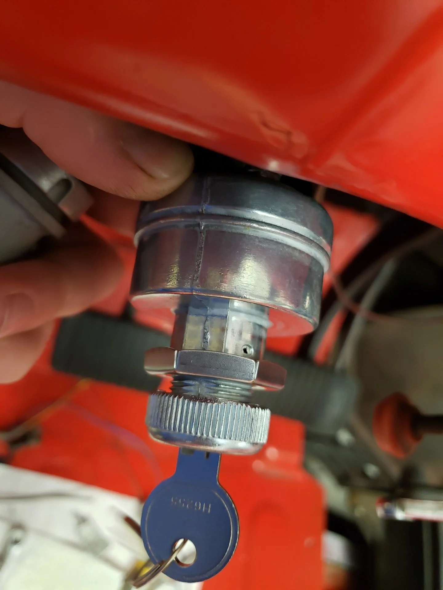

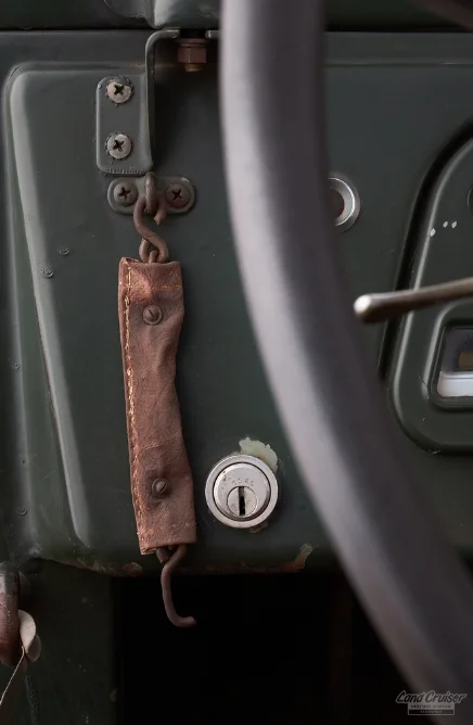

Bought this ignition switch from city racer. They say it fits. There's no key way (notch) to keep it from spinning when you turn the key. The snout is smaller and shorter than the factory one. Tried big washers but the snout is too short for them. Tried no washers and the tightening rings get sorta sideways in the dash hole.
You guys got any ideas on how this is supposed to fit?

Are you sure the ignition hole hasn't been modified? That hole above it doesn't look stock. The "notch" cut doesn't look factory.

that looks like any generic unit you can get at any auto parts store

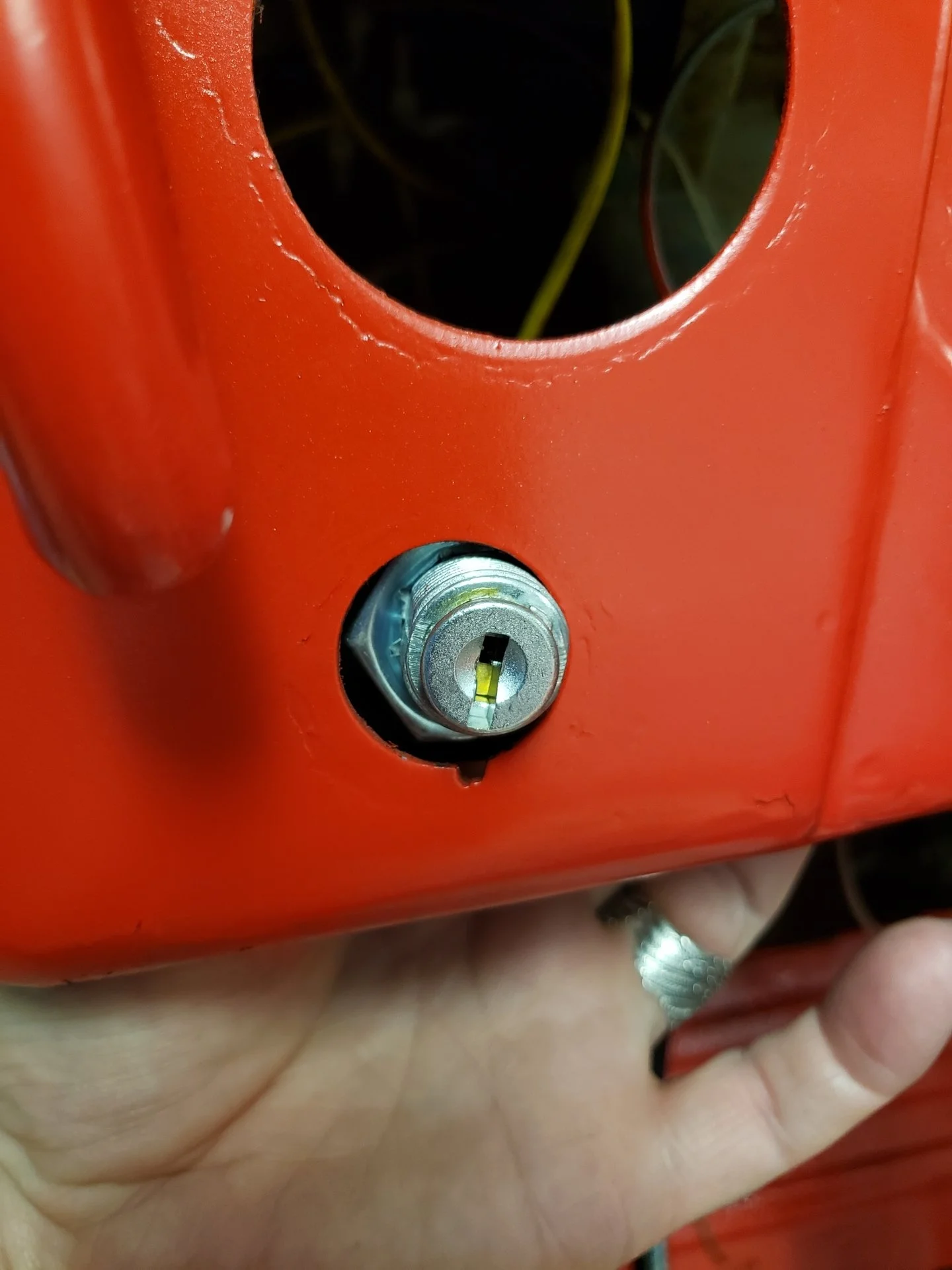

- you have a 25mm factory hole there for a 24mm in-dash combo lock and ign start switch PERIOD ,
- the Factory correct KERF cut into the lower bottom is for proper switch alignment plumb level and square , also some years have a anodized dash Applique in place too , rare as sh#t but they exist 100% real

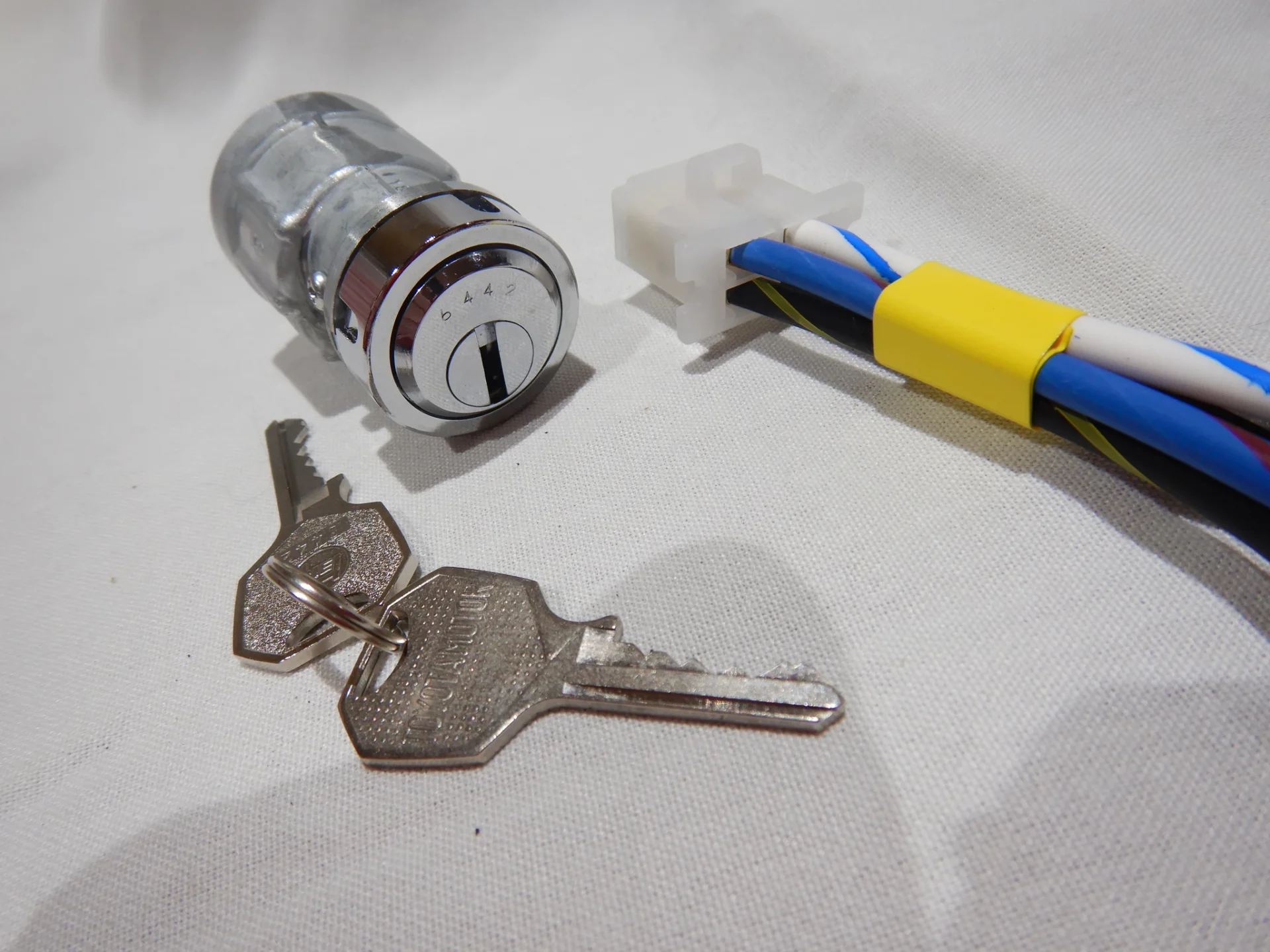

- below are links to the correct in dash size spec switch u need ,
- i always use and apply toyota's Factory Focus-point mindset approach , and here i no different .....

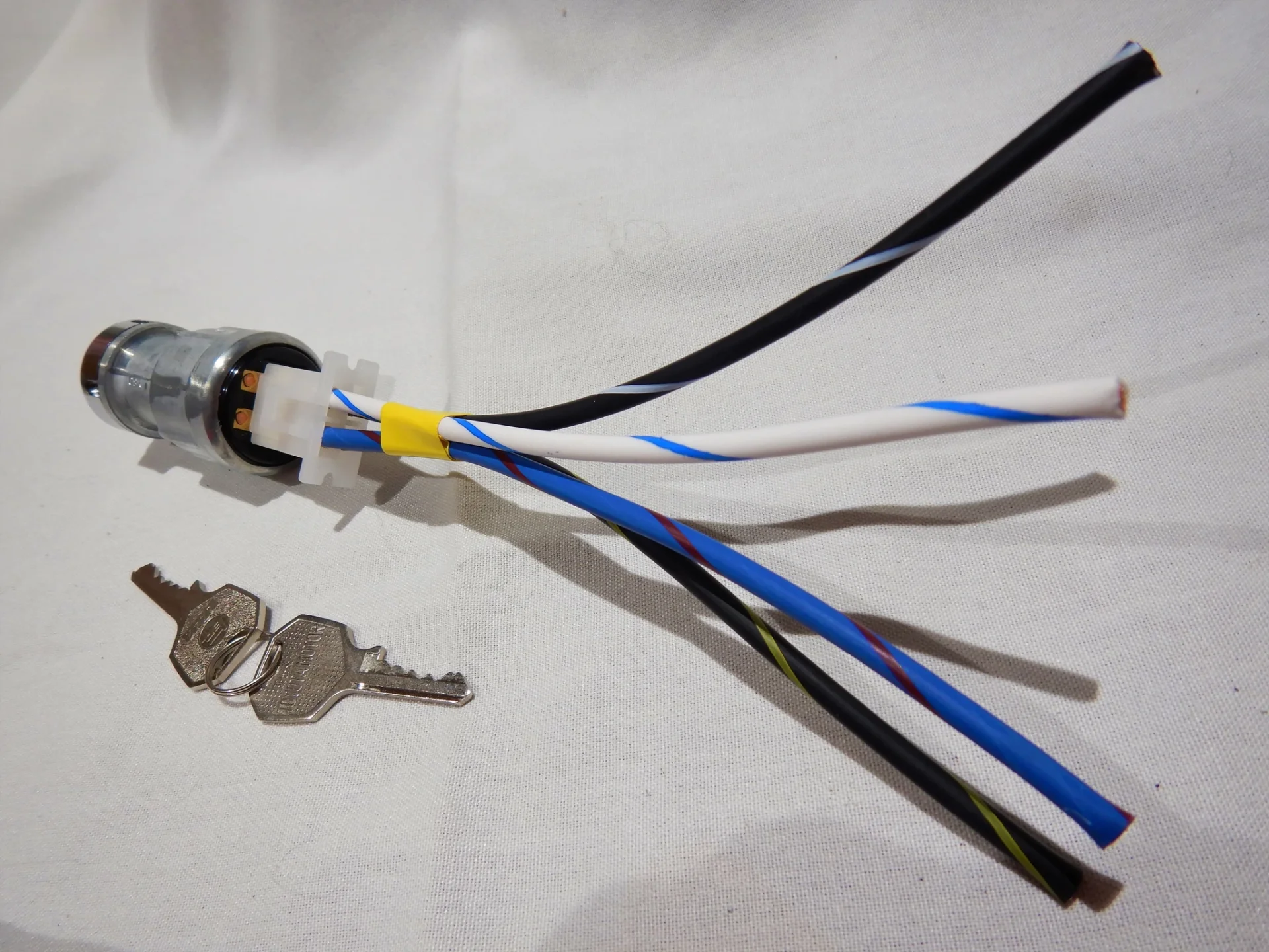

- my switch comes with a professionally hand made with pride and attn to details Service Spec connector and color coded tracer stripe wire leeds .........
- join all 4 wires properly matching color codes up and safely , then plug in and play , bottom line .....

What threw me off was the way the notch is cut. The few I have seen looked more squared off on the bottom of the notch cut.
Might be a good idea to measure the diameter of the hole to see if it is near Matt's 25 mm.

The 84450-60040 ignition cylinder also doesn't have a keyway. The snout on the cylinder I sent him is larger than 25mm, and it's secured exactly the same way on the dash.

I just replaced the ignition switch on my 72 with unit Matt is referring to above. Perfect fit, index slot and all.
It fits perfectly because 84450-60040 is a 71-72 part #. The question is whether is fits earlier cars.
Understood. Just trying to add info to help.
Bump. Had a customer reference this thread. Can confirm, the 84450-60040 absolutely fits the earlier 2x/4x Land Cruiser dash, I suspect if fits the 3x too :D
They too have the same ~25mm thru hole. The threads on the lock cylinder are ~25x1.00mm. Years ago we stock the earlier cylinders, Scott from Eco Offroad ordered the last few early cylinders we had in stock with the screw terminals rather than the spades. We had some with the big 'cold weather' key too. I think I kept one in my personal NOS hoard, I need to dig thru that stuff one of these days. :D
