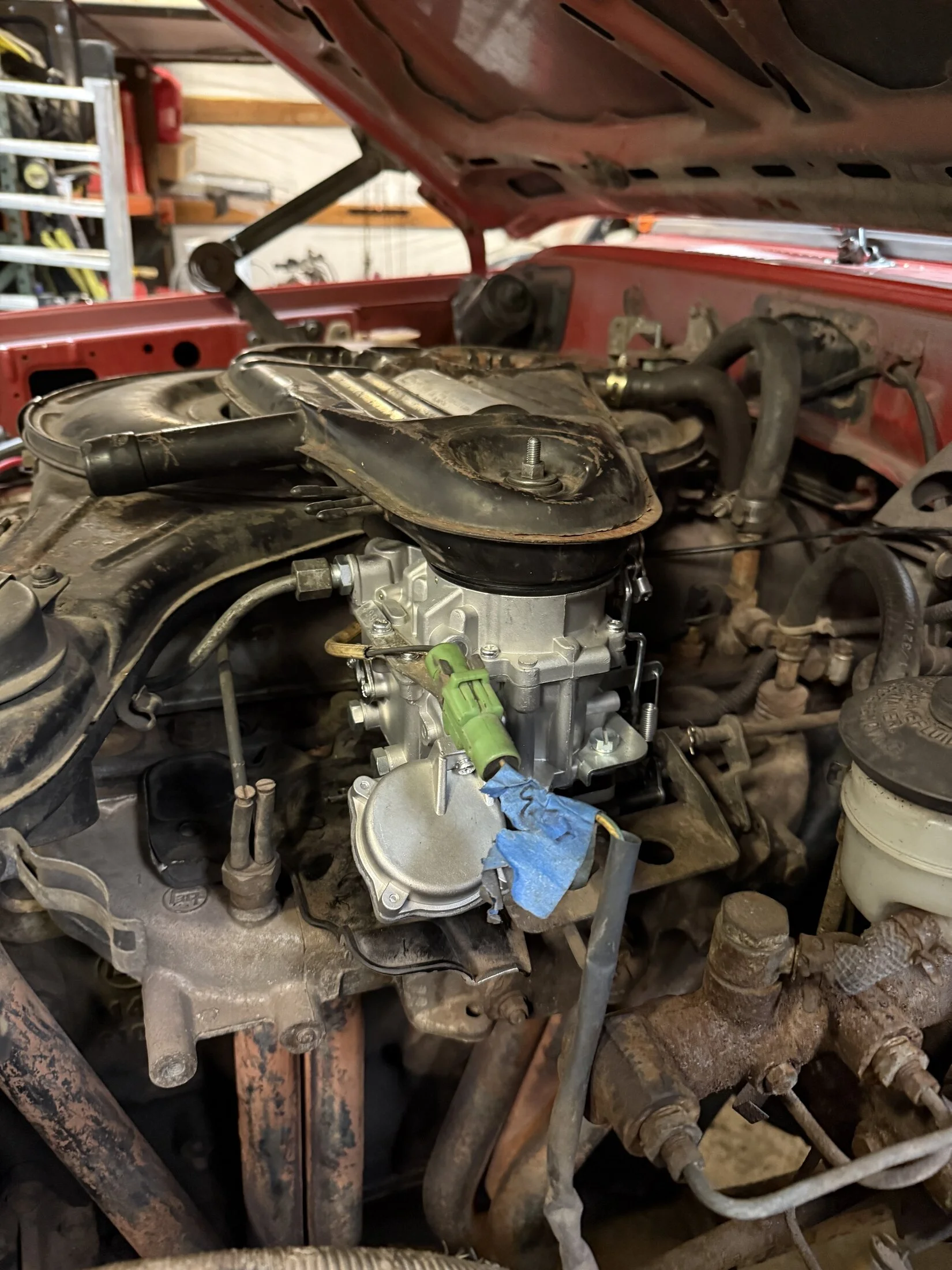

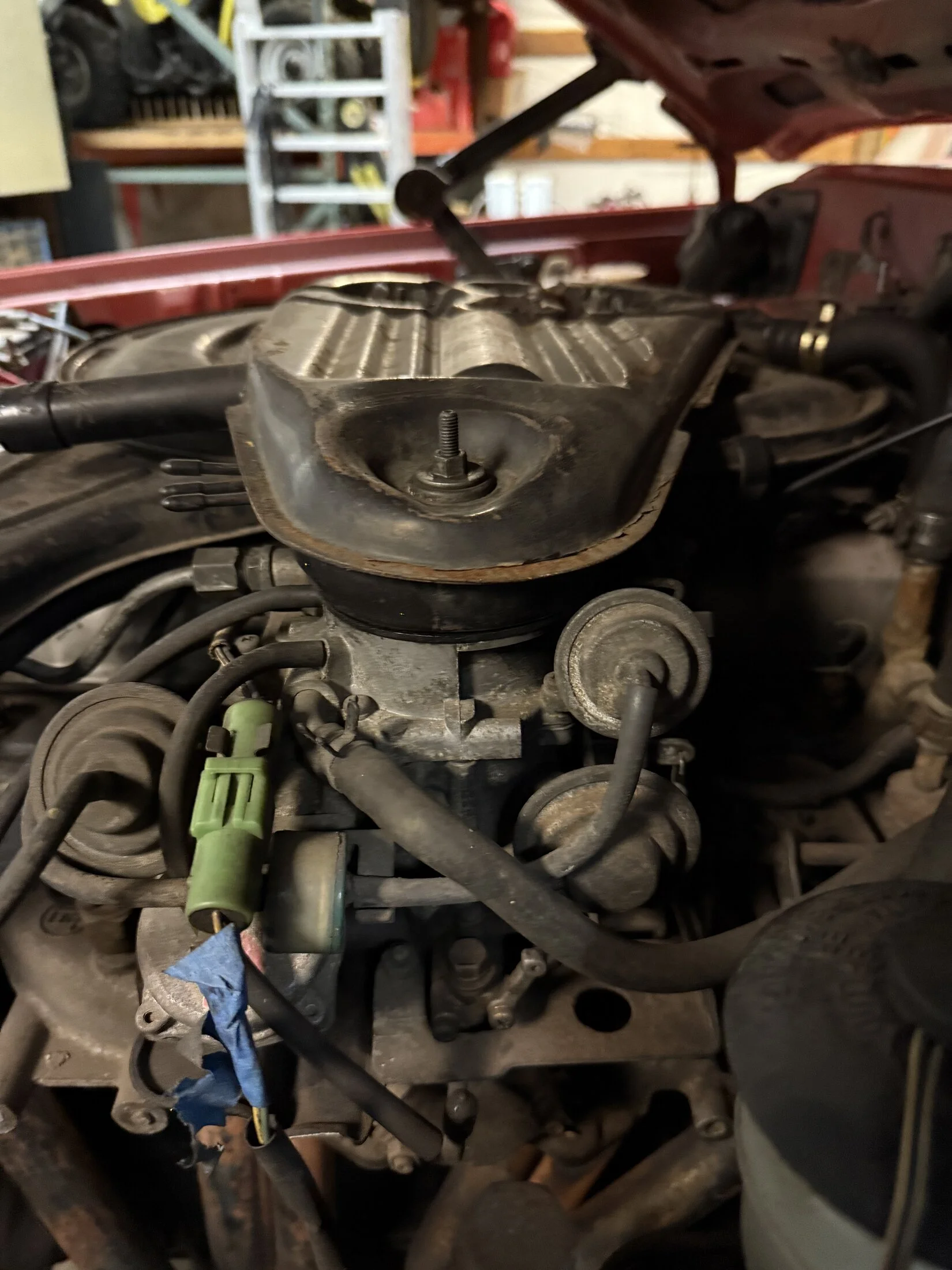

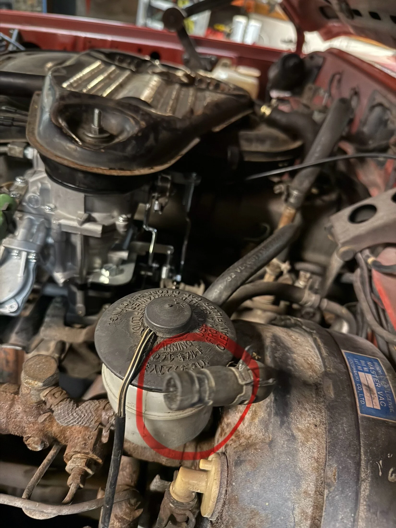

Rather than start a new thread, I figured I would piggy back off this one. I have an 84’ desmogged by the PO. Was running the stock carb but it was cold blooded and sputterd until warm. For the most part the 60 ran great, some backfire here and there. I went with the city racer carb as well. I followed the otramm instructions for tuning and it purrs. Once I get on the road it stumbles and sputters, first test drive I had it floored in 4th and could barely get over 50. Had to feather the clutch to get going. I’m not sure what to do next. I looked at the desmog routing and I think every l things looks okay b/c the original carb ran okay.

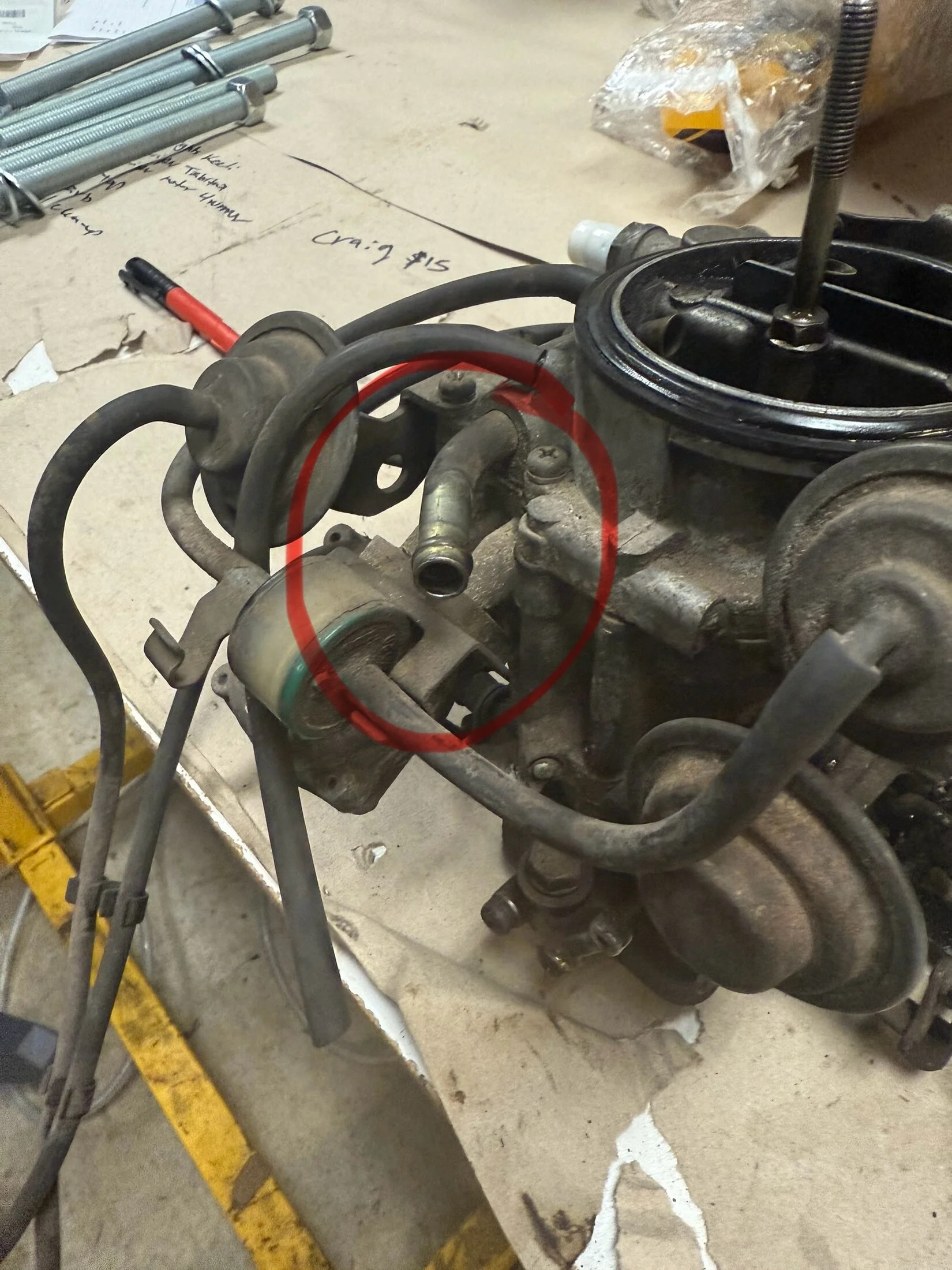

Not sure where the red circled hose should go now, it was attached to the OG carb. I don’t think that could be causing the issue.

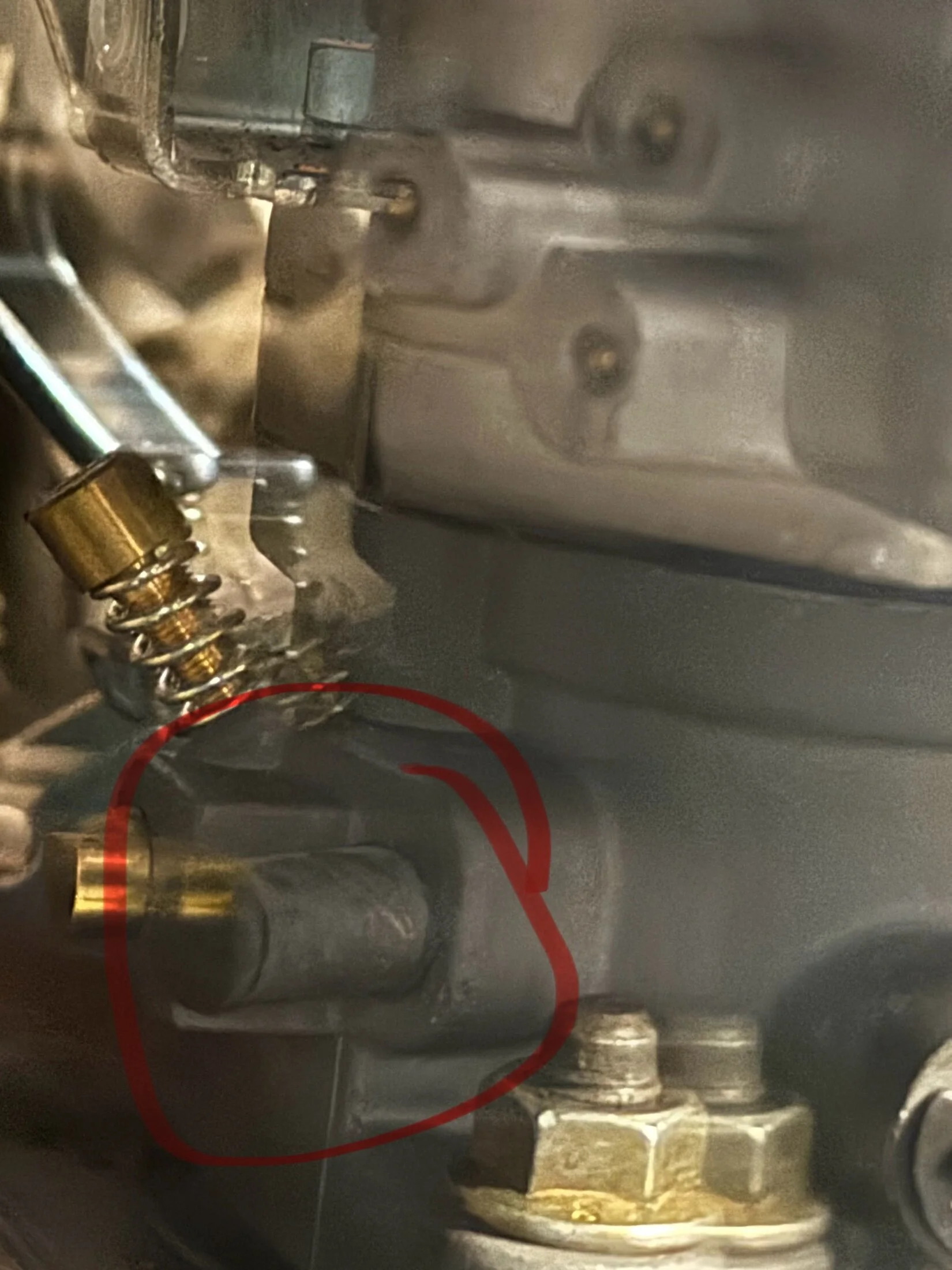

Also, what’s the port on the valve cover side of the carb for, it’s capped? Last pic.
