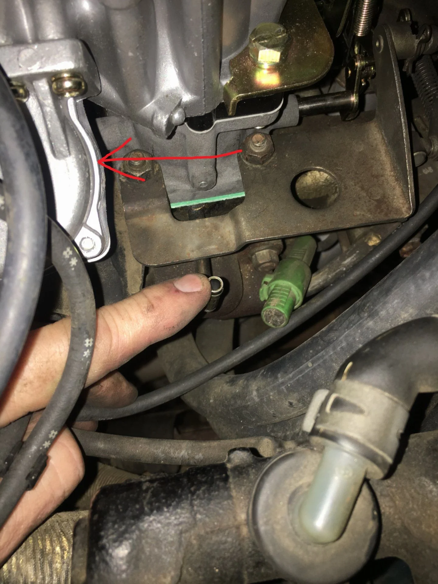

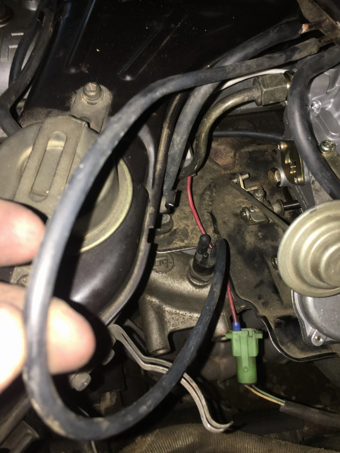

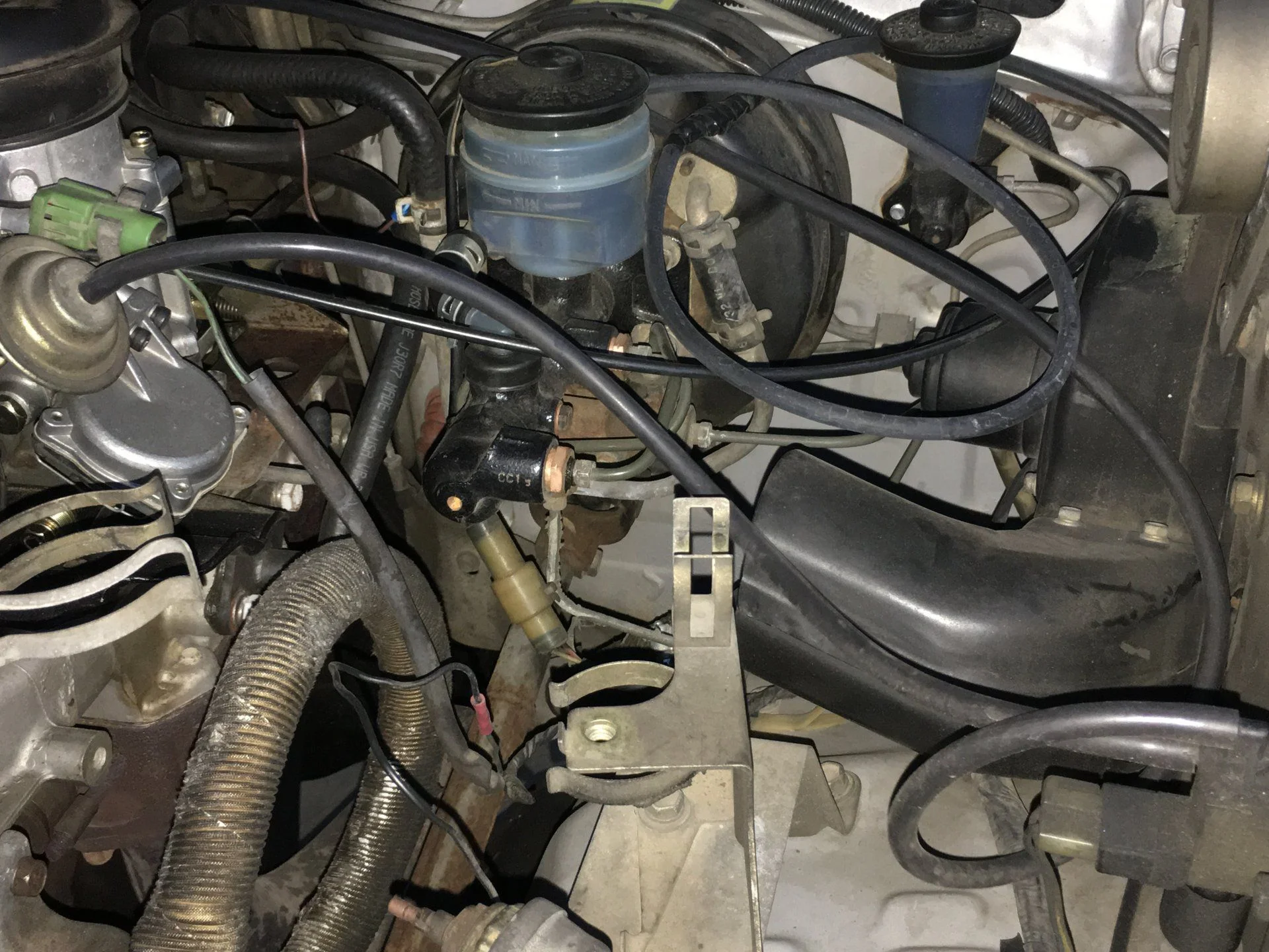

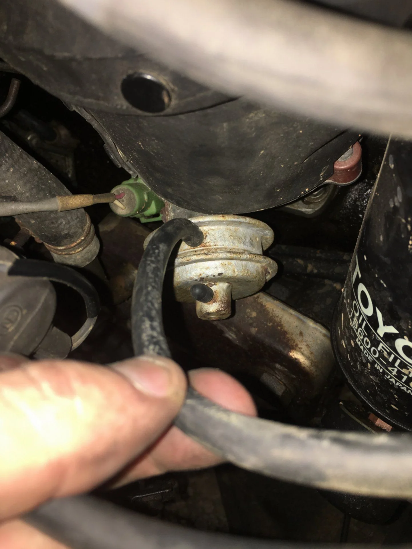

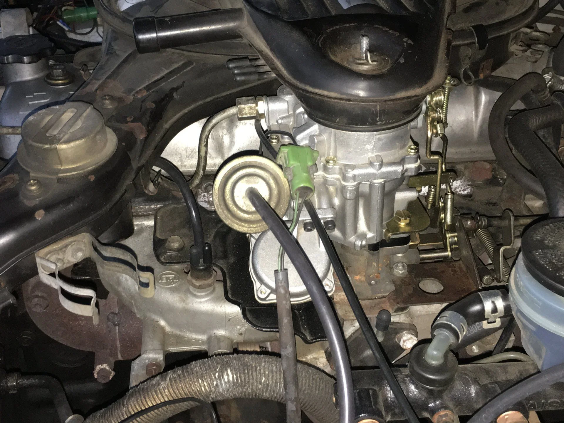

The idle up solenoid is getting vacuum from the firewall manifold bung
The bottom of the AC idle up solenoid is going to the carb

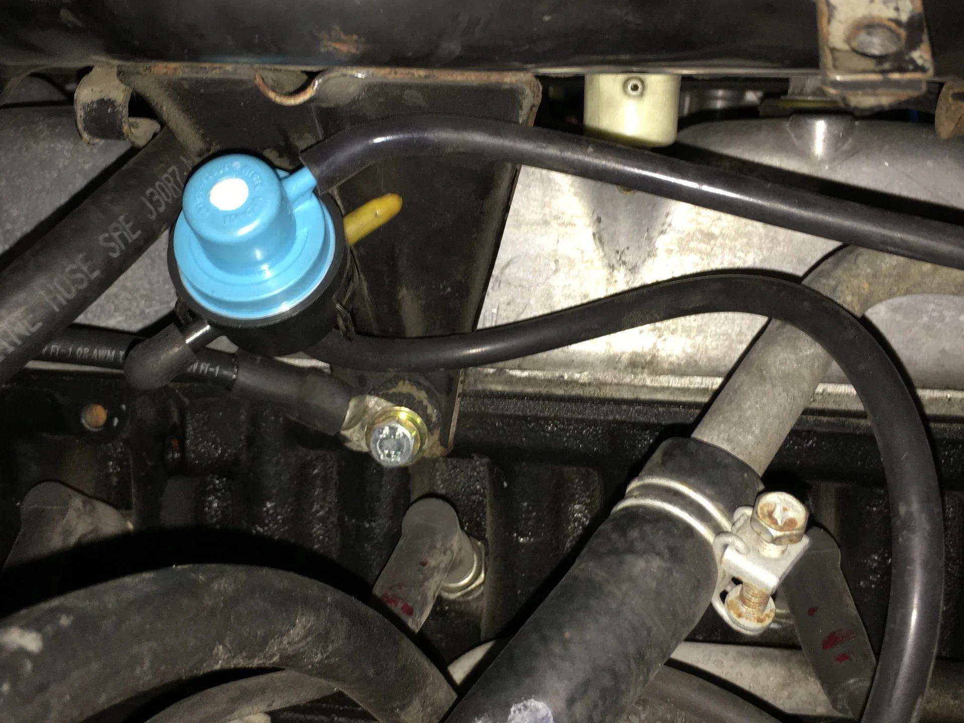

I'm not sure what this doohickey is on the fender but I just put it to the air cleaner
I took this vacuum to the air cleaner (I know it's not doing anything )
I was running this from the carb plate to the far side of the air cleaner but when I put the VCV back on I tried to plug it and it kills the truck

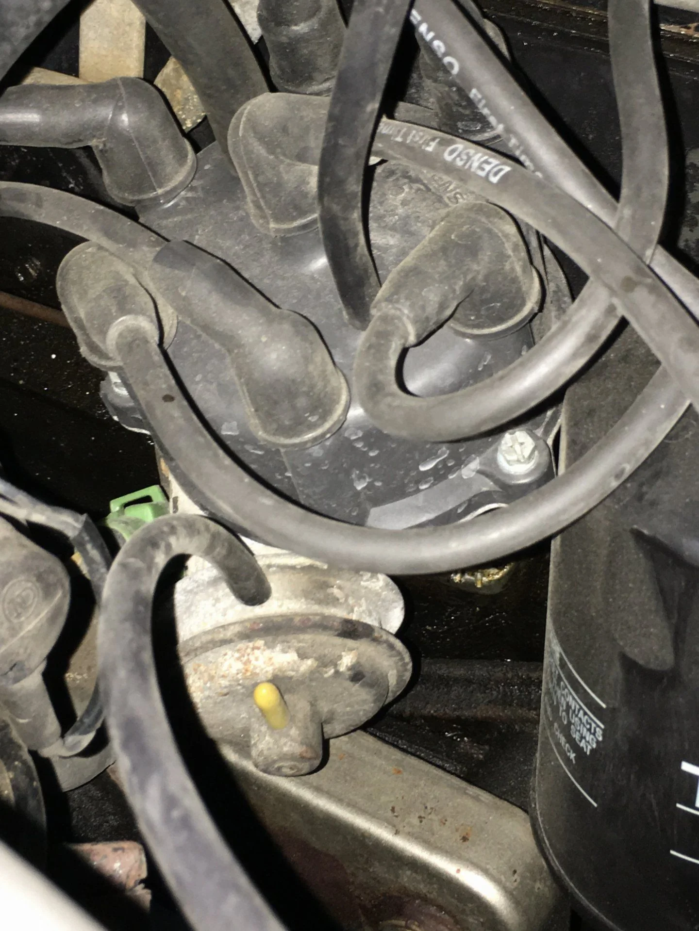

I tested this and it works
This is hooked up. I am pulling vacuum from the forward manifold (one of 3 ports)

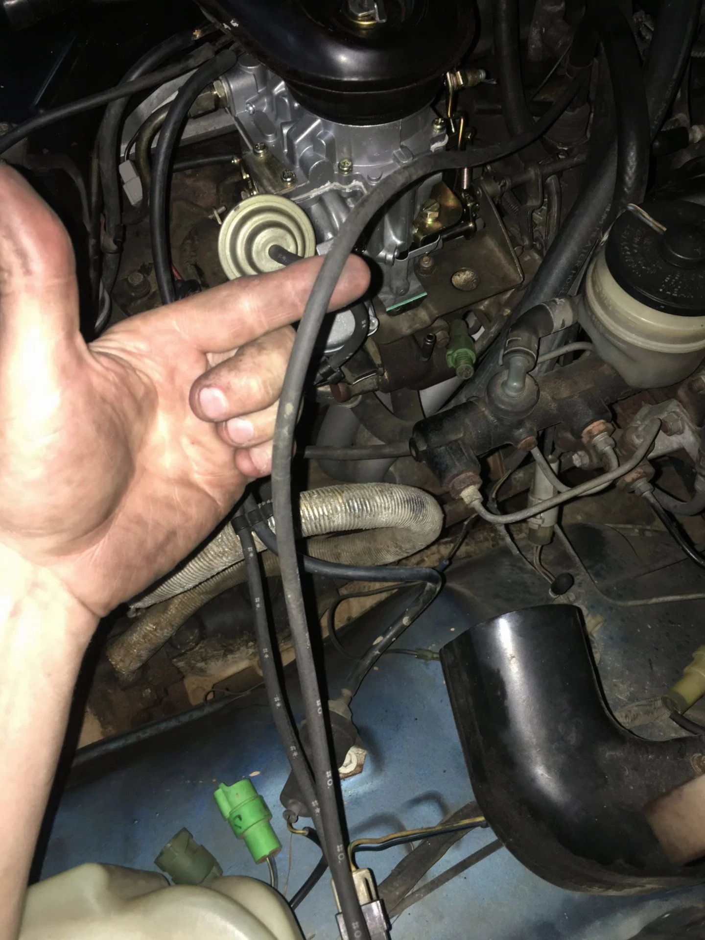

I ran this to the air cleaner (one of 3)
PCV is all OEM
Both Charcoal canister hoses are capped.
Thoughts?
Just guessing here, and it may be the pix, but it looks like you've got the ICS hooked up to the WHITE wire side of the harness? Should be the Green, 12V+ side.

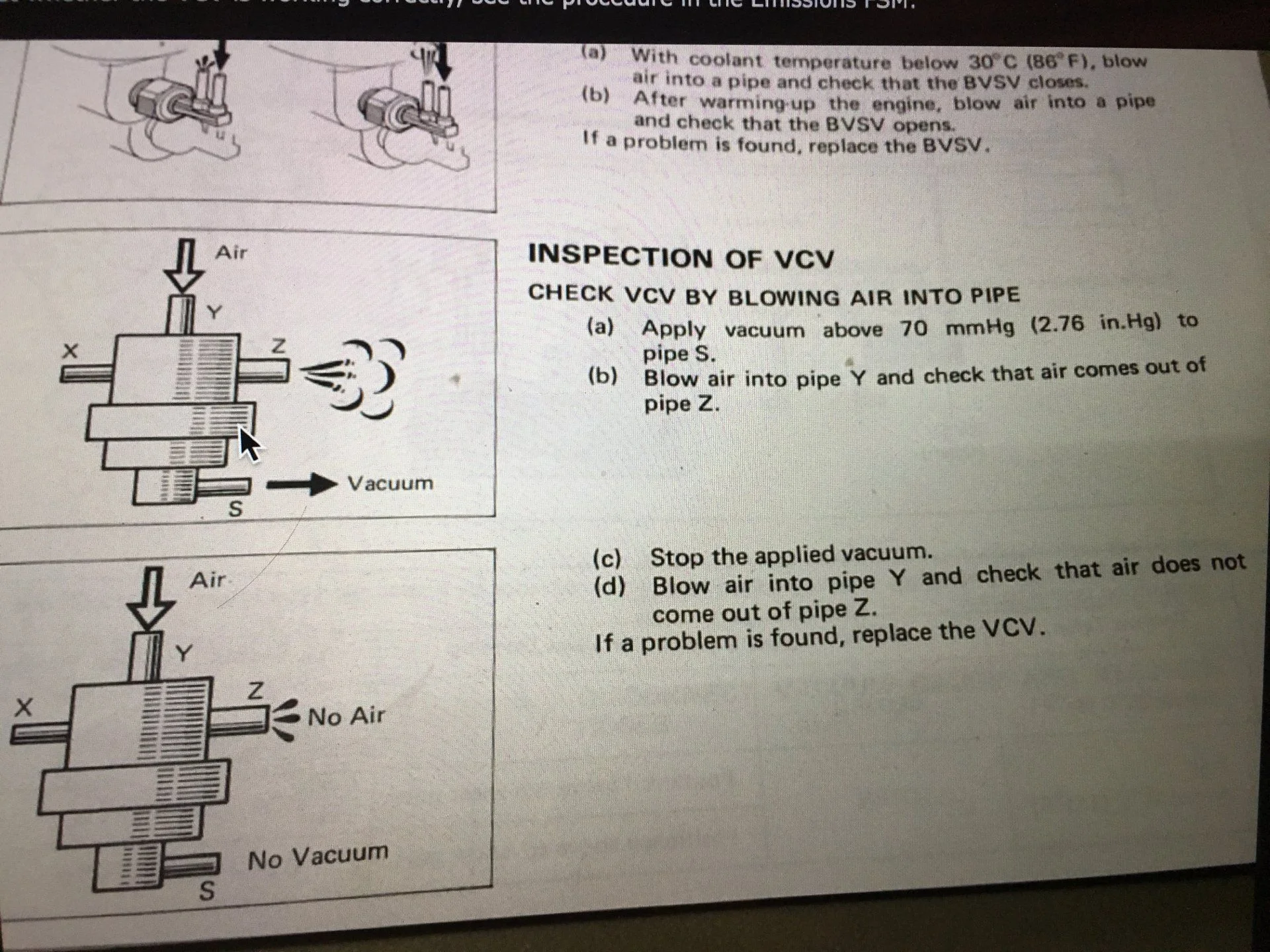

Why do I need the VCV?
Where can I run this vacuum sucking fool? Charcoal?

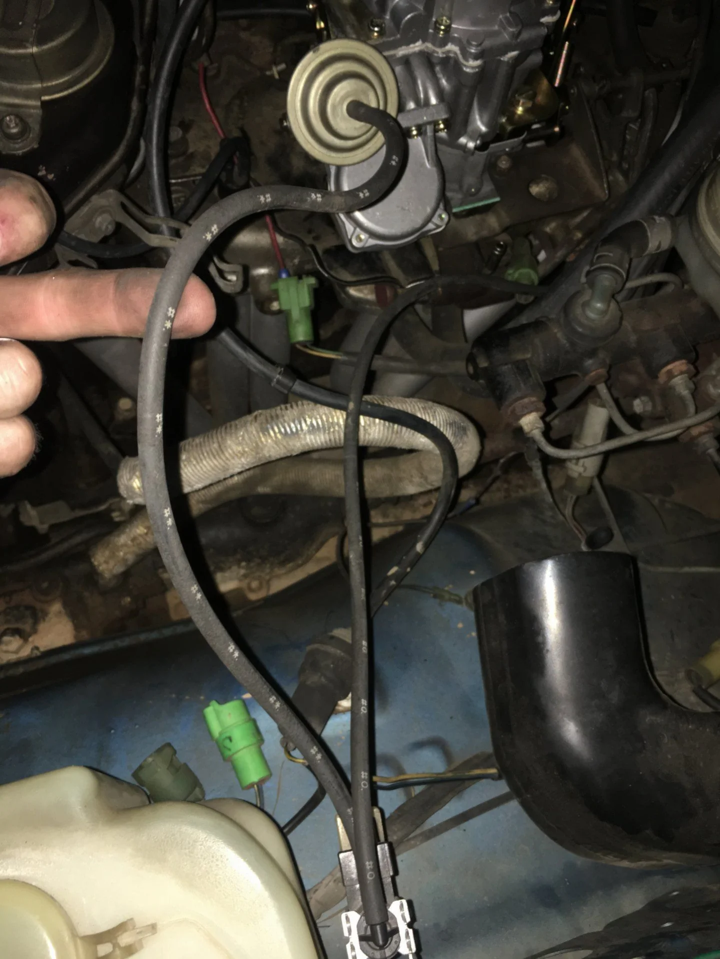

Can I put it to the Charcoal canister tube coming out of the firewall? The large bore near the manifold inside the booster?
I can take some pics of how mine is blocked off and working.
I only have the distributor vcv and ac idle up hooked up.
Watching this , my city racer carb runs great but I may have gotten lucky on the plumbing . Hoping to learn
Is your carb spacer vacuum port blocked?
Intake elbow is plugged, vcv goes directly to gas Filter with three prongs on the intake, distributor goes from the one port on the carb directly to the inner pod on the advance pod.
