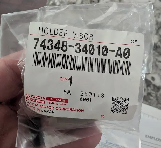

1- the visor clip was broke, so I had ordered a couple of new ones. The Toyota part number was close to 33% cheaper than the Lexus one. So if anyone needs some tan/ivory window visor clips, here's the part number:

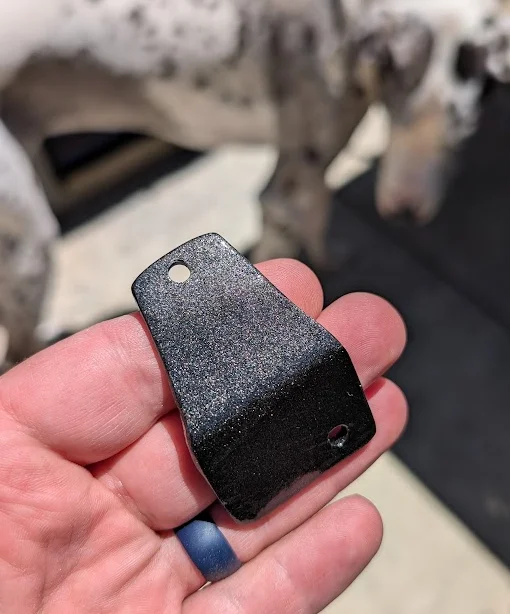

SG bracket trimmed and painted

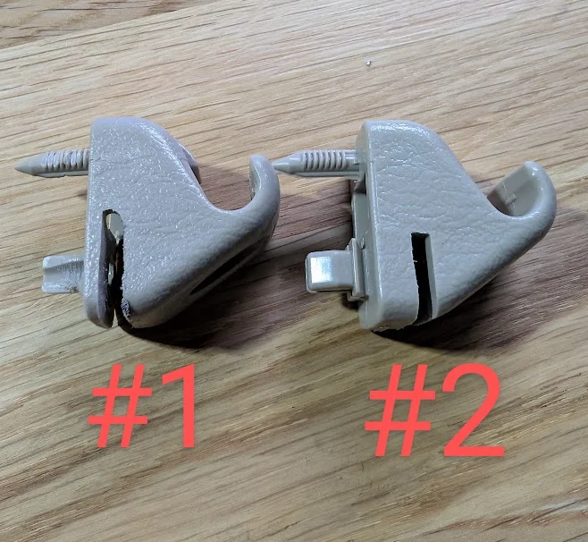

Tweaked my cut on the visor clip. Original test vs final
Since I made the slit cut further back, I need a slightly longer bolt - but had plenty out in the garage with the same thread pitch.

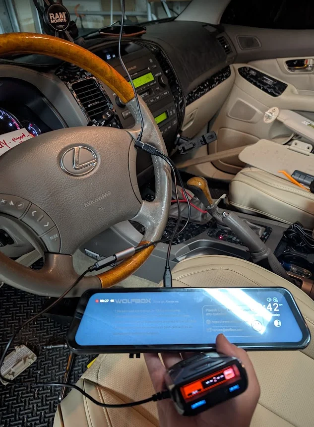

I was also waiting on another cable from Amazon. I have a radar detector that is powered by an in-line adapter to the OEM rearview mirror. I am getting rid of the OEM mirror since I bought the Wolfbox mount kit. This way you dont have to strap the WB to the OEM making it much slimmer and a cleaner install IMO.

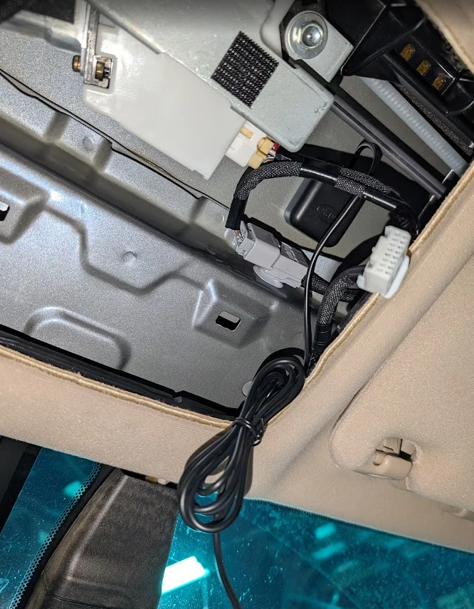

Ran the SG and WB wiring last night. Tested to make sure the Y splitter would power both the mirror and radar
Going to tuck all the extra wiring up behind the sunglass holder. Hoping to make some good progress on finishing the mirror and running the rear cam today if work is slow.
Some progress thus far today.

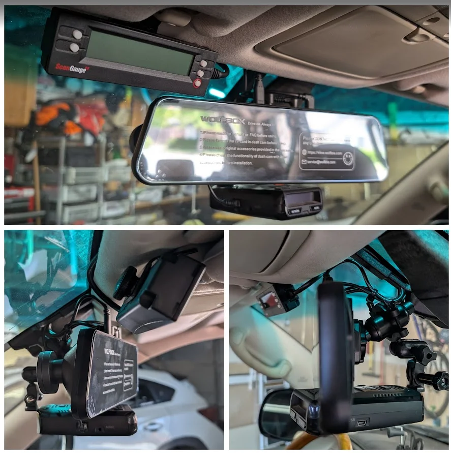

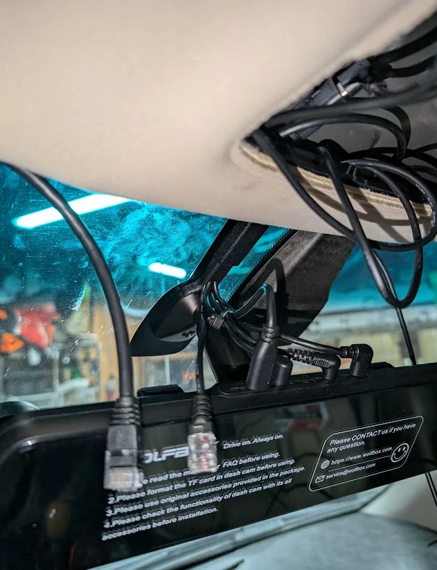

Stuck the GPS for the mirror to the underside of the roof. Figure if the heat kills the tape, it will just fall into the headliner and doubt that would make a rattle/noise.
WB Mirror mounted to the glass and all cables ran (plus the ethernet [far left] for the Scanguage power/data)
-mirror power
-radar power
-rear cam
-aux cam
-gps
It was a tight fit, but all five cables fit into the OEM black trim that goes from the mirror mount up into the headliner.
Tested everything (including the two cameras) and everything powered up.
Got the drivers side headliner all buttoned up. About to start on the passenger side to run the rear camera to the rear door.
I didnt/dont really have any plans for the additional front cam, but figured I might as well run the wire now while im in there. Ill probably just bundle the rest of the harness up into the glove box area. Then if I ever decide I want to use it, I can run the wire where I need to and the hardest part with the A-pillars and headliner is already done.

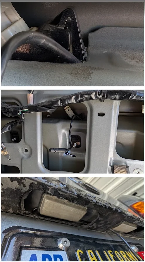

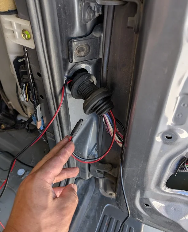

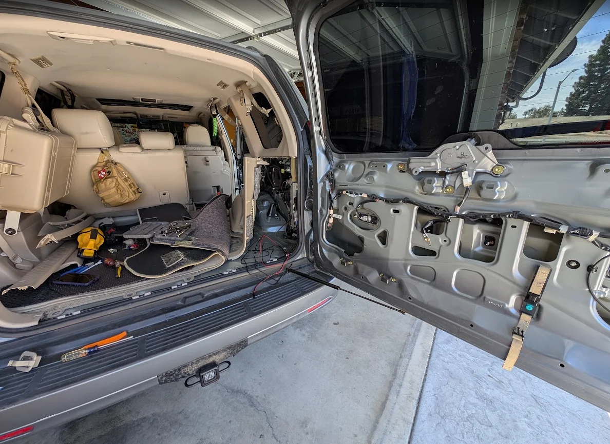

The two hardest parts of the install were A) feeding the rear cam wire through the gromet to the rear door 2) screwing the tiny screws from the cam bracket to the license plate bracket lol.

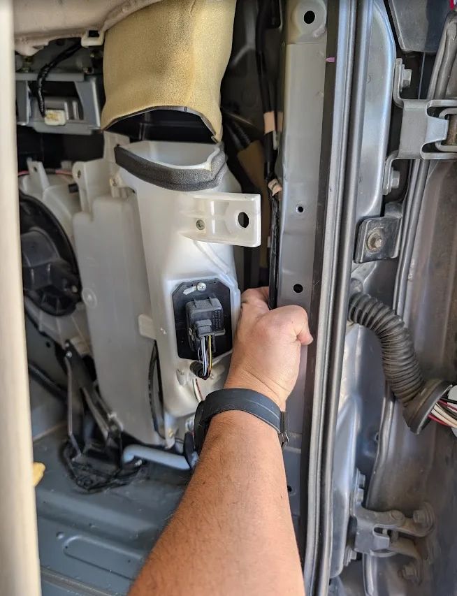

First time getting in behind the rear trim where the rear AC stuff is.
I decided to mount the rear cam with the license plate bracket vs screwing it into the plastic trim on the inside. I did something similar in the Trek, and found when the dogs are back there.. they hit/bump the cam and makes it useless for recording.
Popped the drivers license plate light out, and pulled the wire up under it.

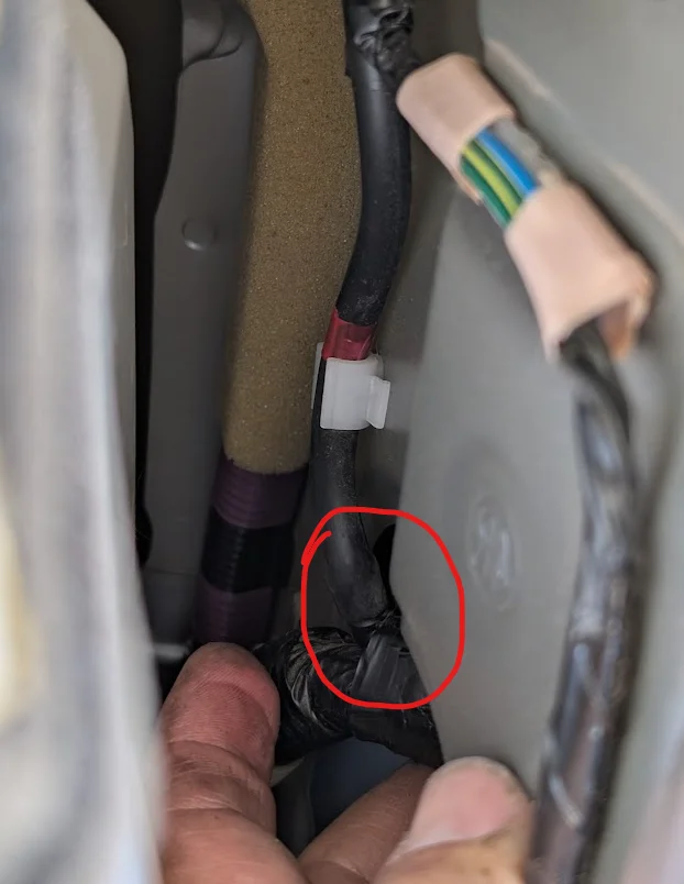

When I was fishing the cam wire through the gromet, I pulled on the harness a tad bit too much.. all of the sudden I had a lot of slack. Well, it was the rear wiper fluid connection.. fudge. So I had to pull the AC stuff out as best i could to reconnect it. Got super luck I noticed... Otherwise next time I tried to use the rear fluid, nothing would have come out on the window and would have started filling up behind the trim
Where my pointer finger is on, is the connector

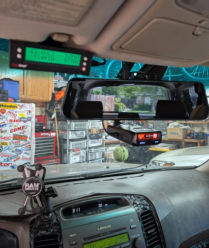

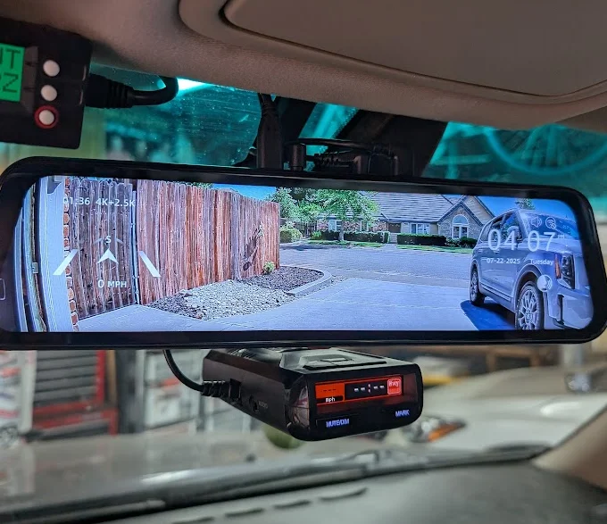

Normal mirror use
rear cam in use
Everything done!
Officially **** that rear grommet. I fought with it for a long time on my 460. Hopefully it was easier on your 470.

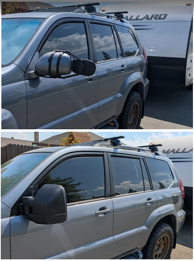

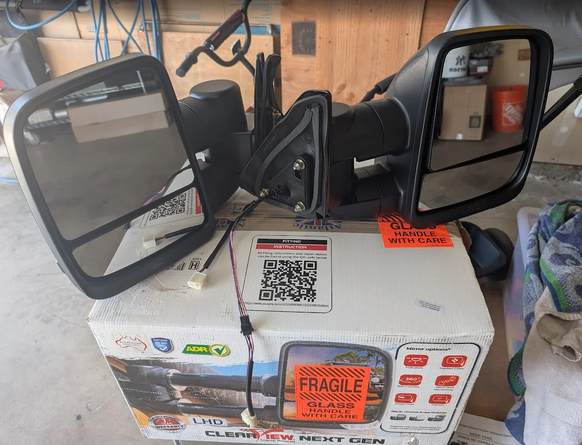

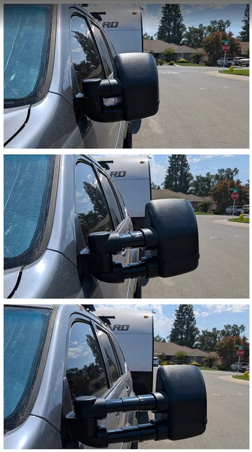

Well I had been emailing a sales rep for Clearview (towing mirrors) about the 470. They have mirrors lists for 460, and LX470, but nothing for the GX470. He said they have done them in the past and would inquire more. Well yesterday he said they had one in stock. I said too bad it wasnt a bit sooner and I could have gotten them installed for our trip this weekend. He said they could overnight the mirrors - I said it would more than likely be too expensive (it was, ended up being a bit over $200... nope).
They should be here next Tues. Not the exact style I would have preferred, but as long as they would, it should be better than the cheapy strap on extension mirrors from Amazon.
Clearview had them for the Prado 120 in Australia awhile ago. I also tried to buy them but they were expensive. I think close to $700 with shipping. There is multiple companies making them for the Prado 120 . Not sure if they will be plug and play but should bolt on. Really interested to see how yours turn out.
Yeah, they were expensive.. after tax/shipping they were $661.
I did contact another company that made them for the Prado, but they were all for right hand drive.. and the mirrors wouldnt be the best for here using LHD :(
1st gen Tundra mirror extensions will fit a GX470, with some heat gun modification, and with the installation of a jacknut in the mirror housing. They are made by Longview and were around $75. About 5 minutes to remove and install them. I've probably towed around 10K miled with them on.
Interesting! I probably would have tried doing that before buying since they're almost 1/10th the price lol.. Ill give the new ones a shot and see how they do, should arrive today (though not sure when ill have time to play with them lol).
Wow! Very nice. Plug and play?
Kinda basically... lol
They are plug and play for the mirror adjustment, but they dont have built in turn signals, heaters (defrosters) or auto-dimming. So you can potentially loose some functions, but as long as the mirrors were adjustable, I didnt mind.

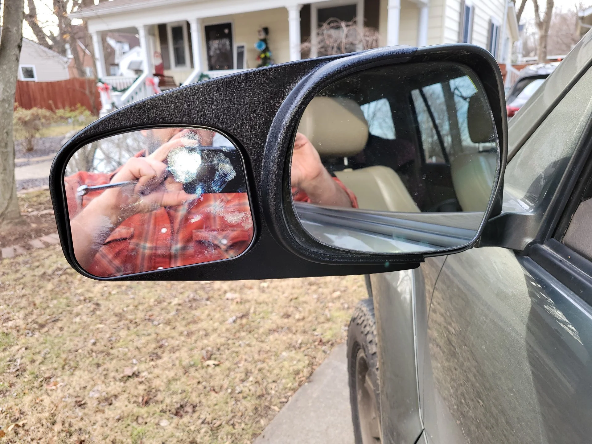

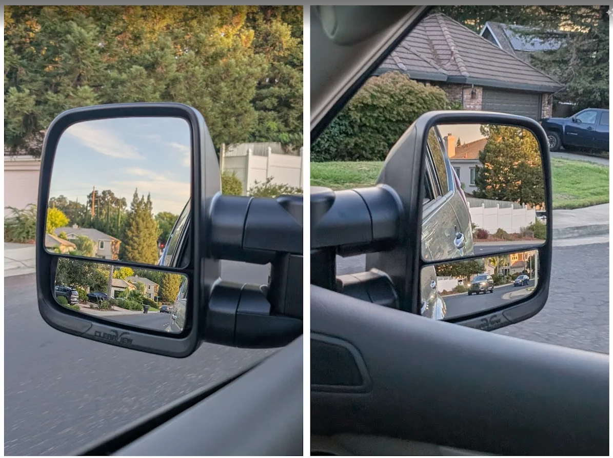

Dropped the trailer off tonight for a warranty repair tomorrow morning (shower knob leak). View from the mirrors
Will take a little getting used to.

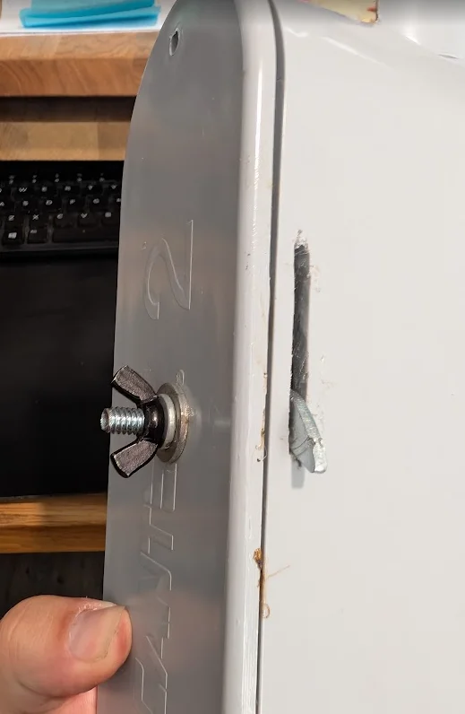

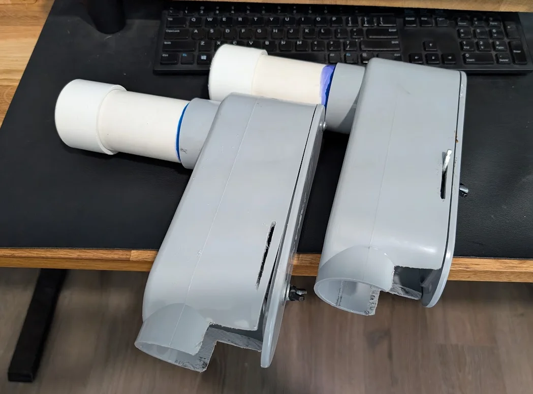

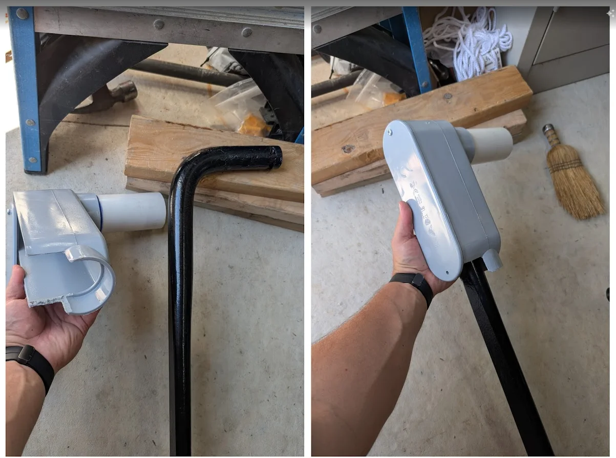

Also, since the RV/trailer lot is super close, I didnt bother hooking up the WDH. So I finally got around to a small side project for the bars.. I was tired of getting grease on my hands or inside the trailer storage. So, got a couple 2" electric LBs, and modified them:
Will probably put a cap on the end to prevent grease dripping out over time, or just dust/junk getting inside and making the grease dirty.
Then I'll probably make some type of latch to keep the lid closed on the cut end of the box.

Finished up the WDH storage on my lunch break today.
-added 2" caps
-made a latching system from scrap crap in the garage lol

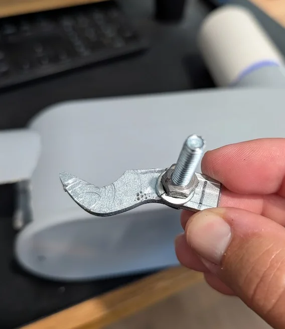

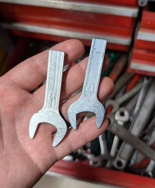

I always keep cheap "tools" from patio furniture/ikea stuff.. never know when you can "modify" them to work.
As in, a couple wrenches that I cut off one end, and one side (could have used both ends of one wrench, but then they would be different sizes and my OCD wouldnt let that happen, even tho you will NEVER see the numbers lol):
bolt with a lock washer and nut so the "wrench" end doesnt spin when not wanted.
Cut a slit in the side of the LB, drilled a hole in the lid for a pivot point. Washer, lock washer, wing nut to move/secure the lid down
in action
double the fun
