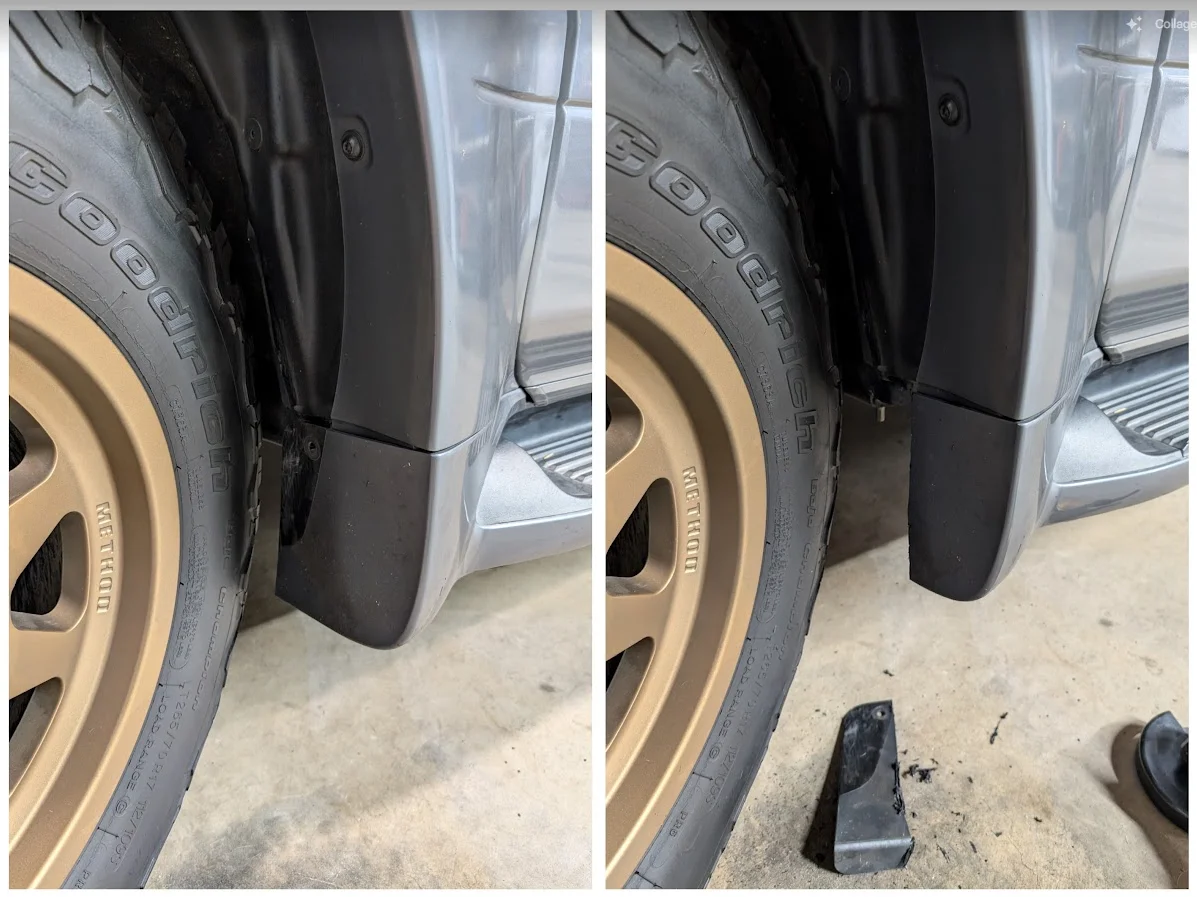

Finally got tired of the slightly larger tires catching and rubbing on the side skirts in the fender well. It's done it since the day I swapped wheels/tires, but only on the drivers side for some reason..
Heading to the cabin for a work weekend around the place. Figured I snip some plastic off before leaving so I dont have to hear it when making hard left turns lol

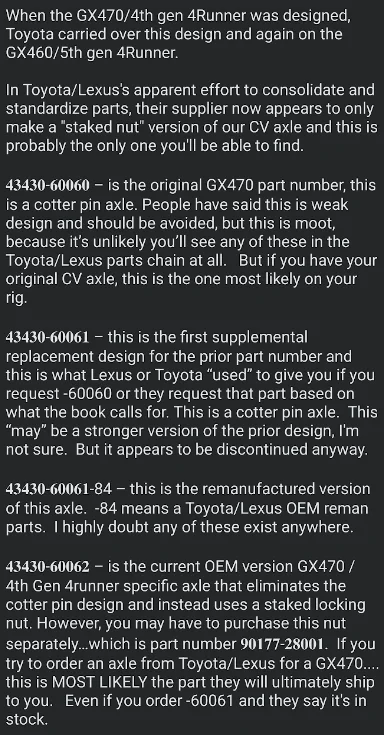

Planning on replacing both front CVs. After searching the FB group, looks like the way to go would be 460 axles. They changed them from the cotter pin to stake nut, so would need to buy two nuts as well.
460 CV #: 4343060083 - current sale price from Bell Lexus = $313.77
460 nut #: 9017828002 - current sale price from the same = $2.58
obviously would need x2 for both sides. Ive read so many pro/con on aftermarket with "they are amazing" to "will never buy again"... Since my suspension is stock, and might do a 2-3 inch lift in the coming years, guessing OEM is best and the 460 is a slight upgrade over the 470.
Anyone know of any better sales currently? Anything else I should do while Im there?
FYI, the 470 CVs are actually just fine in my experience. I rebooted mine with All-Pro high angle boots in 2022 and they have worked well without any rips or issues. The boot kit was around $125 for both sides from Summit Racing. I'm up nearly 3" in the front and wheel my rig regularly.
Pretty much any other mass-market aftermarket boot will rip on a lifted rig. I think the true OEM boots will do a bit better than a generic boot, as they are a better material, but they are still running outside of their design when the rig is listed and will probably be prone to ripping. If you aren't lifted they will probably last 100K or more without ripping.
I think, from what Im remembering, the new 470 are actually more expensive right now. From the sale dealer as my price quotes above, the OEM 470 (# 4343060062) is currently $406.90

One of the axles I rebooted was my torn-boot OEM axle. Upon disassembly, it was totally fine (no grit in the bearings etc), so it has worked out well with a simple reboot despite having near 200K on it. I think the Toyota CVs are pretty robust and tolerate being driven with a torn boot better than any other vehicle I've ever driven.
Another option would be to get a set of NAPA/Cardone reman OEM CVs - for a 460/5th gen 4Runner - and send your 470 axles back as the core return. They are all of $86 on Rock Auto right now. They'll be a bit more at NAPA but they'll have better warranty support, and you can open the box to verify it's a true OEM axle before actually buying it. Since you are not lifted, the aftermarket neoprene boot should last at least a couple years. When they rip - or when you lift - you can re-boot them with aftermarket high-angle boots. Rebooting is easy enough that I'll never go back to complete axles.
All the "reman" axles are anyway is a disassembly, clean, and re-boot with new grease and a new axle nut. Considering they do them in Mexico with low-cost labor, it's pretty easy to see how they are done so cheaply.

Well, now im rethinking and maybe just go with the NAPA/Cardone route lol.
With only a less than $4 core charge... it would be worth just keeping my current ones and rebooting for future "if need be".
The $170 vs $630 OEM is really tempting too lol..
Guess it comes down to if I wanna do the job again in a few years haha.

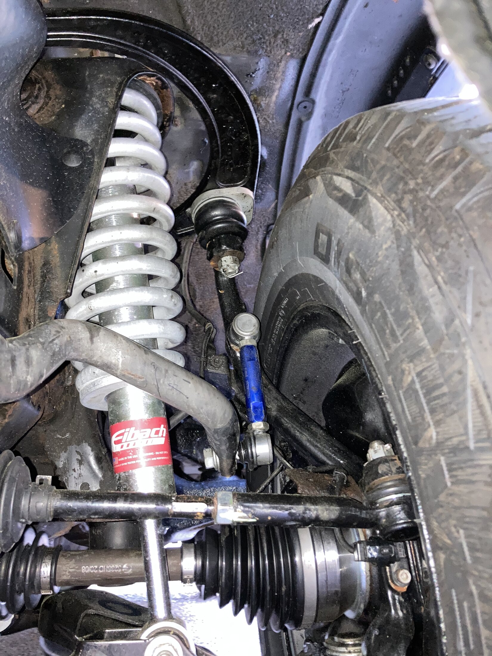

Installed Napa CV axles around May, 2021. No issues or complaints. Unlike the superpro end links in the picture which were trash and the Spc uca which needed new ball joints even though I greased em properly…
