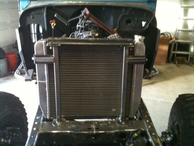

Just fixed the ORIGINAL design that I said I was scrapping.
Just DID NOT wanna start ALL OVER. For some reason though, this rad. thing is making MORE PARANOID than anything else as it seems to be such a delicate component...
Lemme know any thoughts or if any of you see anything GLARINGLY WRONG with the design.
Yes...the mech. fan does fit and I can take it on and off without removing the rad.
Its CLAMPED DOWN in this contraption and its really solid, but Im still gonna do a wrap around from the front to back and run an additional support to the frame as discussed earlier which will also keep it from vibrating horizontally.

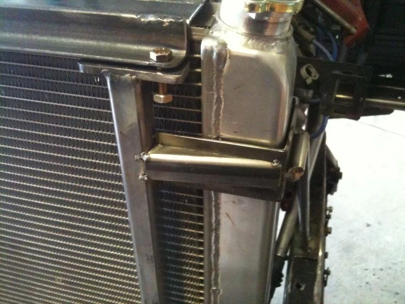

I did! Ill spin my wheels for a month re doing this piece so I finished it...well..its tacked into its final state. I was concerned with the clamping on the CORE. I backed the tension off a bit so its clamping on the rubber blocks and added a "reach around" (:D)
to tie to the frame.

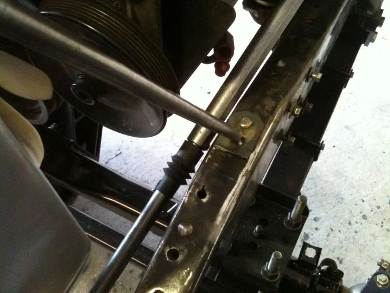

Unless I'm missing something, are the 2 bolts on the front side of the radiator the only mount point to the frame?
Jim...
NOPE. I cut apart the factory rad. mounts, and welded a flat piece of steel to the inner face of the front cross member and then welded the factory mounts back on....then bolted the mount to that. The fore bolts you see in the pic are just additional. I welded some grade 8 nuts into the frame so I wont have to worry about blind capture of the nut.

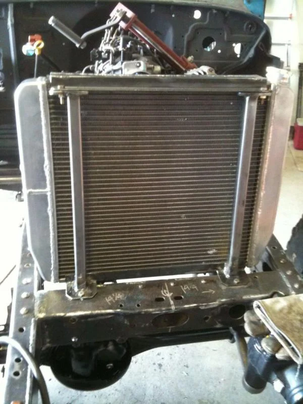

BTW...here are the pics of the tacked in FINISH!
PLEASED!!!!:D Again.. the interior of the mount will get a healthy coat of bed liner for additional protection.
Its SOLID!

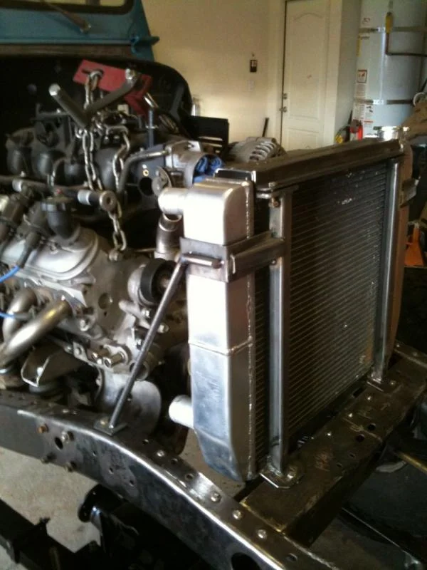

couple more!
Sick!! Should be overkill, which is exactly what you want:D
