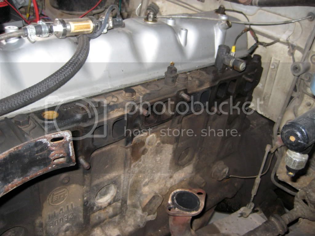

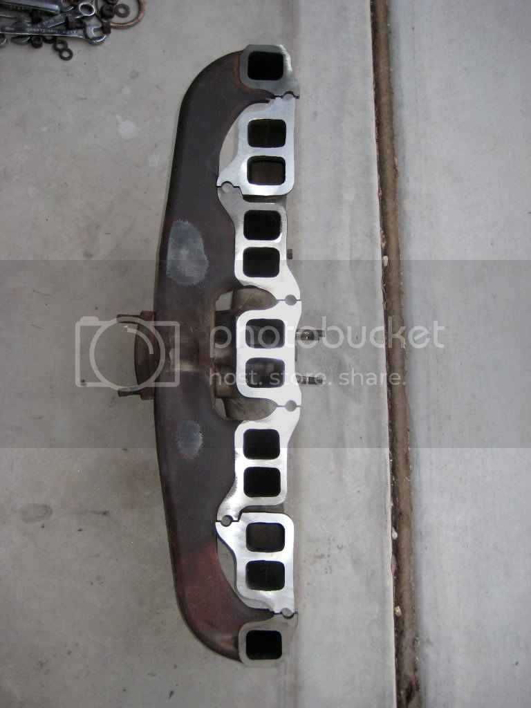

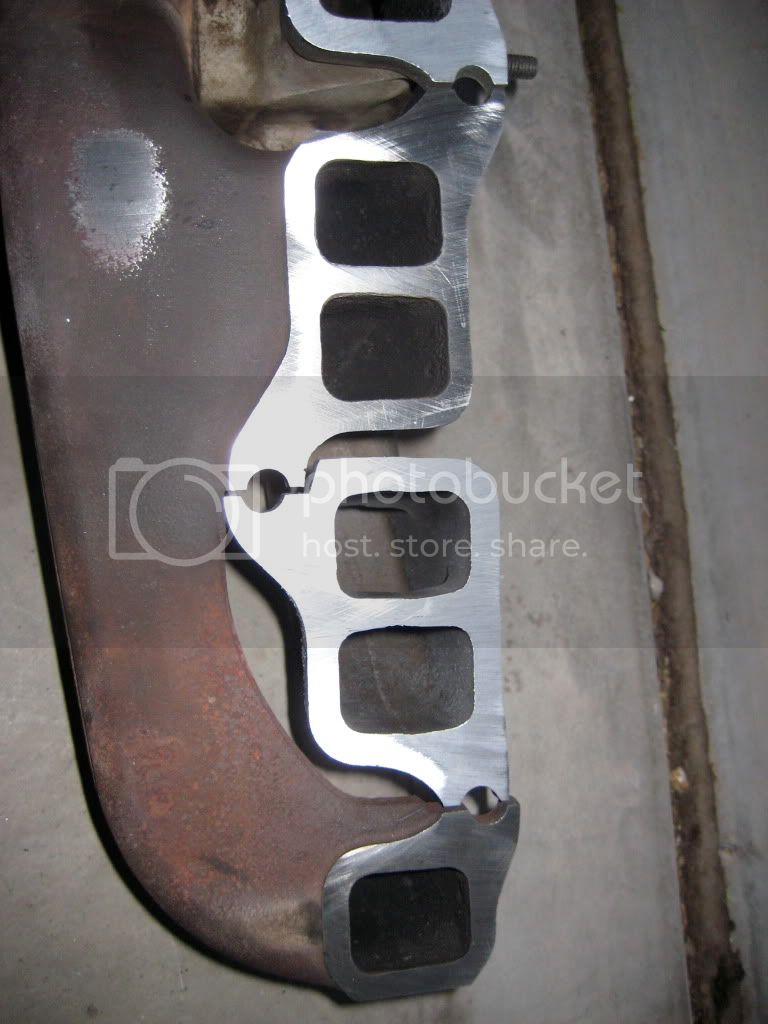

Some pictures,
Is it normal for the intake and exhaust holes to line up so bad?
Anything special I should do to motor before putting it all back on?
Why do they come with 2? I'm going to use the remflex gasket I have coming but wasn't sure about the 2 little ones.
Generally they come with 2 of the 2F 5 hole gaskets(needed with 2F style manifold) and none of the F three hole gaskets... only need one.
Yes, the one piece exhaust manifolds bow over the years. Clean up the hole openings to fit the F studs with a little sanding drum on a dremel. works well, did mine yesterday.
Did you spot face the surface on the other side of the manifold where the washer torque down the manifold to the head? Its worth the trouble if they are even a few thousandths out. Even clamping load = happy gaskets.
They give you two of the little gaskets that go between the intake and exhaust because there is a steel plate that gets sandwiched btwn the two gaskets.
It is a deflector that shields the bottom of the intake from exhaust gasses.
That is the case on a 2F manifold, no deflector thingy on F manifold so only one gasket.
