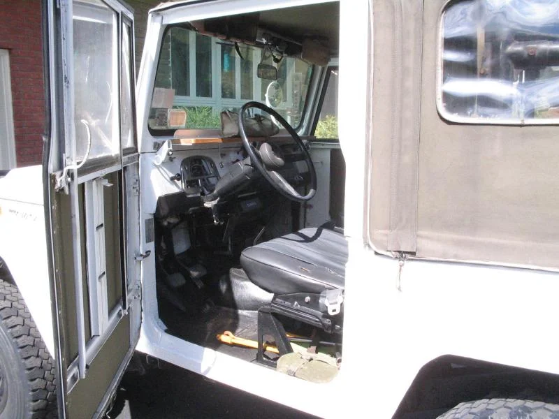

From what I see... ( five minutes before I goto bed lol) the engine is a 1973 or earlier engine... The 74 is what we call the 'F and a half' engine that has the oiling system of the 2f but still is an F sometimes called the F.5 or 1F.5 or 1.5F ... The engine in this cruiser has the oil filter at the intake ... So not a 74 engine
The tub is not a FST it was made into a FST ... The I'd plate probably will show it's an fj40lv
The oem soft doors are missing the window regulator that holds the window clip to raise and lower the window
Missing soft door springs to hold latch closed
Missing oem interior FST done light ( Darth Vader helmet)
Missing oem FST door eyelets for safety strap
Missing windshield wiper spray piping
The oem top is a Pakistan replacement ... Not the best quality... But not all that bad either
Bows and tailgate maybe Pakistan as well... Which makes one wonder if there is much bondo in the back when converted to tailgate from barn doors... But... Could have been done well ... Just can't tell
Newer style seats ... They put the front bucket seat rear brackets in sideways
Missing oem center console
Covered over seat backs however... It doesn't look all that bad
Missing cigarette lighter
Exhaust coming out the back youll have lots of fumes inside with the rear curtin up
Something's are painted the wrong color... However the blk on white is still done nicely and looks great
I went for a second look at the tub... It does have the hole for the interior dome light ... But missing the hole for the eyelets... They could be just filled in you can see a dimple were they would go
Definitely Pakistan bows IMO
Overall it is a good looking truck

the answer to rust is lots of work... this truck doesnt take alot of work... the things i pointed out are small... can be found or corrected or just lived with.
the springs for the oem soft door are still available from toyota BTW

ask for a picture of the door plate.... that will tell us if it was originally a hardtop or not
FJ40LV V=Van L=Left hand drive
everything is somewhat small.... and can be found for not all that much $$$
... except for the window regulator and hand clip... they would be hard to find... IF you do get it... I could fab some hand window clips at some point.... heres a pic of one i made in the past (oem on left) ... also a pic of the regulator and clip on my door
