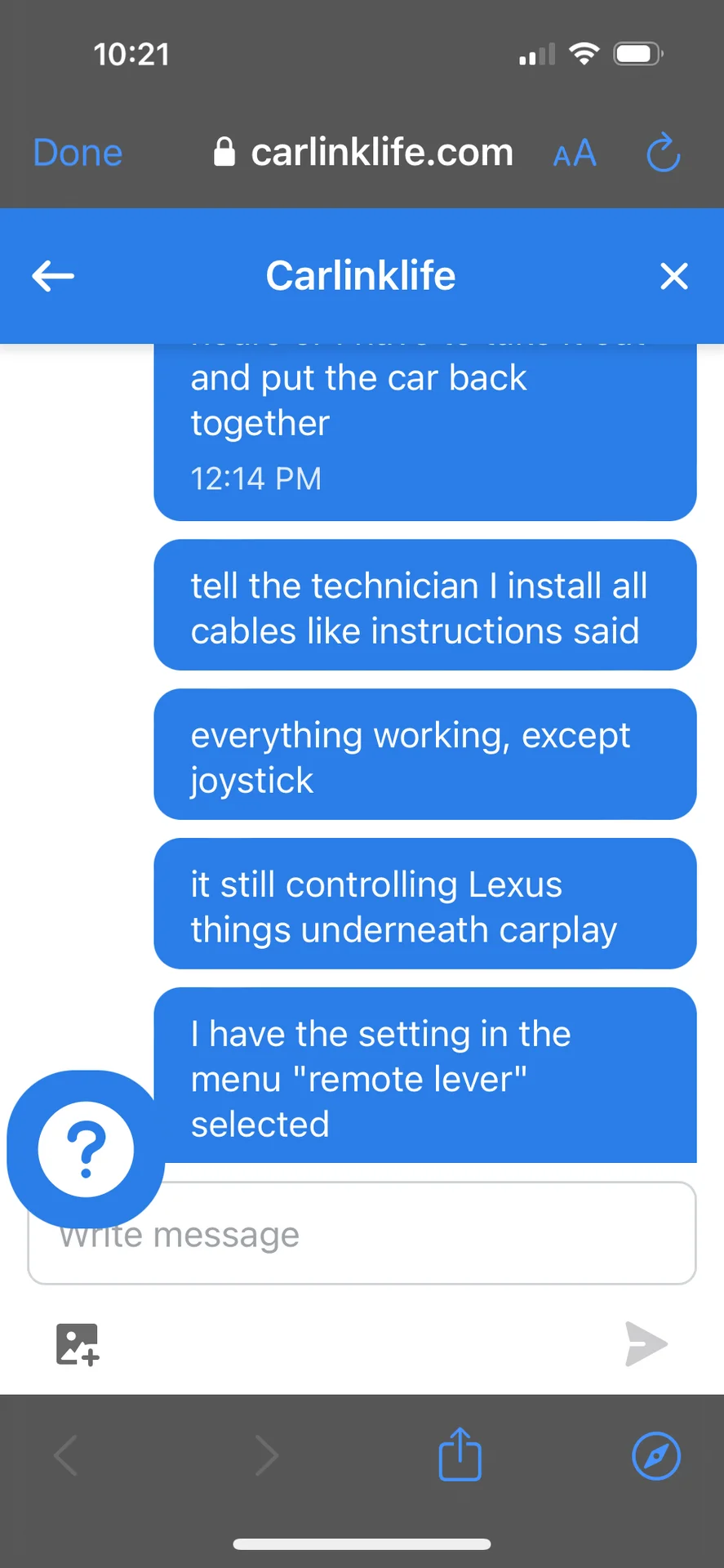

I just installed this including the joystick relay and this s*** is still controlling factory interface while inside CarPlay.
Anyone having the same issue? im on dip setting 0110000 and video is fine, no overscan / under scan or flickering.
The issue is strictly with the joystick and controls.
I ordered whatever Chinese trash was cheapest on blackfriday that didn't need an aux input (BT overlay).

The "support" now needs to reach out to the "technicians" and they are you guessed it, nowhere near a wester hemisphere time zone!!!

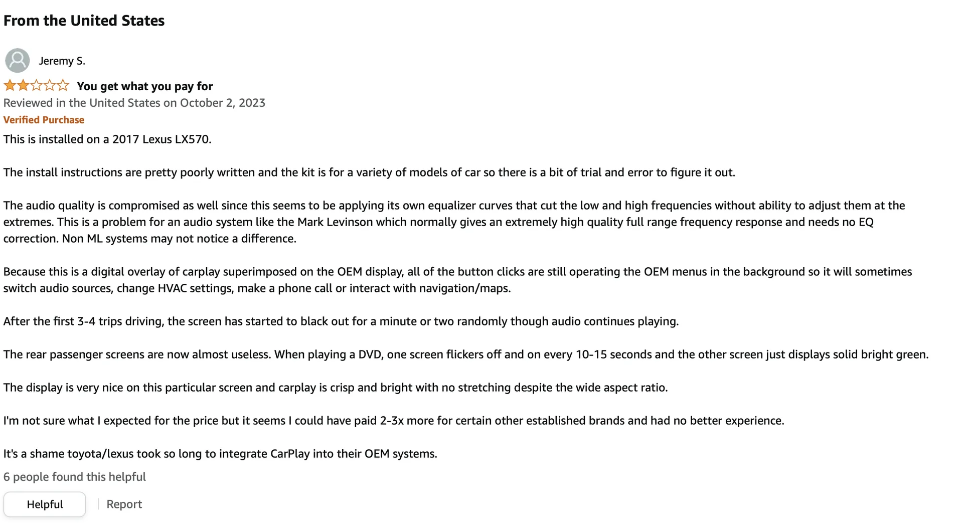

IDK who JEREMY S. is but he is correct. Except its 0 stars instead of 2.
Taking this crap out before it burns up the electronics in my $100k truck with screen and radios in the thousands to replace.

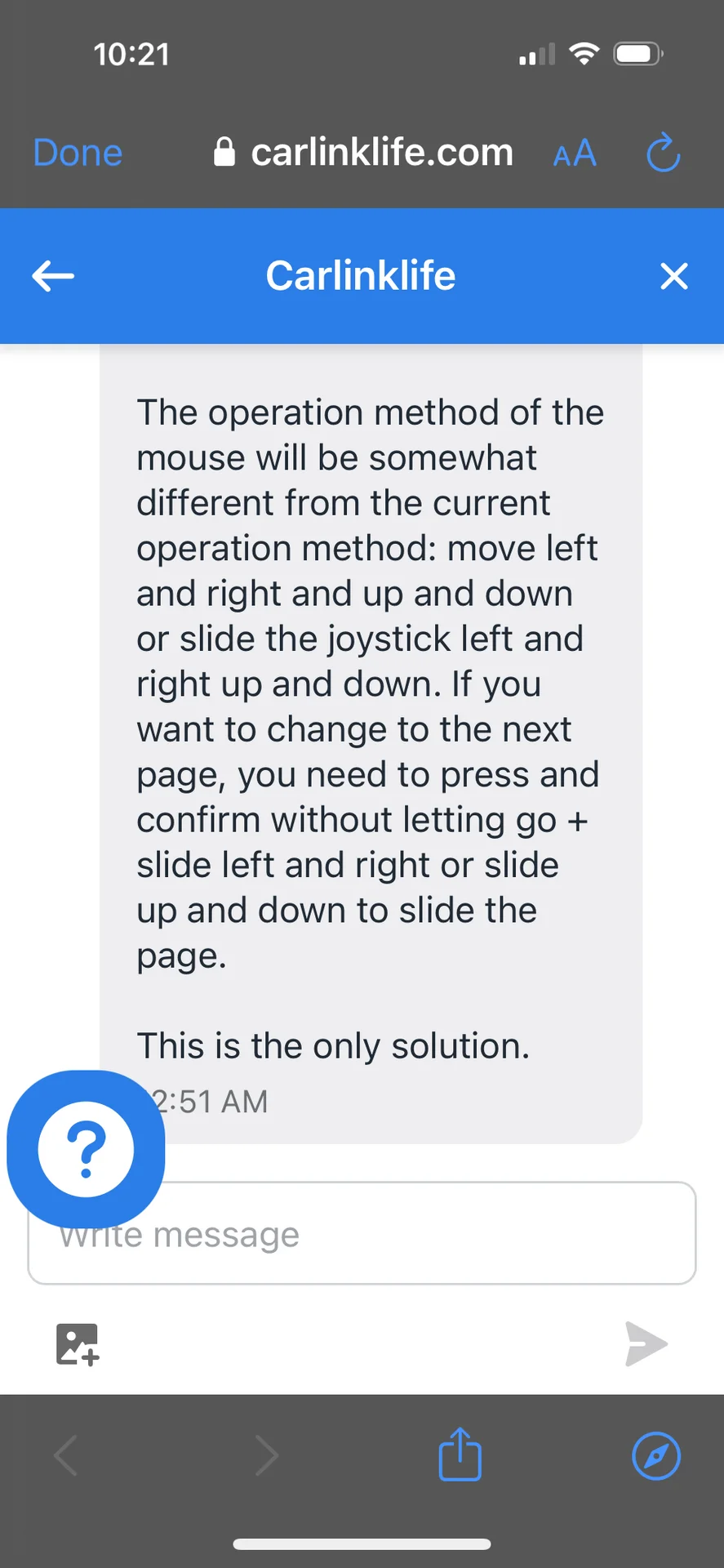

I spent a day or two back and forth with the support staff here is their response, and also, this is the exact same device @NKP Garage is saying does not toggle his AC or call ppl in background.
One other poster in that thread said their experience was like mine and similarly was told it was normal behavior.
@nkpgarage please check that your oem menu selection confirmation sound setting is turned on because I could clearly hear it happening too. (Bong bong bong)
So for this it looks like mouse mode needs to be done, but even if I can get this to work (still have the unit) I’m wondering what nkp unit is doing.
If you could kindly confirm the menu feedback noise is turned on in your car or not that would save me $700. Is yours in mouse mode cursor or tile selector mode?
But again, it seems like we are using the exact same units so I don’t have a clue why mine wouldn’t work except faulty unit or harness.

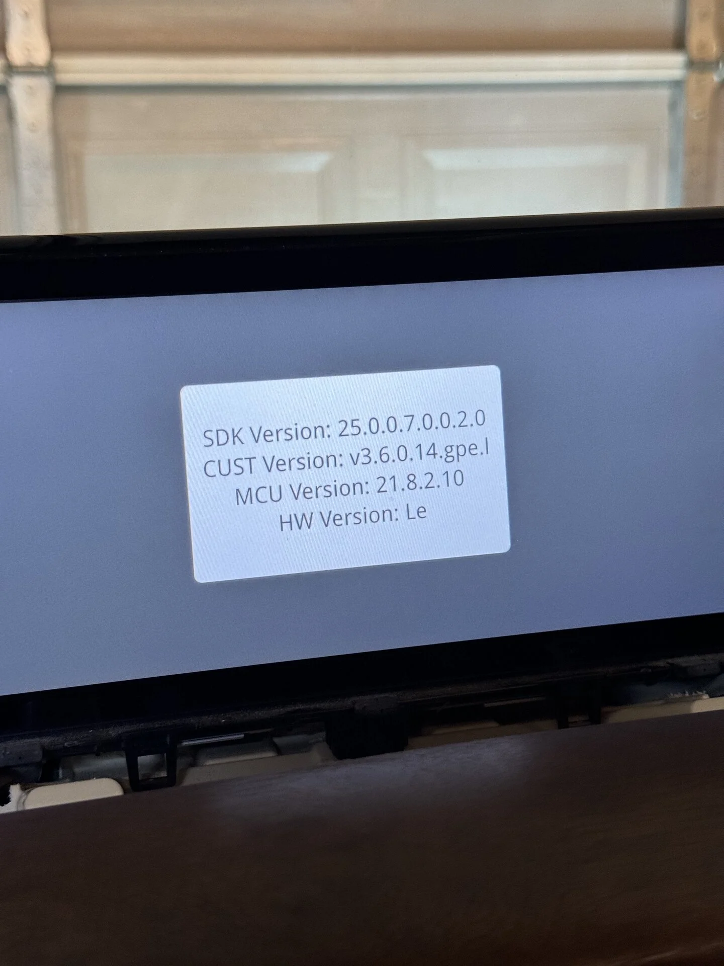

Here was the software in mine btw.

Good news is probably some of yall will just need to update your firmware.
I got the software update 👨‍💻
