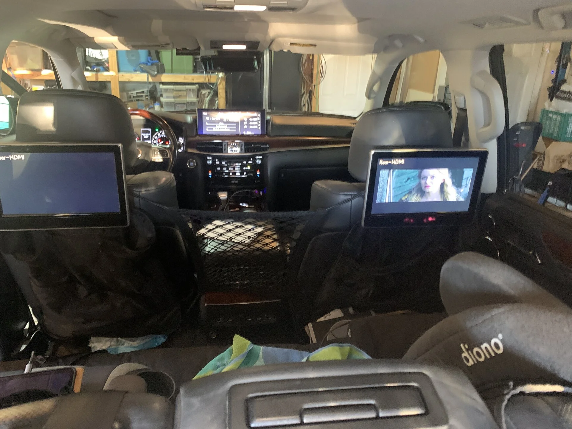

Further update. After having this for about a week, it does have a tendency to blank out the screen for a few minutes. You can get back to OEM screen normally with long press of map or menu buttons. It also makes the rear DVD screens unusable. One screen flickers and the other is solid bright green.

Dang. I wish I had the same experience. Losing the rear screens was the deal breaker for us.
I wonder if something is hooked up wrong. I just tried my rear screens while connected to CarPlay and it’s all working on ours.
I’ll double check the connections at the back of the head unit for something loose. It’s really not possible to plug things in the wrong place with all of the unique harness plugs and that I do get a flickering signal on one screen shows there is A connection. It might just be a POOR connection.
Well, I’ve definitely done something to my wiring. I removed the CarPlay unit and my drivers side rear screen is still not working right. I can see menu options and all that but just can’t get any video to show up, whether it’s DVD or HDMI as the source, the result is the same.
I put the CarPlay unit back in and will just keep audio on Bluetooth and I’m use the google maps (main reason for all this in the first place).

If all you touched is the wiring behind the head unit and behind the screen I would go through and check all of those. check the pins at the connectors to make sure nothing is bent or loose.
I thought I could live with just losing the left rear screen but yesterday's drive to grandma's had the main screen go black after 45 minutes and again on the drive home after 5 minutes. Can't have that. I pulled everything out and put it back to stock and now all of the screens work like properly. Whatever the cause for the bad screen was, I don't know. The unit itself dying in the middle of a drive is a whole different and unacceptable problem. It's good I bough on Amazon as today is my last day for a free return.
I'm jealous the rest of you haven't had the blacking out issue like me. Maybe I'll have better luck if I try a different unit sometime down the road.
I wonder if one of the cables was bad or something like that.
Do you have a walk-through you used to open up the center dash? We are having the same issue but our driver screen works and our passenger just shows the DVD menus so we think it's a wiring issue. Is there a guide to open up the center dash to check wiring?
